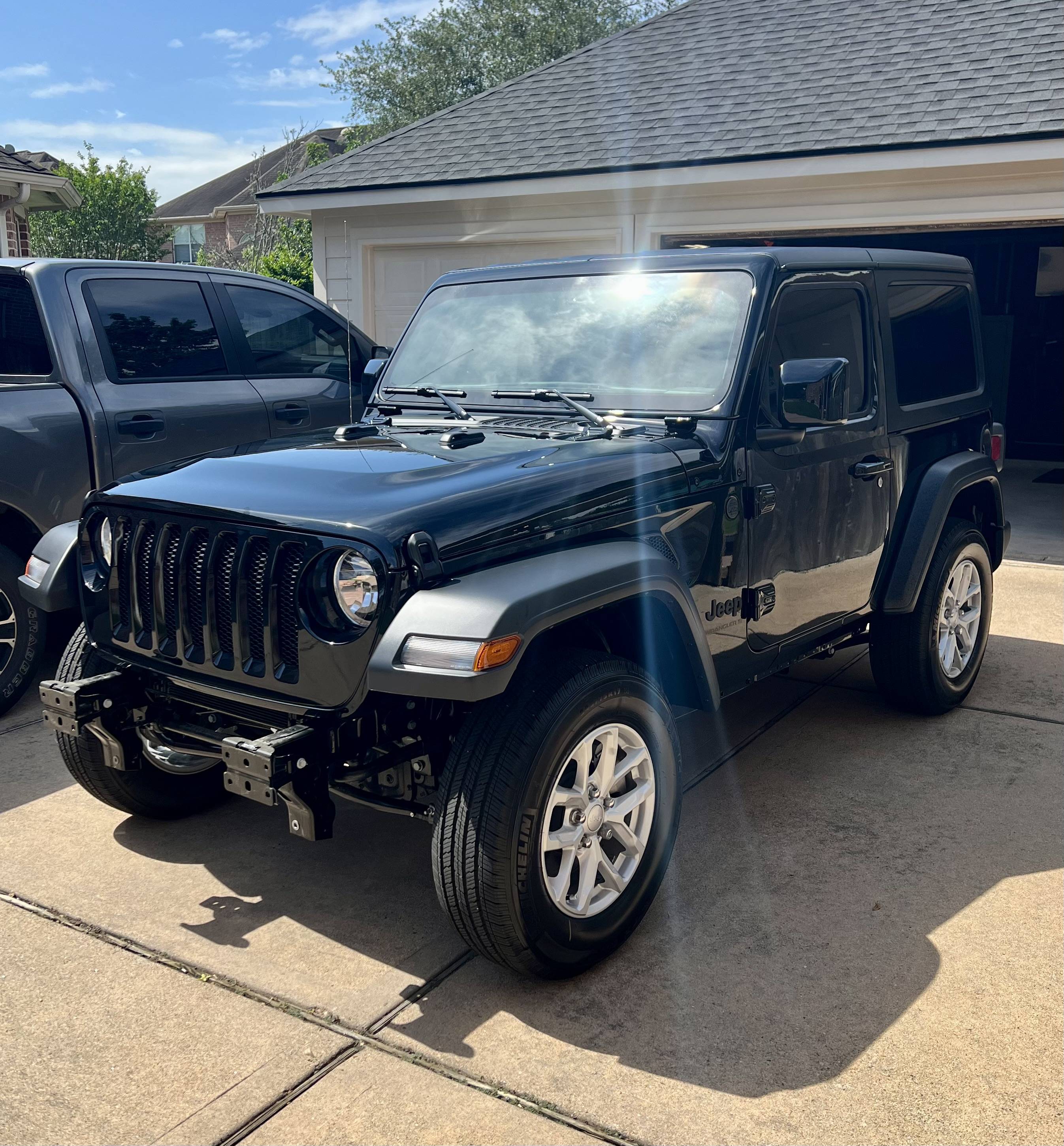

Appreciate the info fellas. Not 100% on the stubby rubicon, still looking at options.
I’ve had the jeep less than 48 hrs and the bumper is off and I have some scs wheels ordered lol. We modding ?
