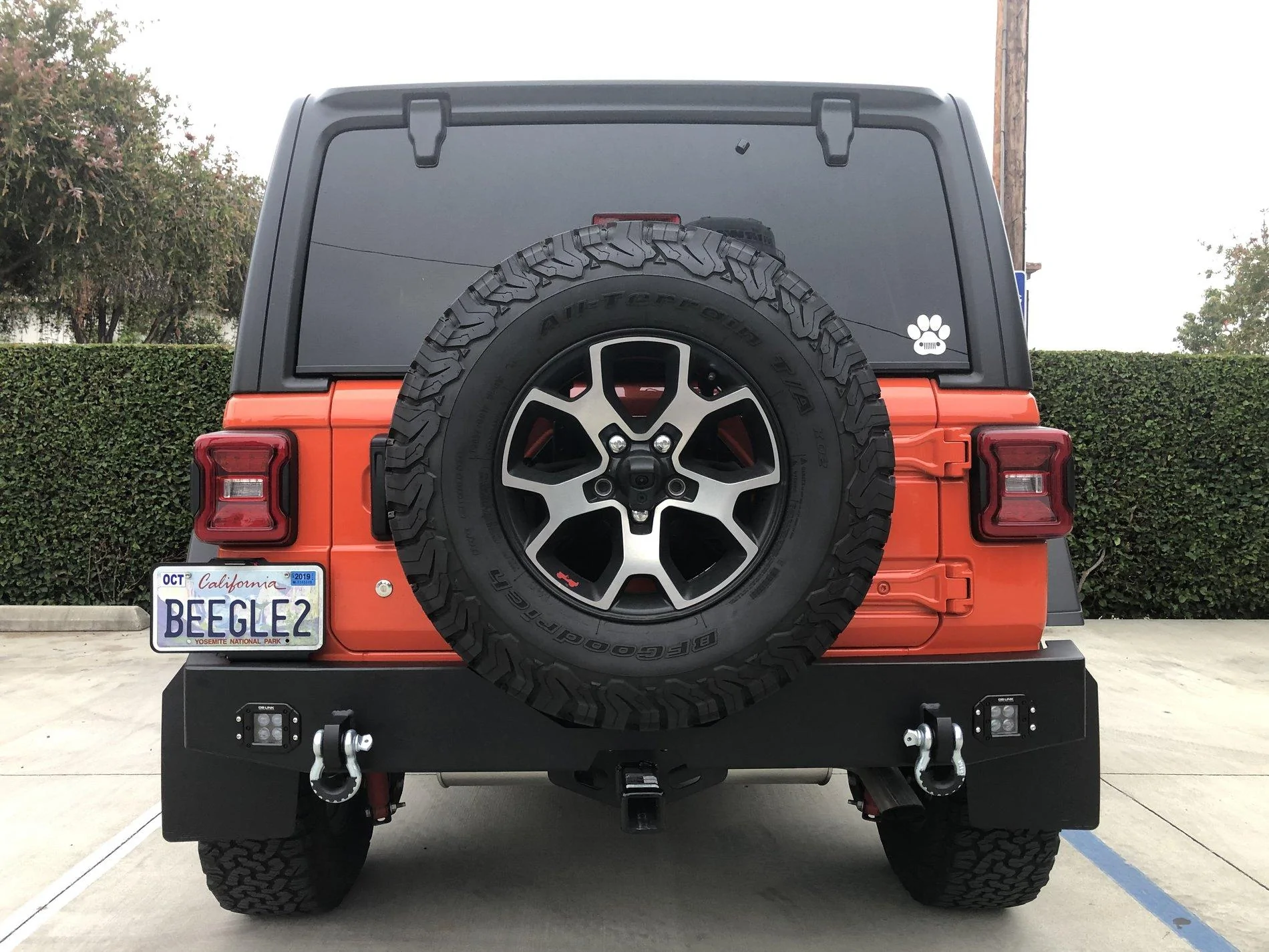

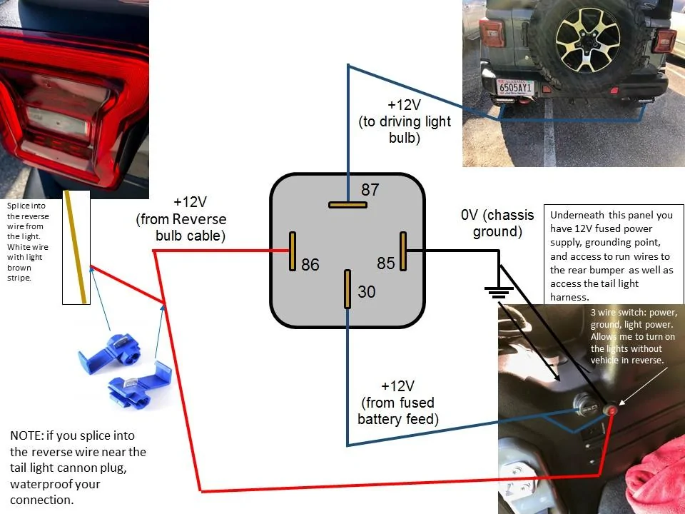

The led's in the bumper, how did you wire those in if I may ask?
I tapped in to the wiring harness of the left rear tail light. Connected the switching side of a relay to the reverse lead in the harness and pulled main 12v power from the cargo area 12v socket wiring harness. I got my wiring tips from this thread (you might find useful) and the following diagram. I did not include the switch to turn on independently so they only come on with the reverse lights.
