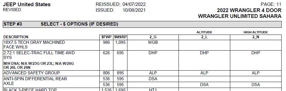

  • Can I really not specify a Sahara or Sahara Altitude with a manual trans and the limited slip rear axle?

... also, it appears that the limited slip rear axle IS available with the 6 speed in the Sahara in all trims (code DSA). However, the 6 speed itself is NOT available in the High Altitude trim.
