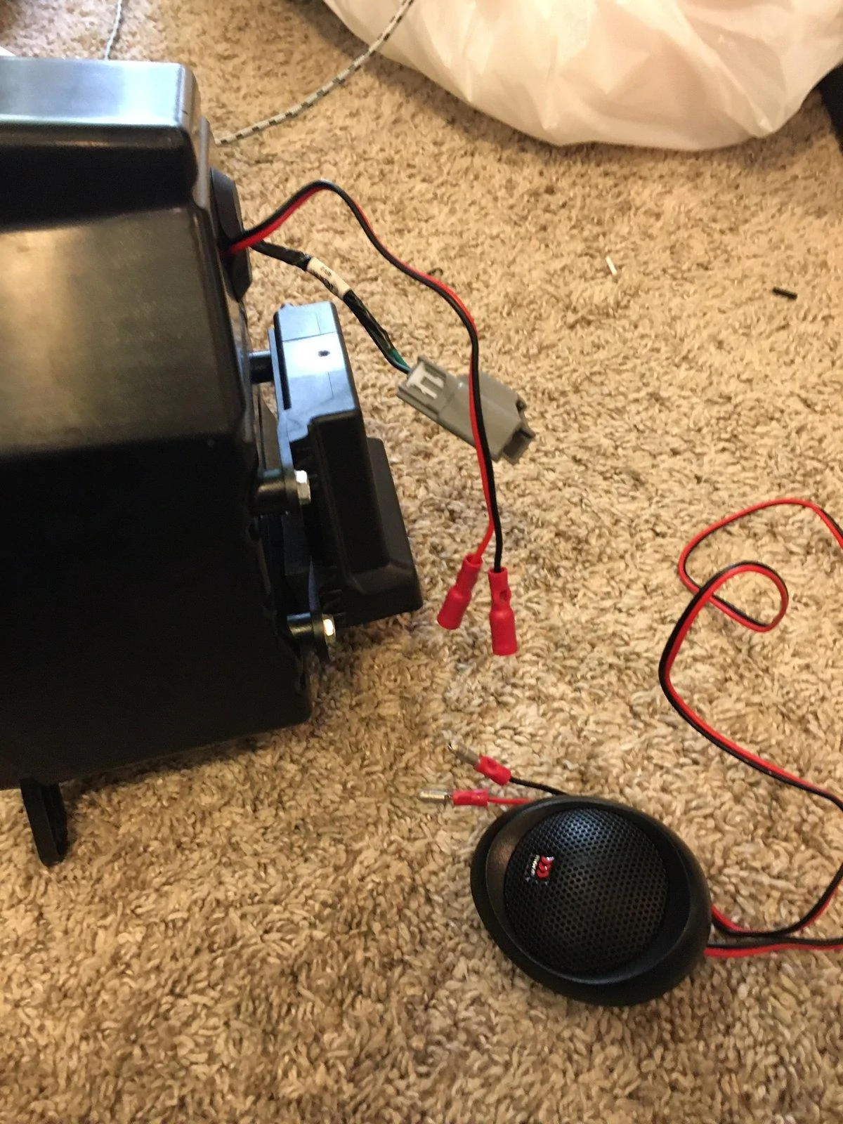

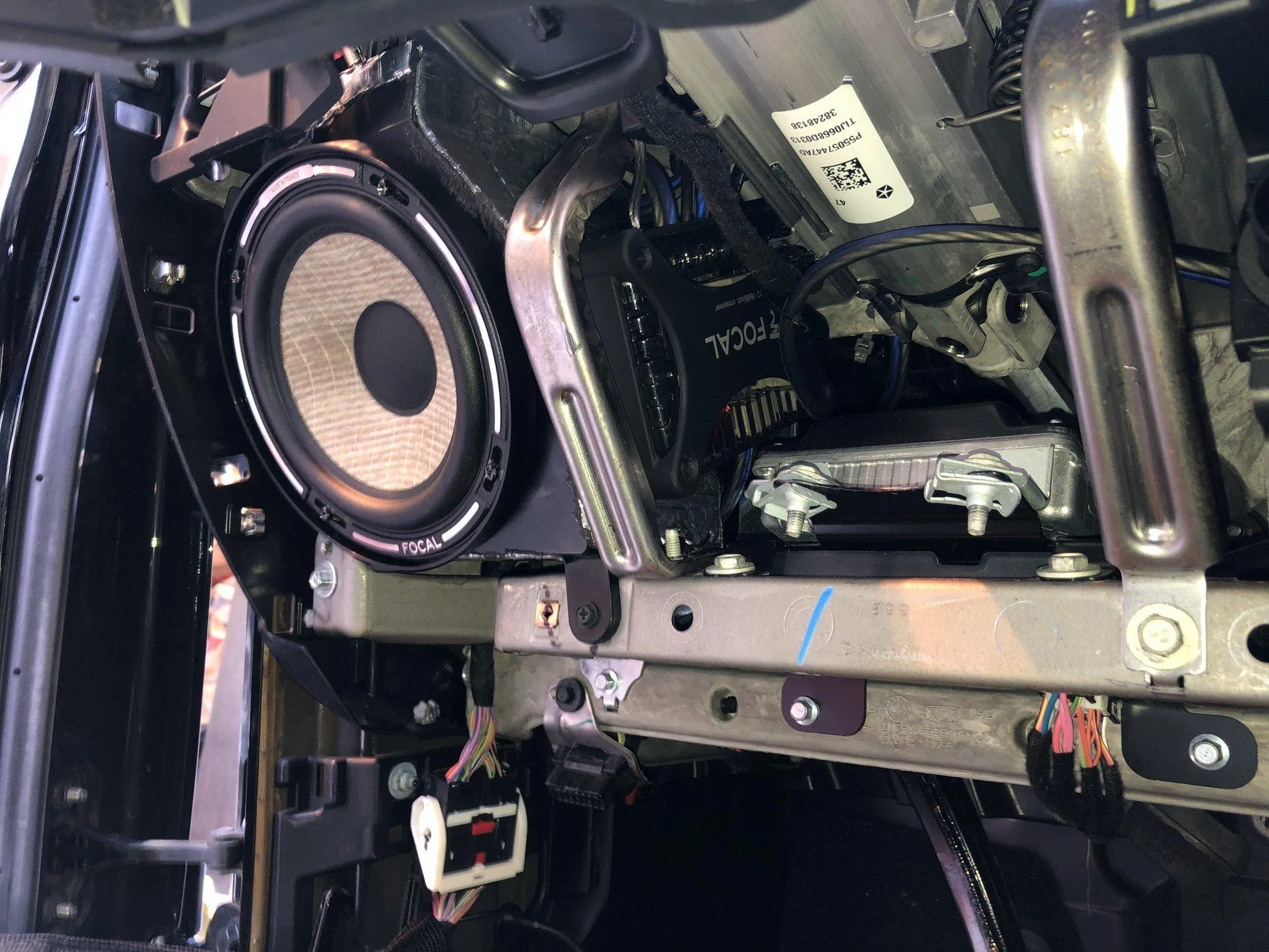

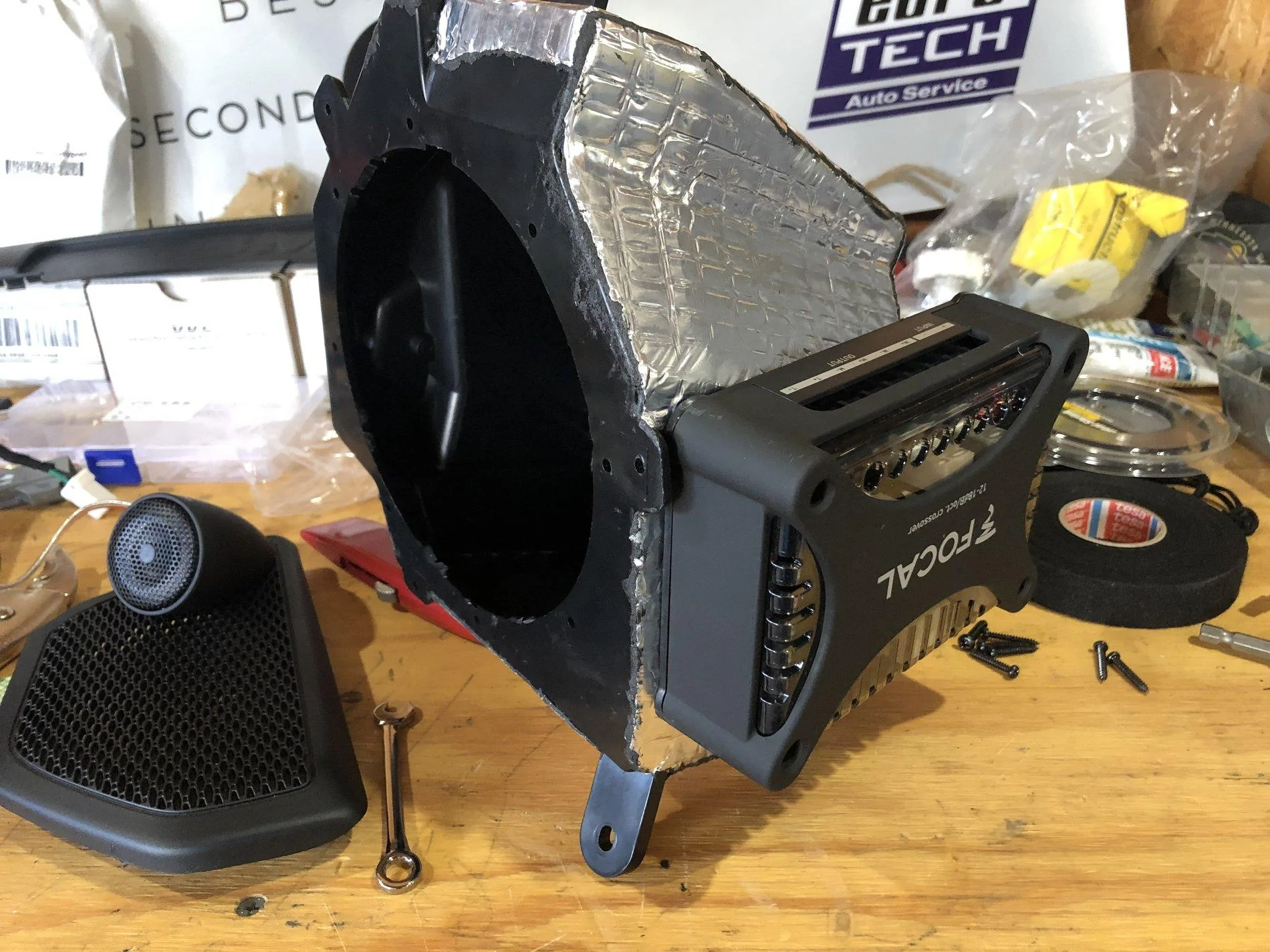

I just did the driver side today, I mounted it to the side of the speaker pod, pics below. The pod barely fits in there, it was a pain in the ass to get in and out. What I had to do was pre-drill the holes to mount the crossover, then get the pod in place, then get all the wires into the crossover then use a short stubby screwdriver to attach it to the pod with the pod in place.
Impressive! Not sure there's any other option... Worst case I'm thinking suspended zip ties. Definitely taking every bit of the dash off so I have some room to work with. Thx for the reply and pics

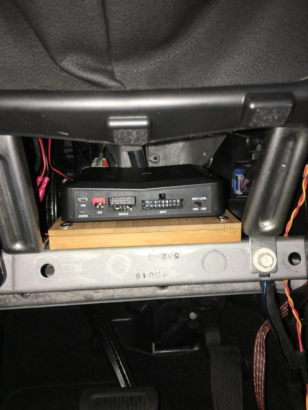

DSR1 is so small it fits nicely under the steering wheel. I just used some scrap wood and made a small shelf for it to rest. This seems like a good spot to access it in the future if it needs to be reflashed or updated.
Nice location for the DSR1. I’ve got the same DSP and have been collecting equipment for my install. Does the adapter harness plug in at the back of the OEM radio? I was going to make my own under seat amp rack. I can’t see spending $250 for a single rack that I could make for under $50 with some flat bar and expanded pvc.
