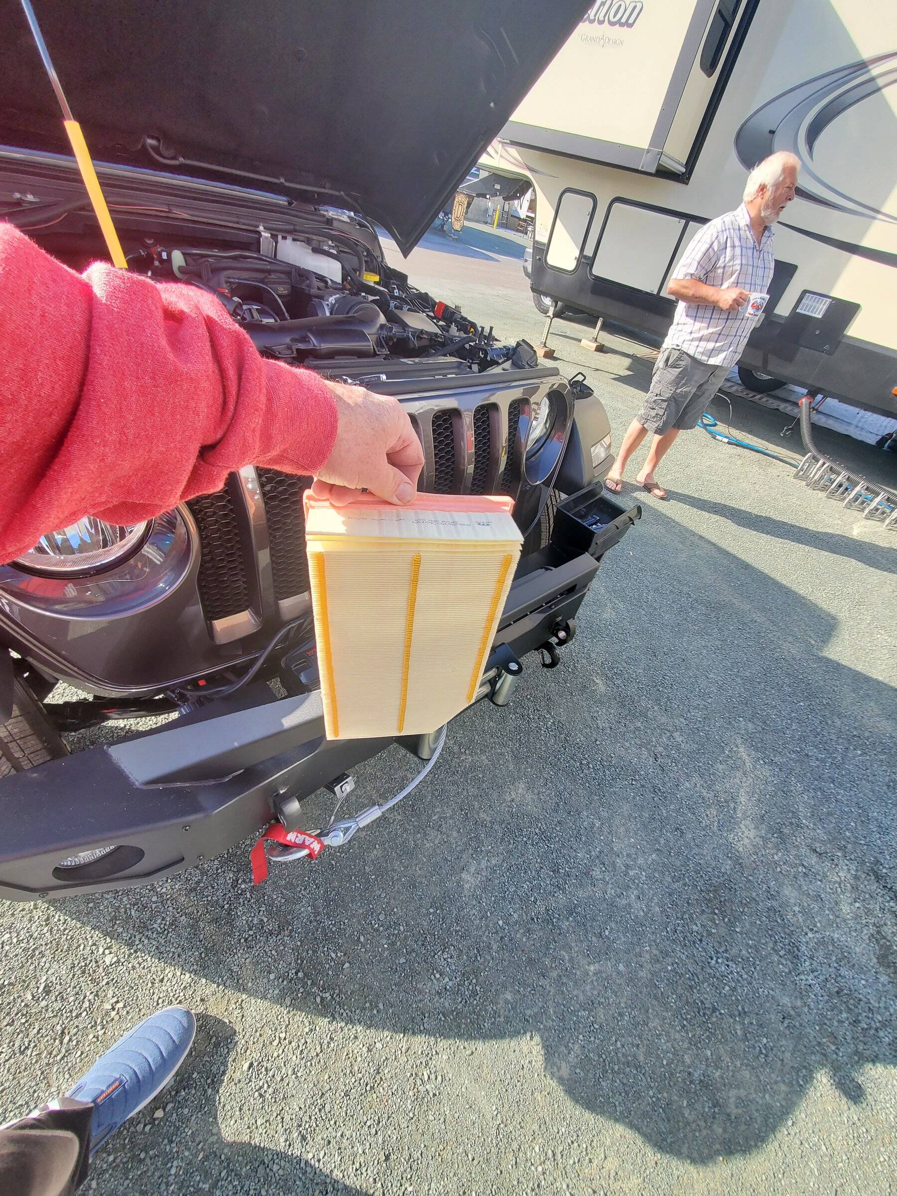

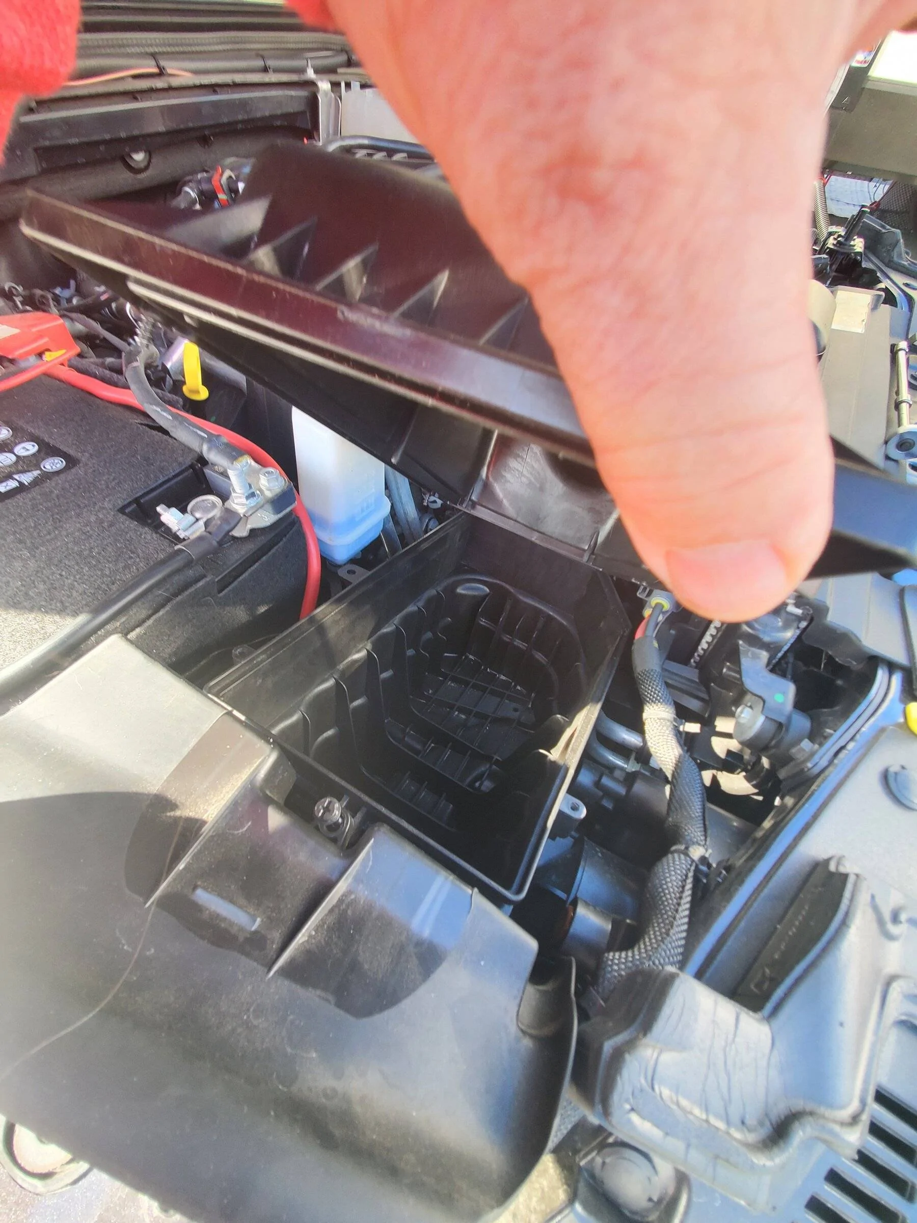

Air filter looks spotless, I’d rule out physical sand intrusion and a cause of concern.

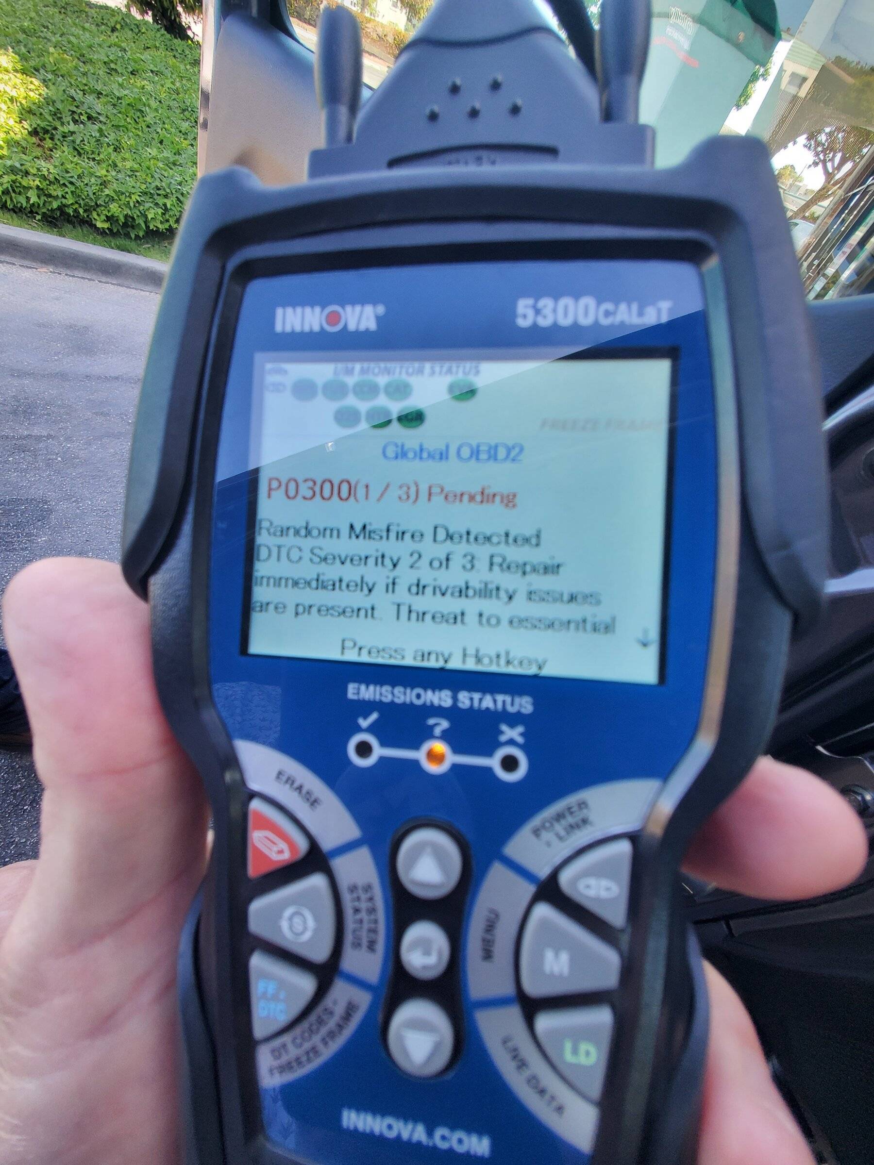

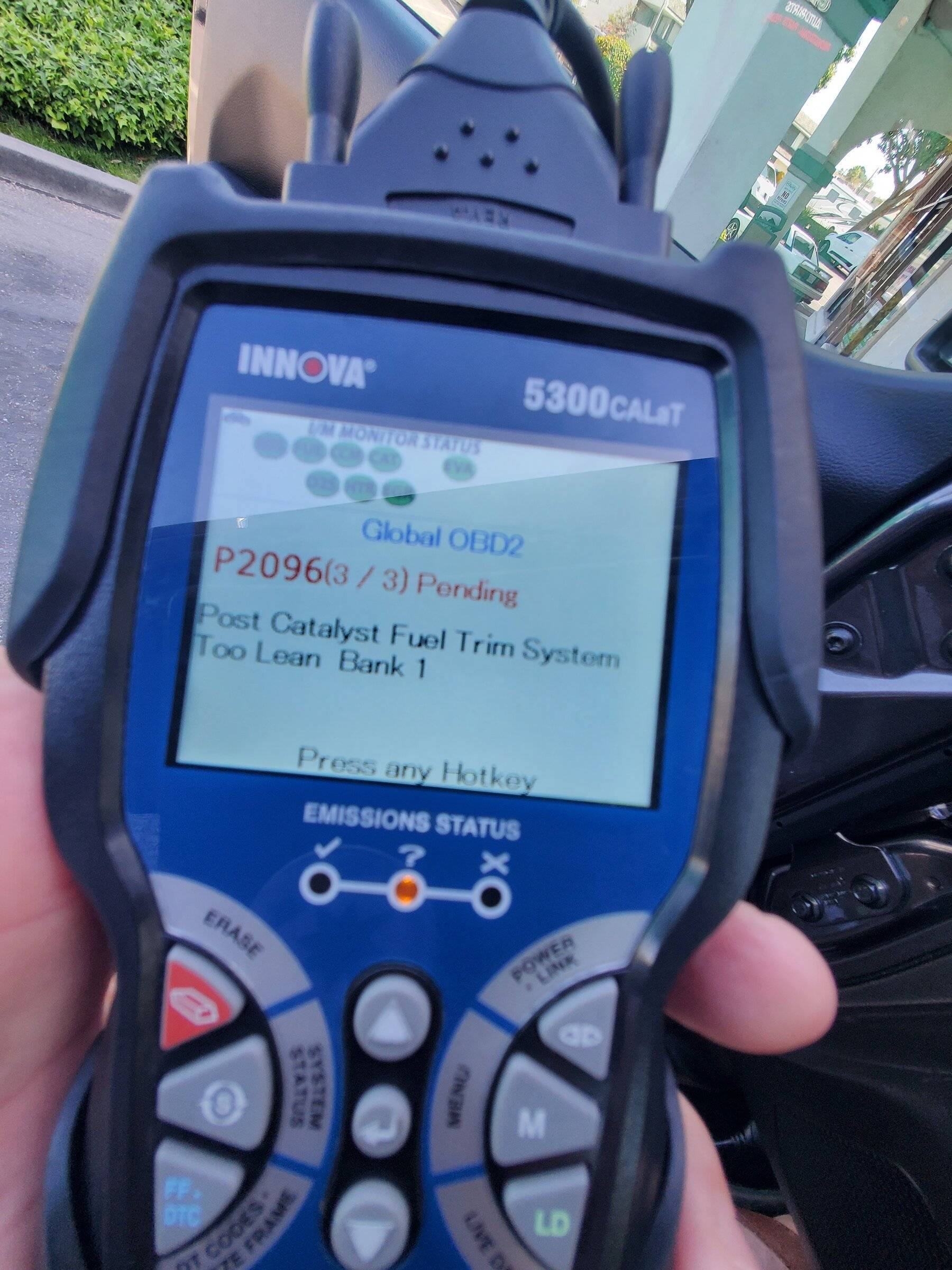

Yes Ican accelerate through around 2krpm is worst here are the codes that are pending. I need to drive 15 miles to deal tomorrow is that ok?

Lean condition, running rough, multiple misfires? check your oxygen sensors on bank one, look for oil leaking directly onto them or wiring damage. Check your air intake for a loose hose.

Let’s see your air filter.
