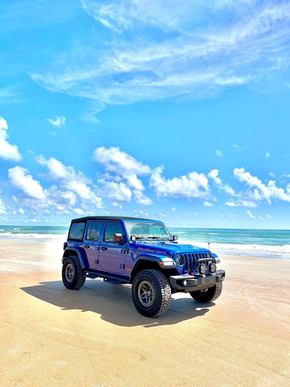

As everyone has said...waiting & seeing how you feel with it stock is great advice.
BUT if you are insistent on modifying it for looks right away, I'd go either 2 routes (First route due to having this set-up):
1. Rancho 2” Lift kit with adjustable RS9000XL shocks that allow you to adjust from soft to firm ride WITH the Geometry Correction bracket… www.northridge4x4.com has the kit for JL 2dr for $809.99 & Geometry Correction bracket for $210.39.
It is proven to be VERY capable (look up @wibornz on here).
What it looks like on JLUR with 315/70-17 (35s):
Jeep Wrangler JL NEW GUY SEEKS ADVICE IMG_1407
2. Get dealership to install Mopar 2” Lift. Factory warranty from the get go (other who have can chime in on cost) and throw 315/35s on (37s even fit fine).
But as others have stated, this shop is trying to just make you spend way more than needed.

I did not even think about the fact that a lift could void the warranty. Thank you for that advice. The blue Jeep is basically the look I want to achieve. What wheels do you have on that bad boy? If you increased from 33 to 35, did it impact performance?
I did not have any performance issues going from the 33s to 35s (fyi, I have the 3.6L).
The wheels are JK AEV Borah wheels … they make the same wheels for the JL but tuck in a little more than the JK version and the JK backspacing is what is recommended for most lifts. AEV made the JL wheel backspacing designed with their lift kit in mind. (Which IS another great lift kit BUT designed more for Overlanding carrying heavier loads.
