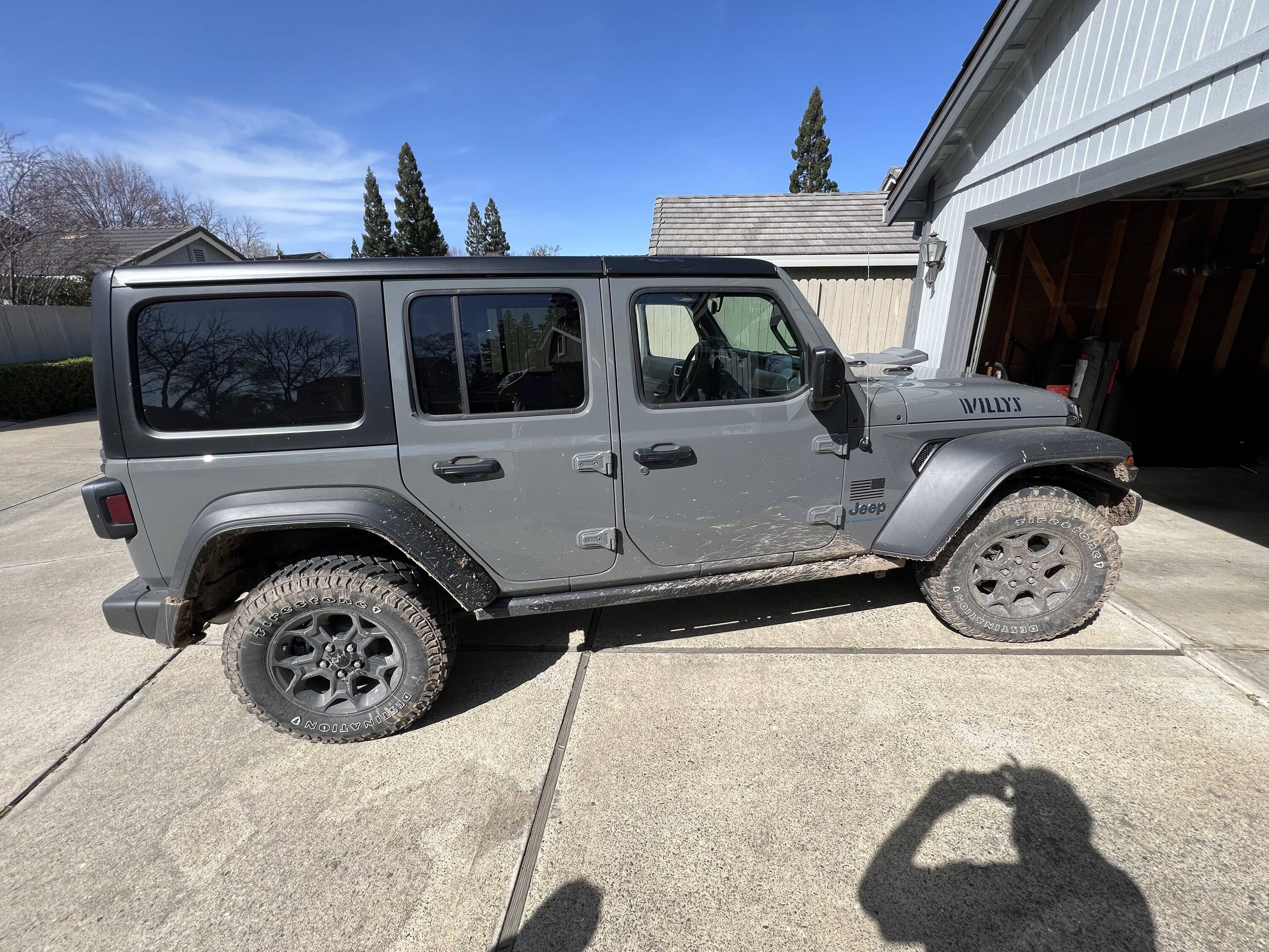

I’ve decided to go with the 35 inch KO2’s for my Wrangler but I can’t find any info at all from other in my situation. I have a 2023 4xe Willys stock. With the Firestone MT’s. I have seen articles and videos about people putting 35’s on 4xe Rubicons. But nothing on Willys. I want to keep the factory rims (don’t know the offset) gonna go 315/75/17. Am I gonna need spacers? Am I gonna need a lift? I off-road but nothing that would require spotters or a winch. Mainly rough trails and some off road courses. I’d like to keep it as low as possible without rubbing of course but I can’t find any information out there about my specific combination. Any info or suggestions would be greatly appreciated. Thanks!

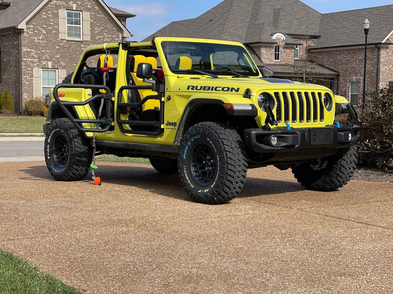

Hi, I have a Rubicon. You can go as high as 35 on the rubicon w/o putting a lift. Rubicon sits higher than Willy's, on Willy's and Sahara's you can go 33 max w/o a lift. And for what it's worth, 33s are default tires on a Rubicon. I replaced them with 35s, but I did a lift too. Although could have gone no lift. I just posted this picture in another thread, but here it is too since I have it handy. This is 35s and a 2" mopar lift

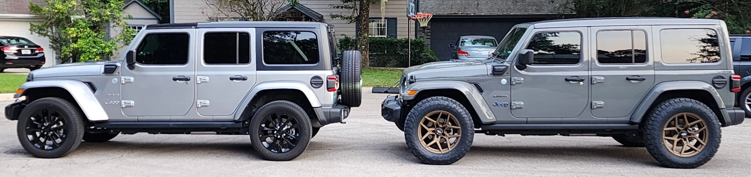

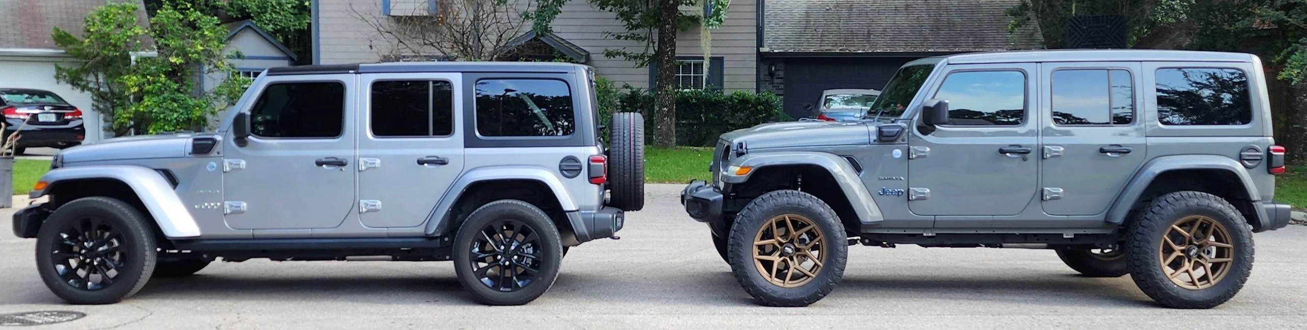

I initially ran 295/65-20 tires on my 4xe Sahara which spec at 35.1" and had no rubbing during a few weeks of street driving before my lift went on. I am running a 20x9 wheel with -12mm offset though so I have a lot more inboard room. If I had no plans to off-road it then I would have left it as is, or maybe done a 1" spacer lift at most. I went with the Clayton 2.5" lift as I know I'll probably move up to 37's when its time for new tires or I get bored, lol.
Below are 2 pics of my Jeep and my wife's, showing before the lift and after the lift, comparing her stock Sahara 4xe to my modded Sahara 4xe.
I like the look of your Wrangler before the lift personally. But functionally it’d have to be lifted a little. I just really like the look of a filled wheel well. Wish both could be accomplished. I will say yours had the best looking stance I’ve seen with a lift and 35’s. I think the lower fender flares give it that look I prefer. I might be the only person who prefers them to the high fenders. lol.

Thanks, I loved the stuffed look as well but knowing I'd probably move up a tire size and wanting to keep the functionality the lift happened. As I mentioned, a 1" or 1.5" spacer lift would be a good option as well, especially if going with a standard 35" tire which is a bit smaller than mine.
I was initially planning on swapping out to painted Rubicon fenders but after seeing the stance with it lifted I've pretty much nixed that for now as I really like the low fender look as well. It also tends to make them look slightly squatted since the front is higher than the rear.
The other option, and one that I almost went with, was the AccuAir lift kit. Having the adjustable height suspension you can keep the stuffed look for daily driving when flex isn't needed then go even higher than mine when you hit the trails. You've got instant adjustment as you add weight/accessories without needing to swap springs or add spacers and it self levels for towing. It's not cheap, but they run pretty good sales occasionally. If I was to do it again I'd bite the bullet and go that way.
