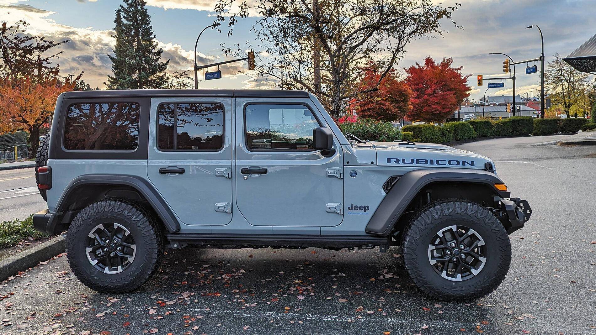

That tire will fit as is without any lift, but the 0.75" can't hurt to claw back some lost uptravel. Truth be told the stock setup doesn't even utilize all the uptravel available (even with sway bar disconnected) with a 35" tire. Since you are on high fenders like a rubicon, take a look at my past setup (2024 Rubicon 4xe, no-lift and Falcon 35x11.5 RT tires)

They do run narrow on tread width, even less than a 285/70/17, so get ready to visually see the skinny-ness

That said you will have no trouble clearing them at full flex. With stock (no spacer) there is an ever so minor rubbing on the rear inner fender at extreme flex.. nothing else.
