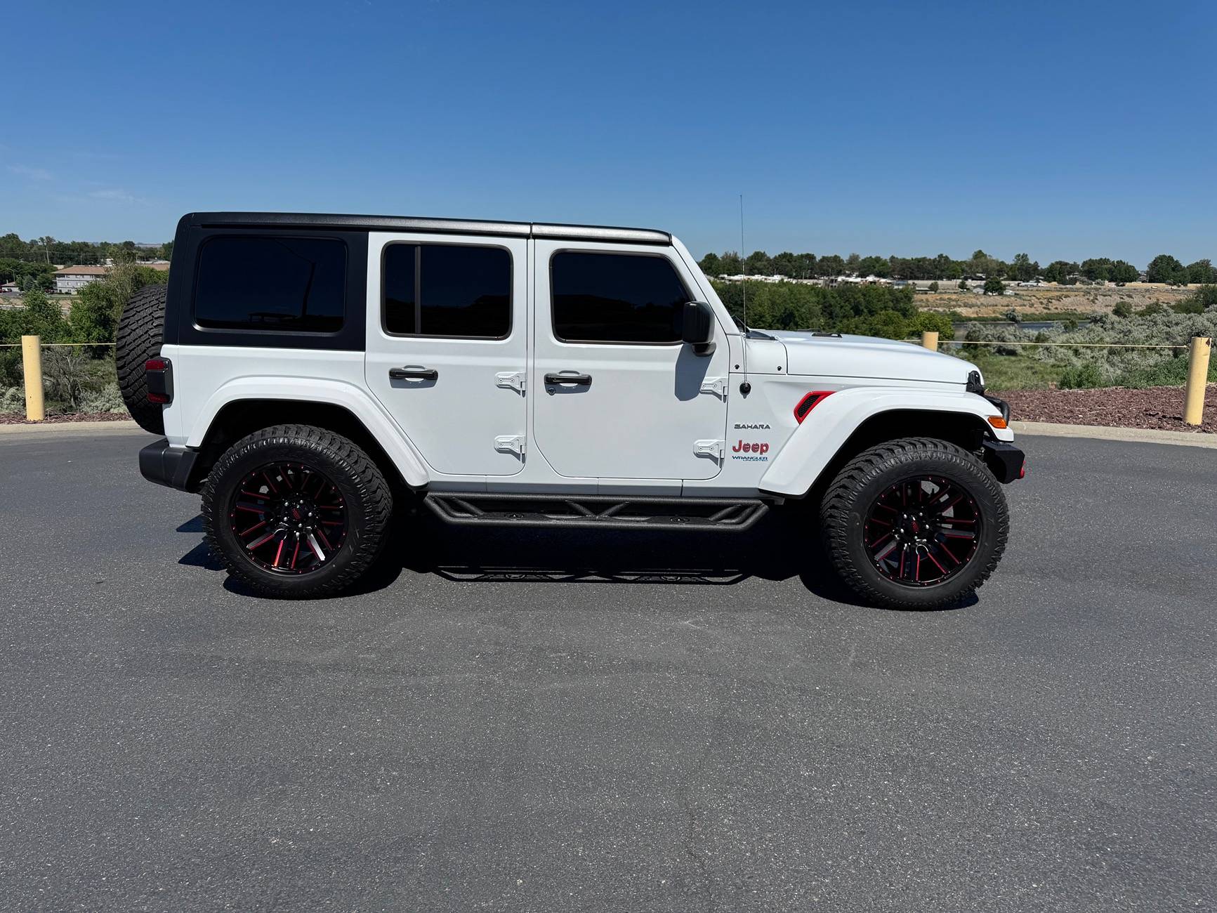

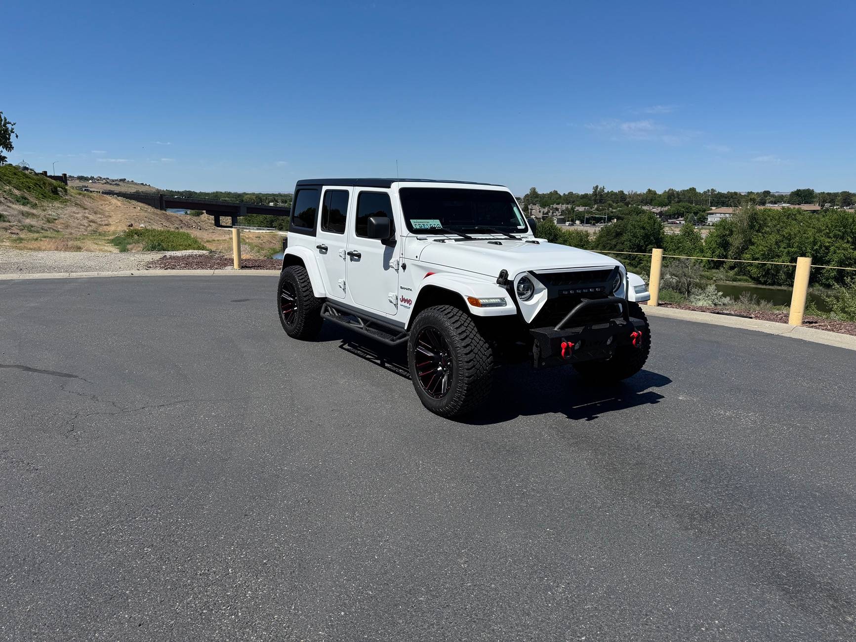

Looks like you could use more space with those tires…..
I just put the Teraflex ST2 2.5" lift, $1324, on my Sahara two weeks ago.
https://teraflex.com/jl-4dr-2-5-sport-st2-suspension-system-no-shocks.html
I’ve got extra weight, Al bumper, winch, and a few hundred pounds in the back - jack, chain, tools… and I was a bit surprised that my lift ended up near 4 inches. Not sure what to think about that yet. I was expecting closer to 2-3 inches. So the comment about double checking the springs is very appropriate.
I was not going for a softer ride - just the opposite, but I have been happy with my first two offroad trips. Lots of clearance and that suspension handles the whoopsies (desert moguls, I call them) really well. Still running with 33” tires, though.

The majority of spring lifts are rated for a heavy Rubicon, which is generally about an inch taller than a non-rubi. Surprising you got that much out of a non-4xe kit though.
Shock eye to shock eye at ride height should get you a pretty decent comp. My MC 3.5" springs were ~24.25" Front and 27" Rear. A net change of about 4" over stock. Rubi springs with a 2" front spacer and 1.5" rear spacer measured 22 front, 24.25" rear.

The Teraflex kit has a 4Xe option - which is the one I ordered - although that is probably rated for the Rubicon. My front shock dimension with the lift is just a hair under 24” (didn’t measure this before) and the body is about 4” higher than what I started with. Can’t yet say I am unhappy with that height but I am concerned about possible steering implications (track bar, etc.) So far nothing I have noticed, but I am an amature. I’m still confused on the differences between the different Jeeps when it comes to the suspensions.
