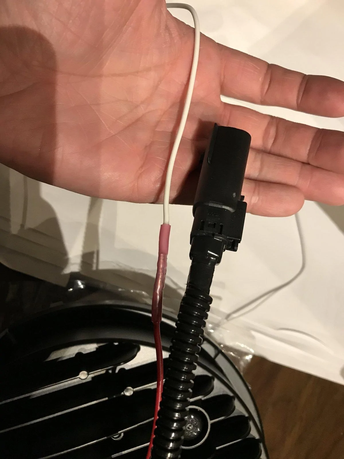

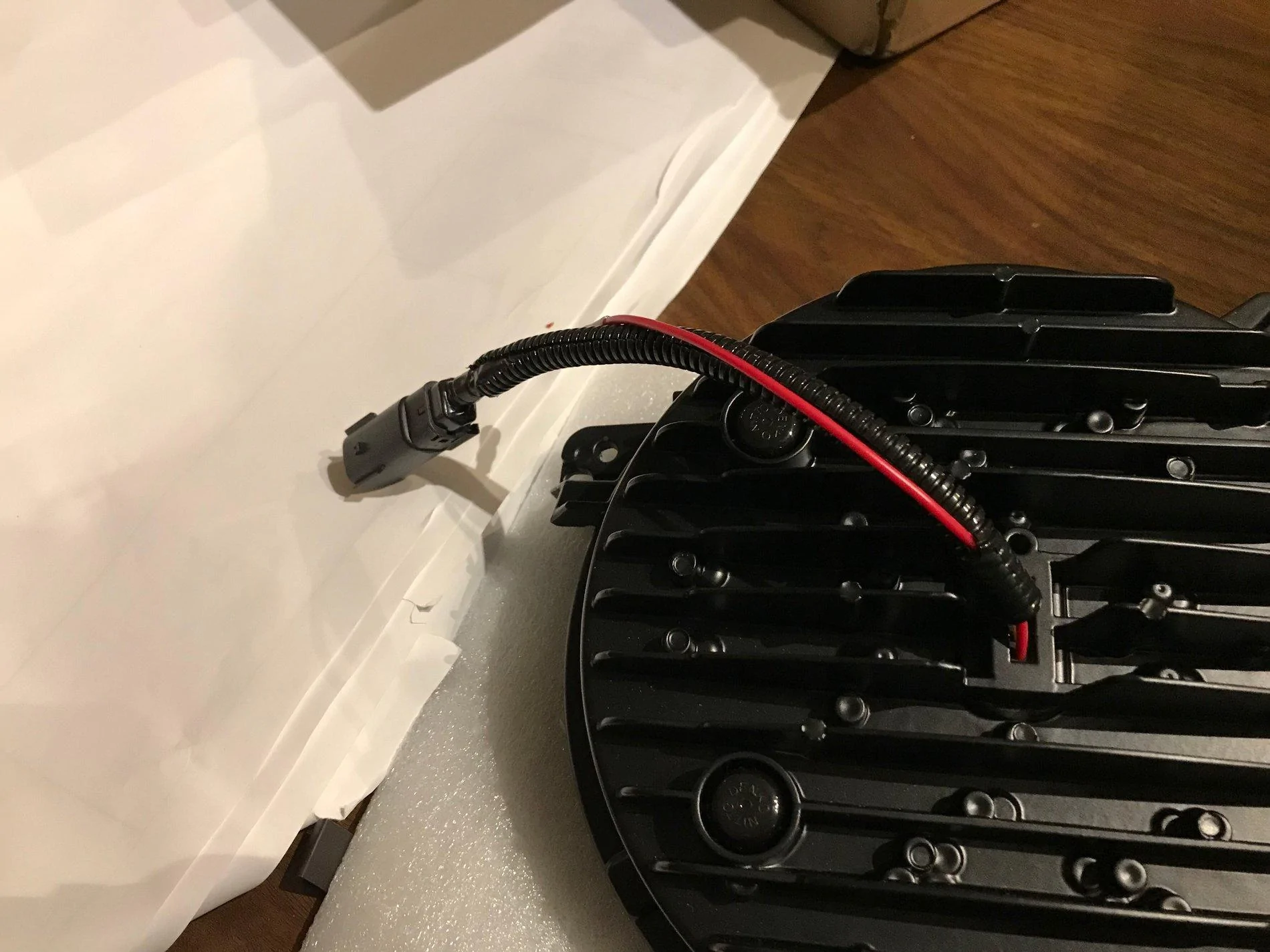

wiring harness/plugs compatible with JL.

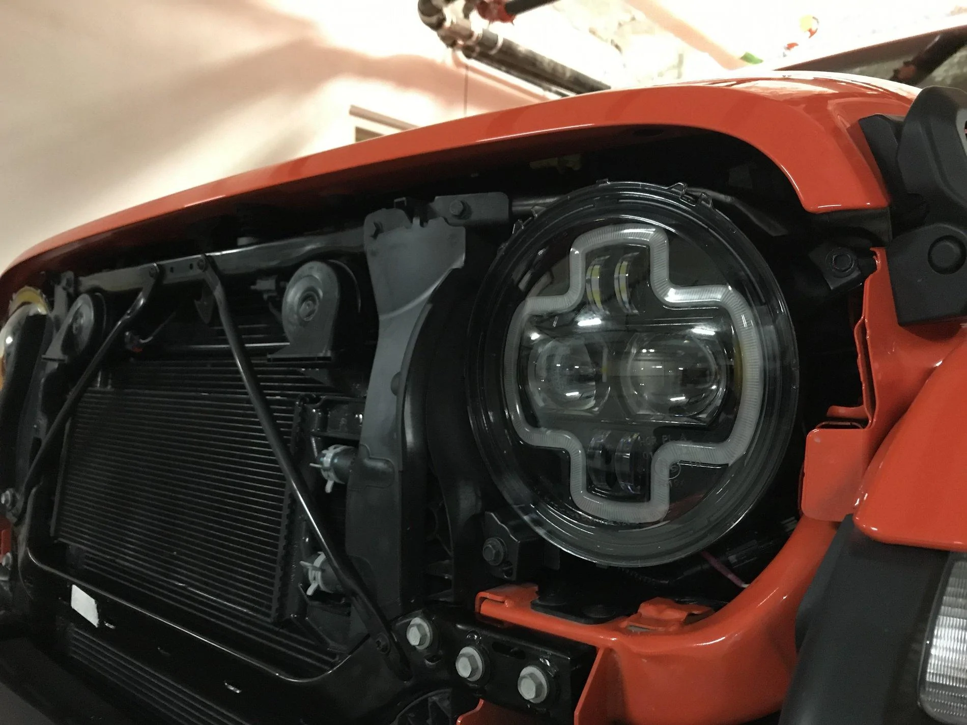

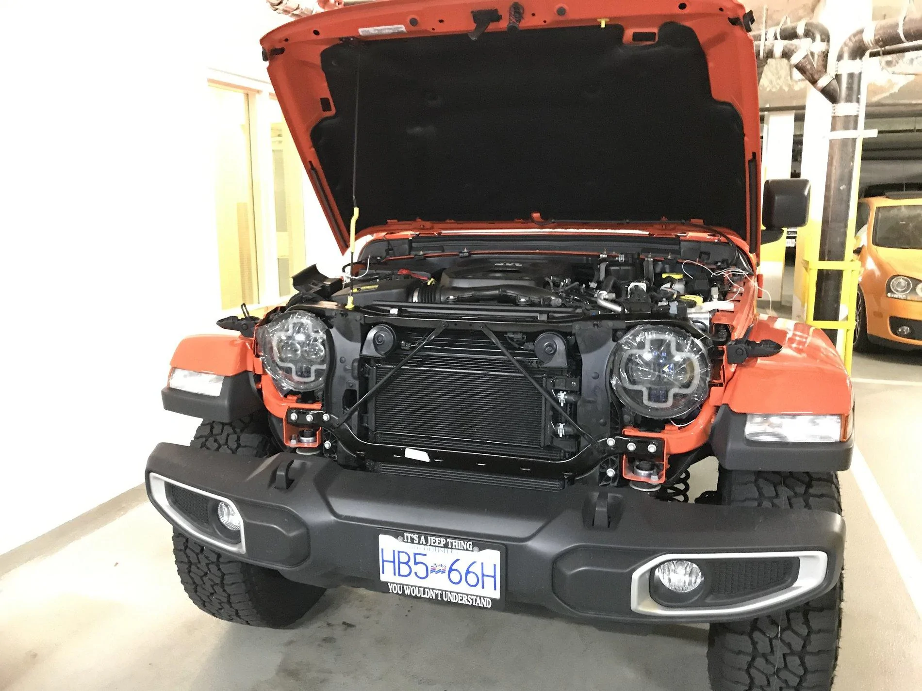

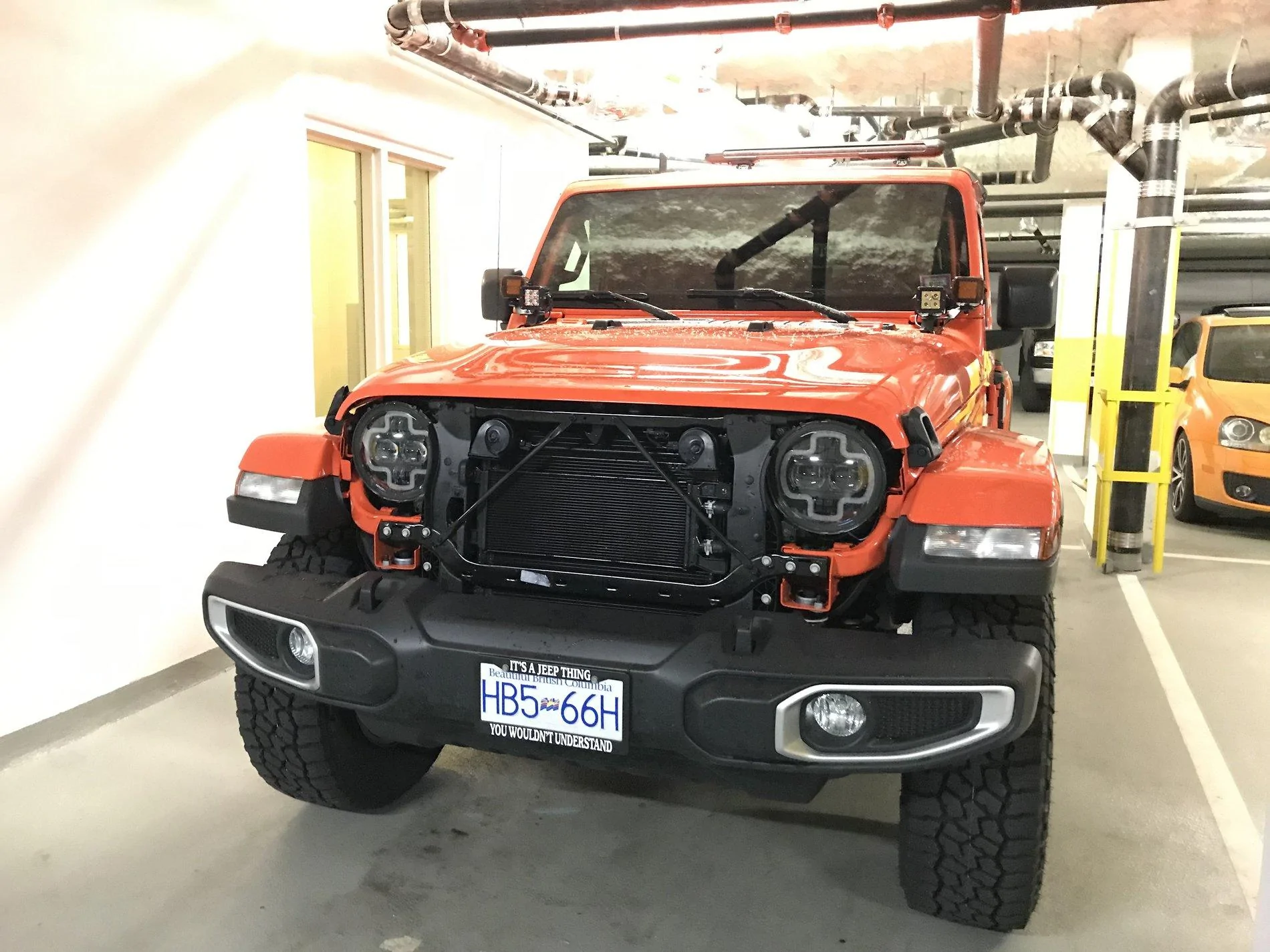

Work in progress, should be done today along with grille insert repaint.

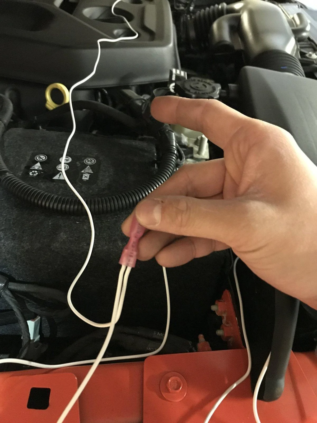

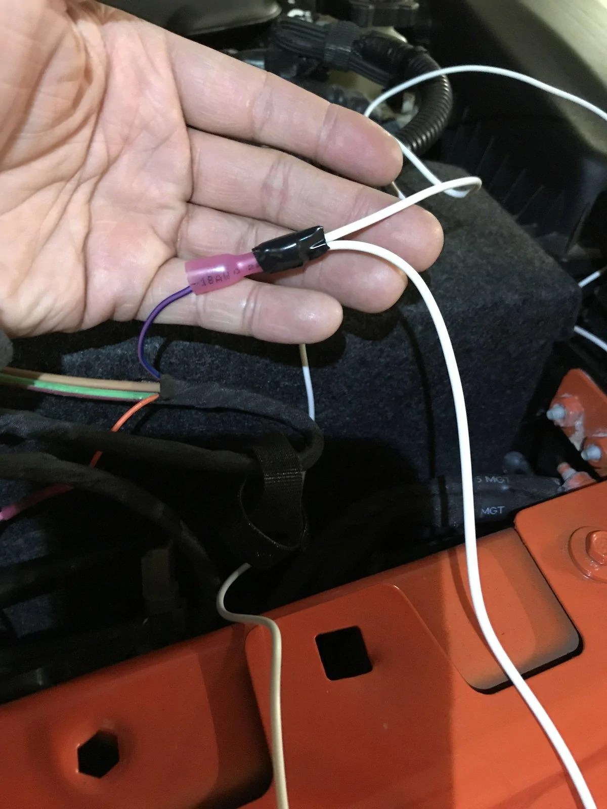

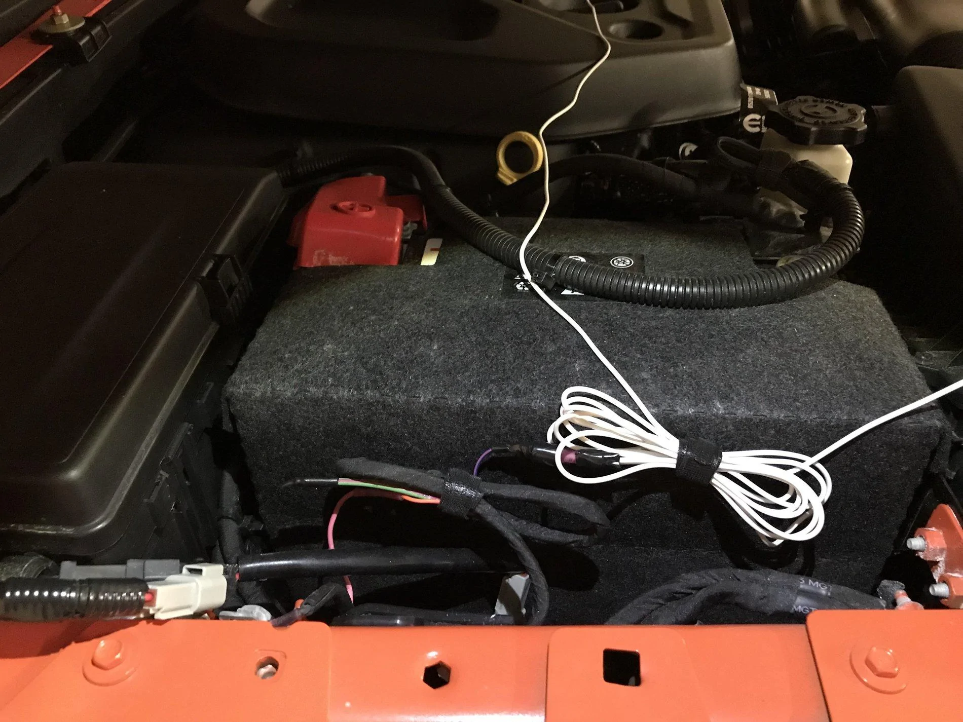

DLR wired to aux switch, latching ignition recall, not the most elegant option, but functional for now. Will see if I can rewire to fender DLR later.

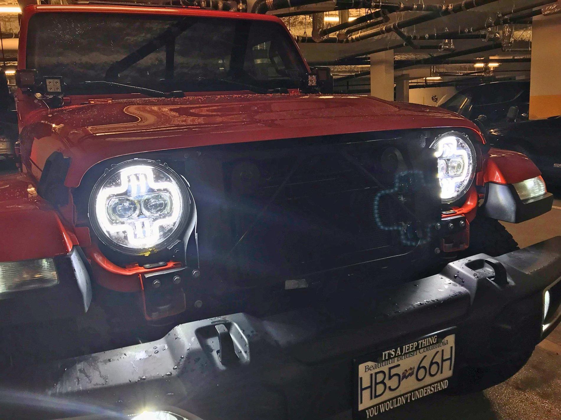

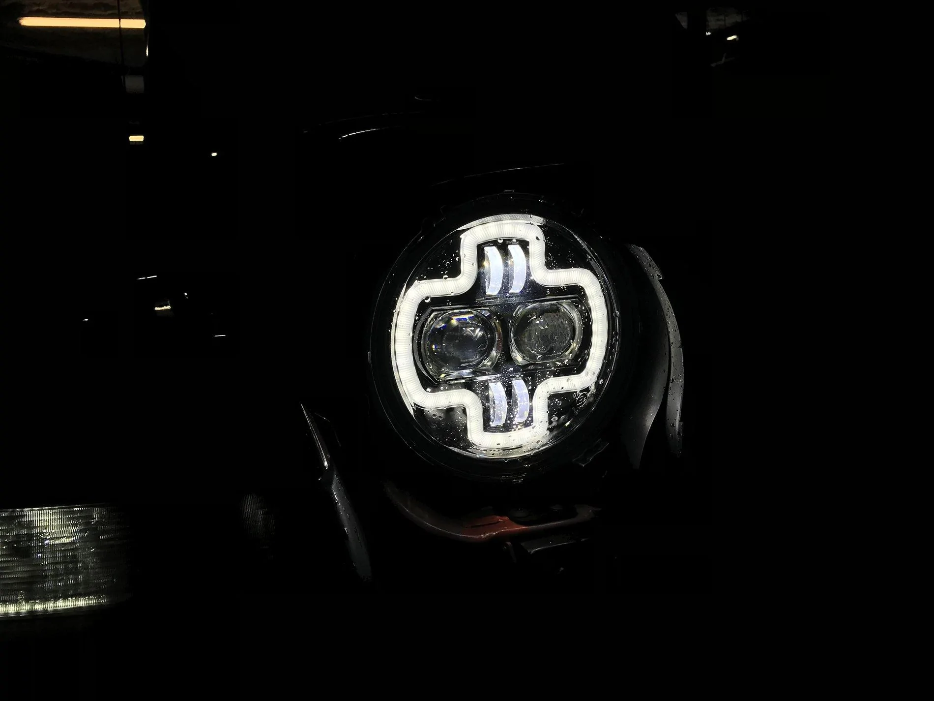

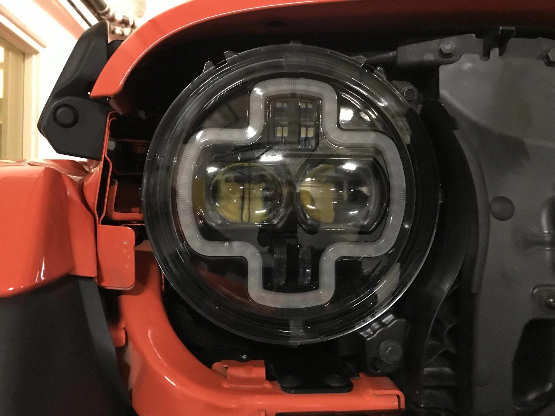

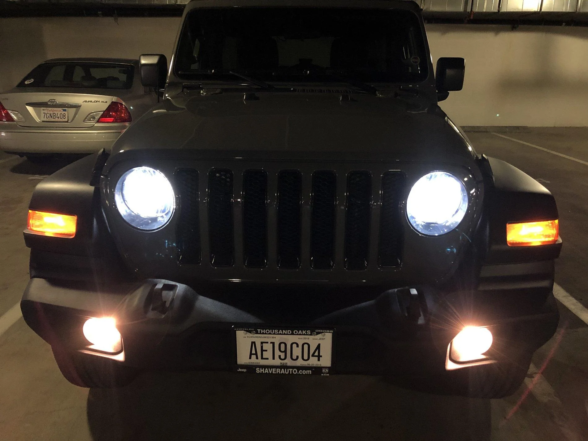

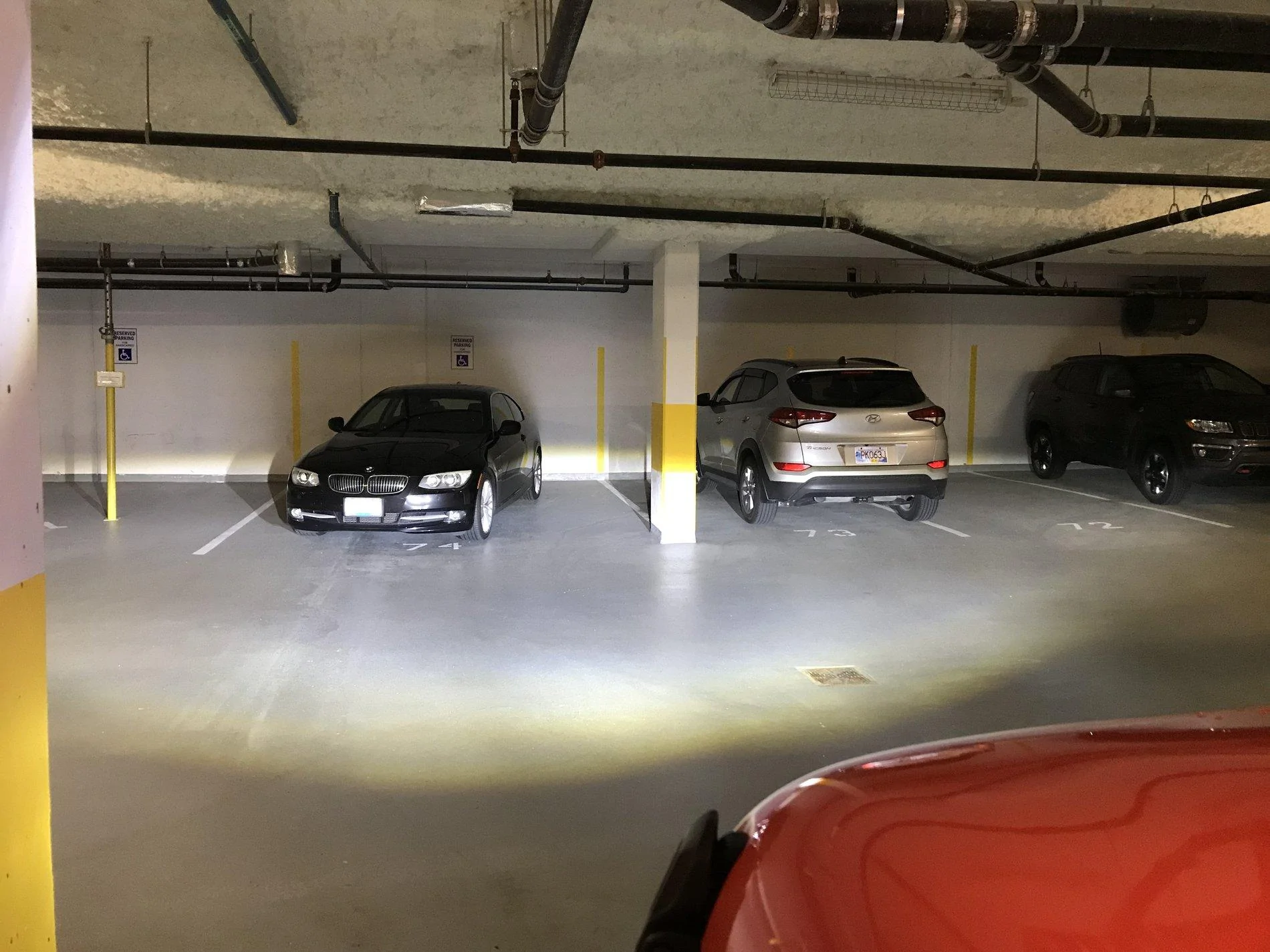

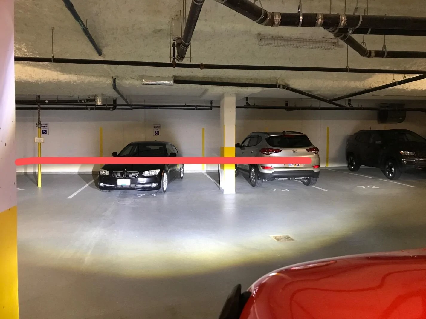

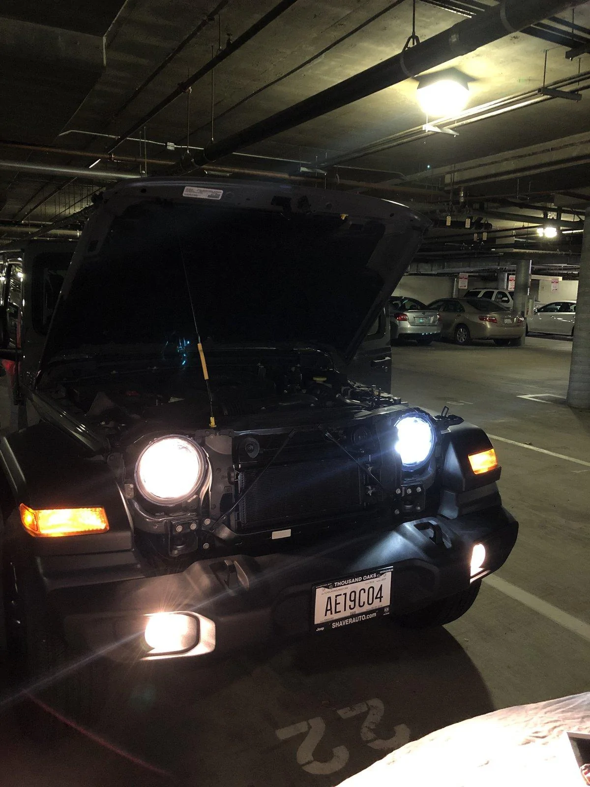

Here is my honest opinion on these headlights, coming from stock halogens, they are bright, super bright, probably 3-4x brighter than my halogens, but I find the optics inside do NOT scatter light like many other aftermarket LEDs, it makes a sharp cut-off in a cone shaped area, see my last pic, and they are pointed down low as is, no need for adjustments on my Jeep. Now, if you do want to adjust them, there is no screw adjuster on the housing like the factory assembly, you have to add washers between housing and the rivnuts on the frame, which is a straightforward process.
With the low beams on, the vertical bulbs light up, while high beam leaves the low beam bulb on and turn on the two horizontal bulbs at the same time, so you can short and long range illumination. I wired my DRL to Aux 4 switch so I can manually set it, with just the DRL on during the day, it looks absolutely amazing, I get plenty of head turns and lookie loos driving around, and people complimenting on the headlights when I park.
I'm at work and night here so I won't be able to take decent photos with the Jeep for a while, my phone doesn't have enough dynamic range to capture both the light and the Jeep at the same time. But I'll take more decent photos with it during the weekend and sunny out.
