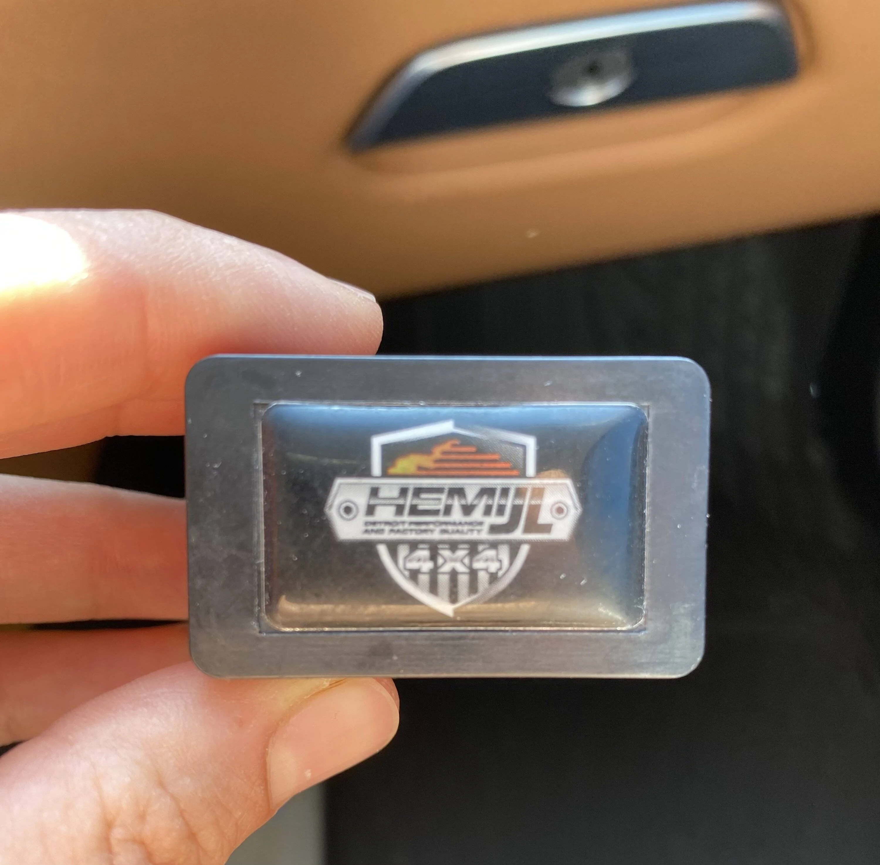

Got a picture of the module the shop added?
Thanks for addressing that. My shop told me that that had nothing to do with it but I can't help but think its causing a glitch somewhere. After the AUX went out I unmarried it then remarried and did the 2 reboot cycle both times.
I was also thinking that perhaps not locking the car prevented it from going to sleep due to some sort of glitch with this module.
I took it off and put it somewhere, will look for it and post a pic as soon as I find it.

Here it is.. any ideas what brand this is?
A quick Google search using the image and the text on that module are turning up nothing.
I’m confused as to why they’d yank your Tazer and put this on in an attempt to clear your TPMS light/warning.

Your shop just arbitrarily yanked a Tazer and replaced it with this? Where is your Tazer?
Yep, and they didn’t tell me. I checked and found this. They said they wanted to try this in case the tazer was faulty. I heard some shops mess with your car once the warranty runs out so you keep coming back to them to fix. Didn’t think this one would but I guess you never know these days ?

It’s concerning that the module is labeled “HemiJL” and you have a 2018.
That ain’t no hemi, right?
Same here I couldn’t find anything at all. They did a great job on both of my cars until this happened. Again once the warranty ran out ?

Get your Tazer back. Add air to your tires. Replace your batteries.
