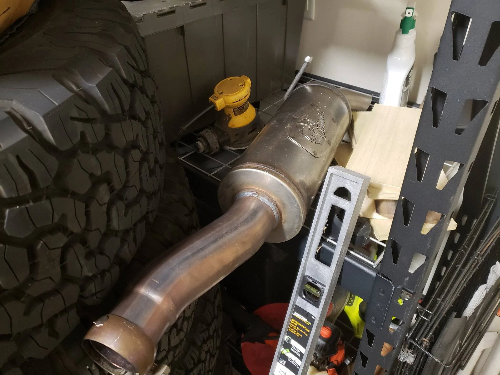

I was eyeballing that space that the muffler takes up and tried out the AFE Rock Basher exhaust that dumps out just in front of the rear axle. I really like the look of the jeep without the muffler and was looking forward to doing something with that space, but the Rock Basher was too loud for my old ears. Stock exhaust went back on after about 4 weeks. Anybody looking for a gently used AFE Rock Basher for a 2dr JL? ;)
