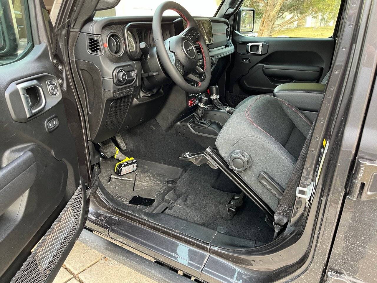

I installed this at the same time I added the Desert Does It seat jackers under the driver seat. That was deliberate. I was able to get the driver's seat out of the way, which I recommend.
Jeep Wrangler JL MORE Dead Pedal on 2024? seat
It might be better to take the seat completely out, but this was enough room for me.

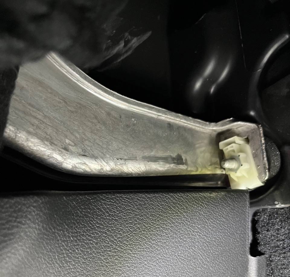

So here's the 2024 aluminum bracket without any holes:
Jeep Wrangler JL MORE Dead Pedal on 2024? bracket

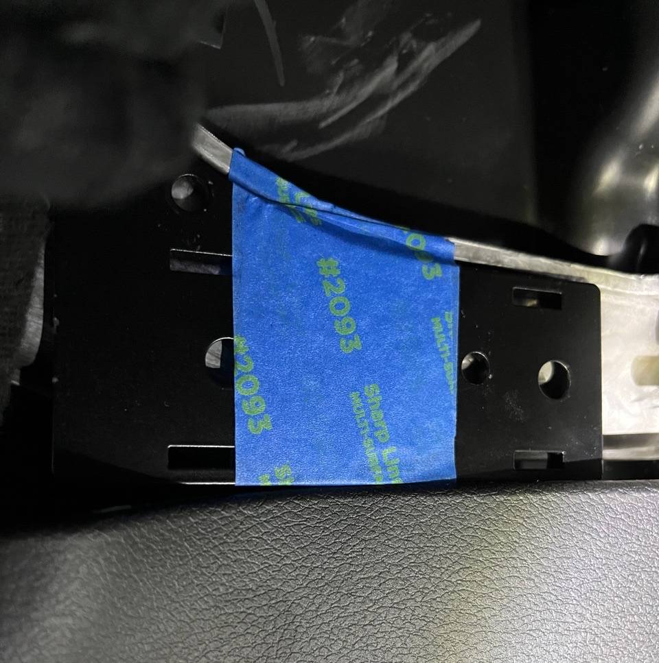

I wondered if it would be obvious where to mount it without any guides, but that wasn't a problem:
Jeep Wrangler JL MORE Dead Pedal on 2024? ta
The top curve of the MORE bracket fits into the curve of the Jeep bracket.

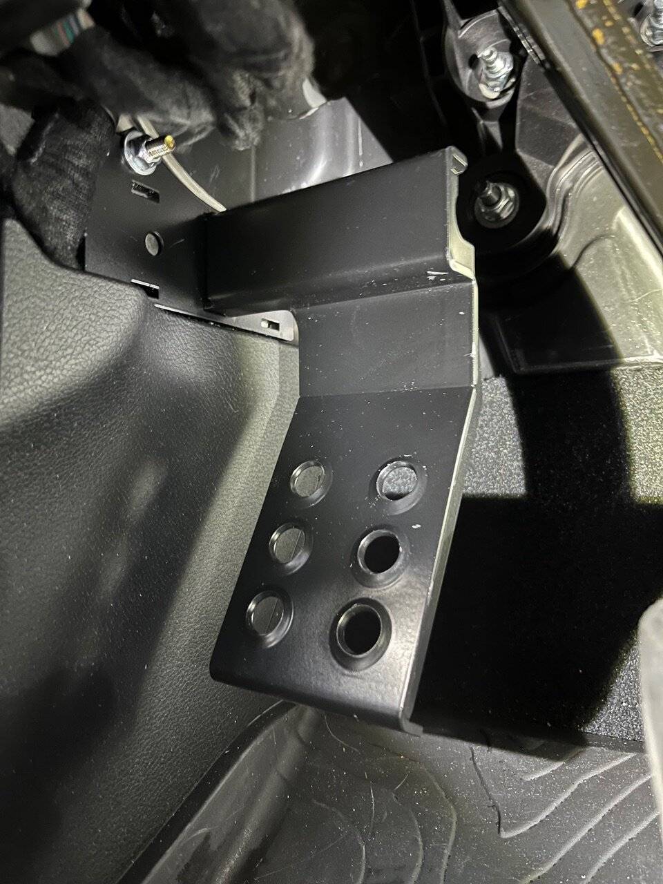

What I did was first use a standard battery drill to drill the support hole towards the right of the photo. I marked it, moved the bracket out of the way, then finished the hole with a step bit. The drill was behind the brake pedal, so I was able to drill it mostly straight on.
Then I bolted the bracket into position using the hole I created. That enabled me to drill through the bracket to make the second hole on the top left.
But there was no way for me to drill the upper hole using the same tools because of the proximity of the brake. I had to use a right angle drill and my step bit, because it was more compact than a regular bit.

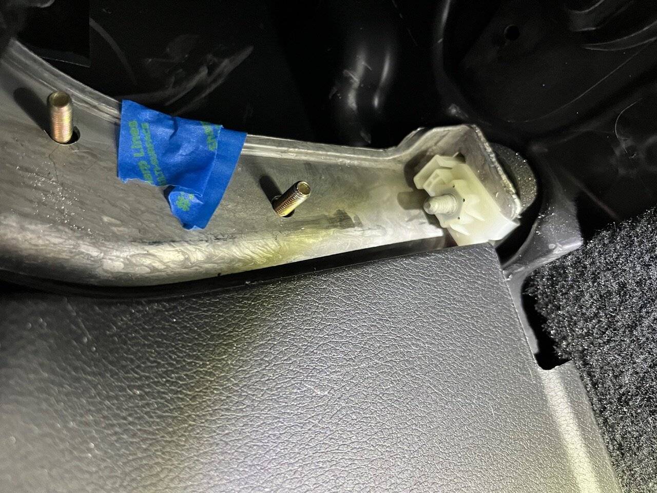

With the two holes drilled, installation was not difficult:
Jeep Wrangler JL MORE Dead Pedal on 2024? insert
I used some tape to keep the back bracket in place until I could get a nut started.
Jeep Wrangler JL MORE Dead Pedal on 2024? don
I'm totally fine with how the install came out, and in hindsight it doesn't seem a tremendous amount of work.
