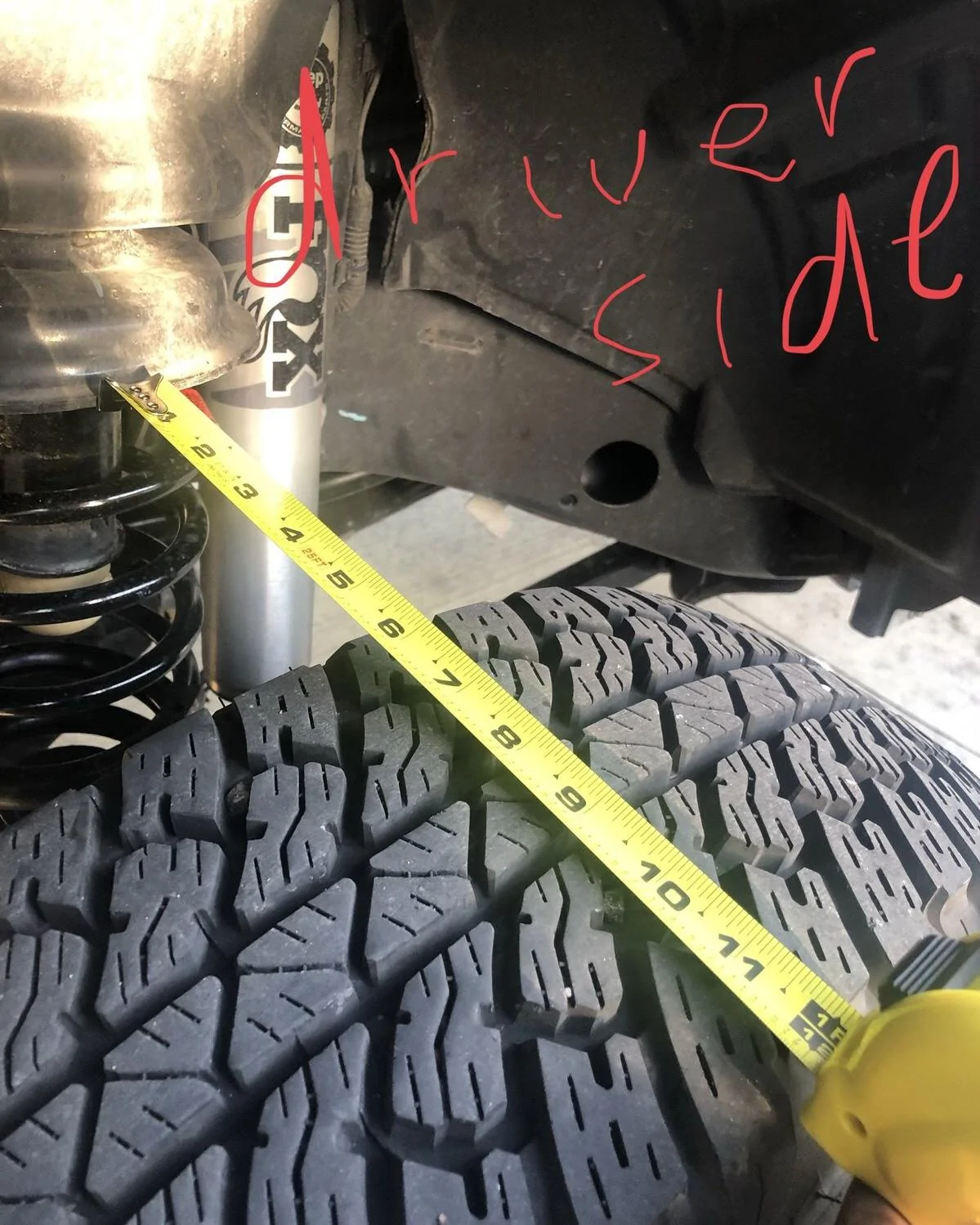

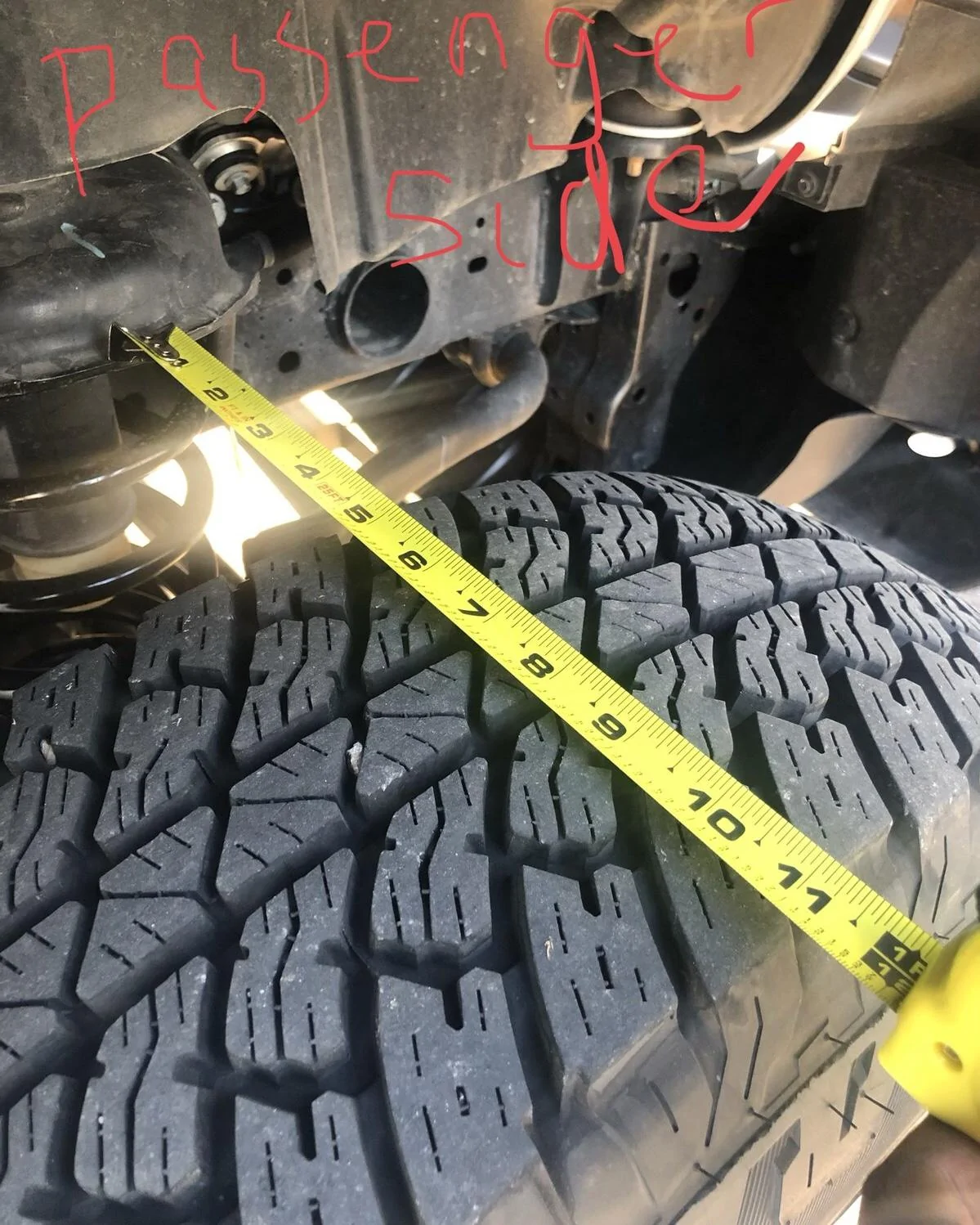

It’s the amount of lift you got, is the reason for your low caster. Looking at your avatar pic it looks like you got more like 4 inches. Can you measure your front axle like this.....
I’m curious how far your axle is off center. The sport in these pics was off 1 inch after Mopar lift install. What part of Florida? I’m in Citrus Co.

Just measured and have what you do, 5.5 drivers side, 4.5 passenger side. Is this a concern? I’m in western Volusia County, hi neighbor...

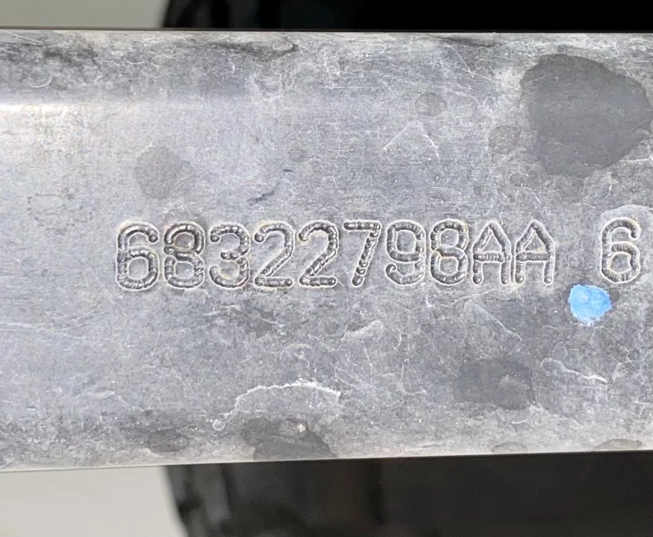

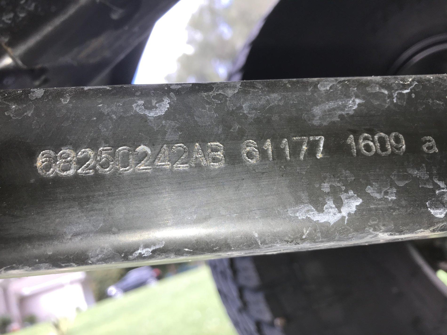

Hey bud. Check part number on your arms. They are stamped on the inside of each arm. This is part number for Mopar Lift arms. This will verify if they installed or not.

This is the number on mine, different than yours
