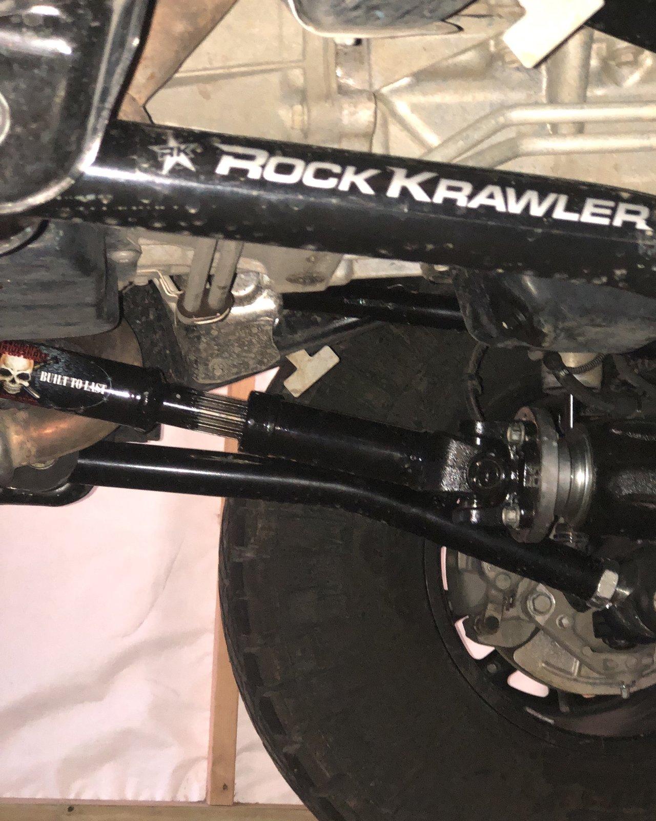

It’s the amount of lift you got, is the reason for your low caster. Looking at your avatar pic it looks like you got more like 4 inches. Can you measure your front axle like this.....
Jeep Wrangler JL Mopar Lift Kit vs.... FDBC41C0-52F3-421C-8F87-1084124B05F8
Jeep Wrangler JL Mopar Lift Kit vs.... 6CE4A074-6B7C-45EB-8BDE-A6A6CD872D4B
I’m curious how far your axle is off center. The sport in these pics was off 1 inch after Mopar lift install. What part of Florida? I’m in Citrus Co.
