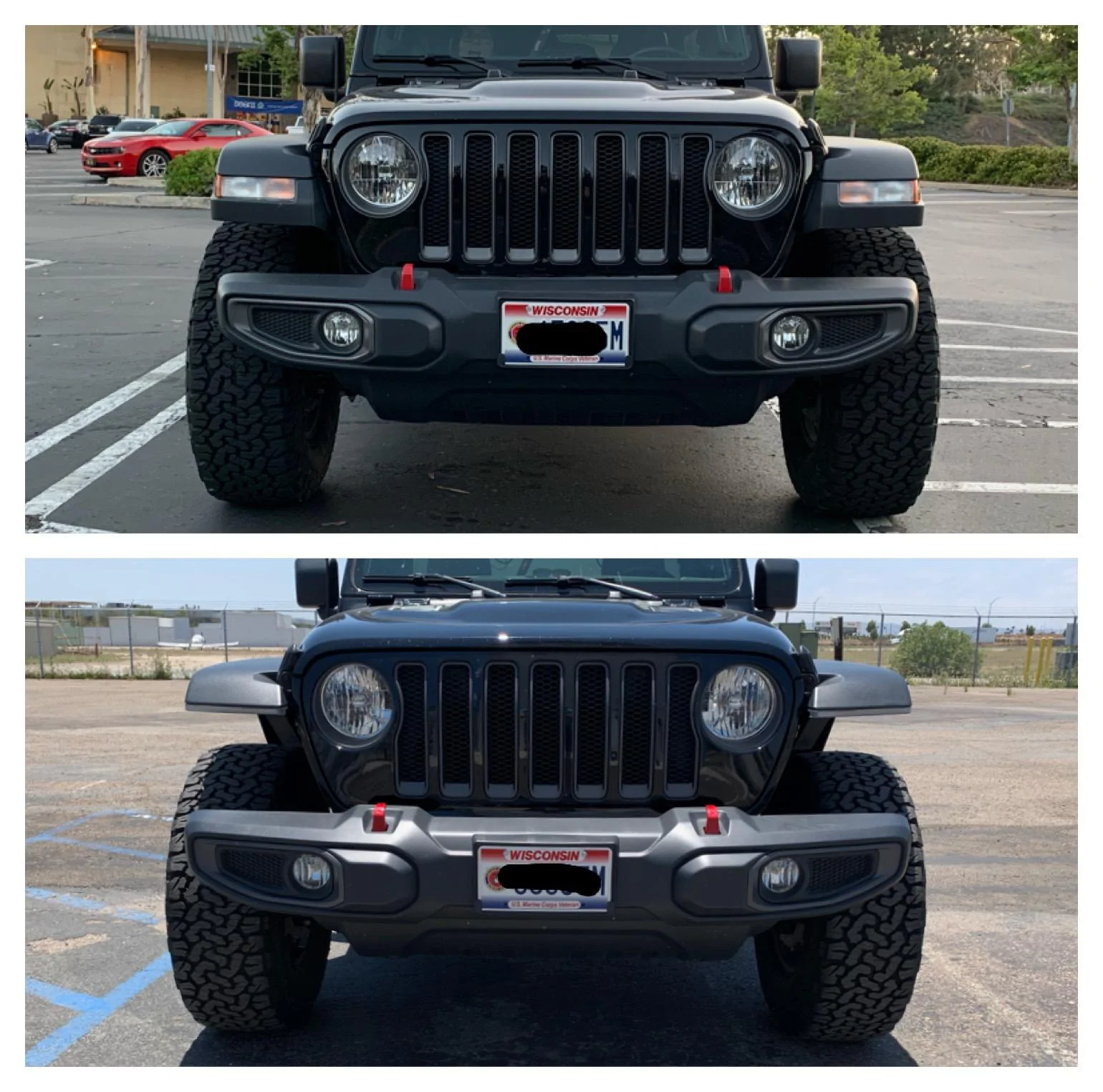

This is before I added the LED Headlights & fog lights but I see a lot of people mentioning LED DRL, the set I have is from American adventure lab. The factory fenders on Sahara/Rubicon are a two piece design which can be separated and this new light is actually a bracket the supports the fenders once the interior lining has been removed. I love these things! They’re very bright and change to orange and are sequential when signaling.
