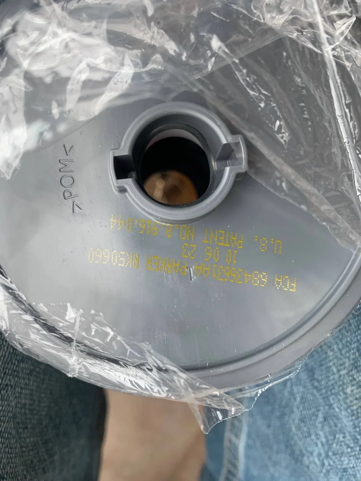

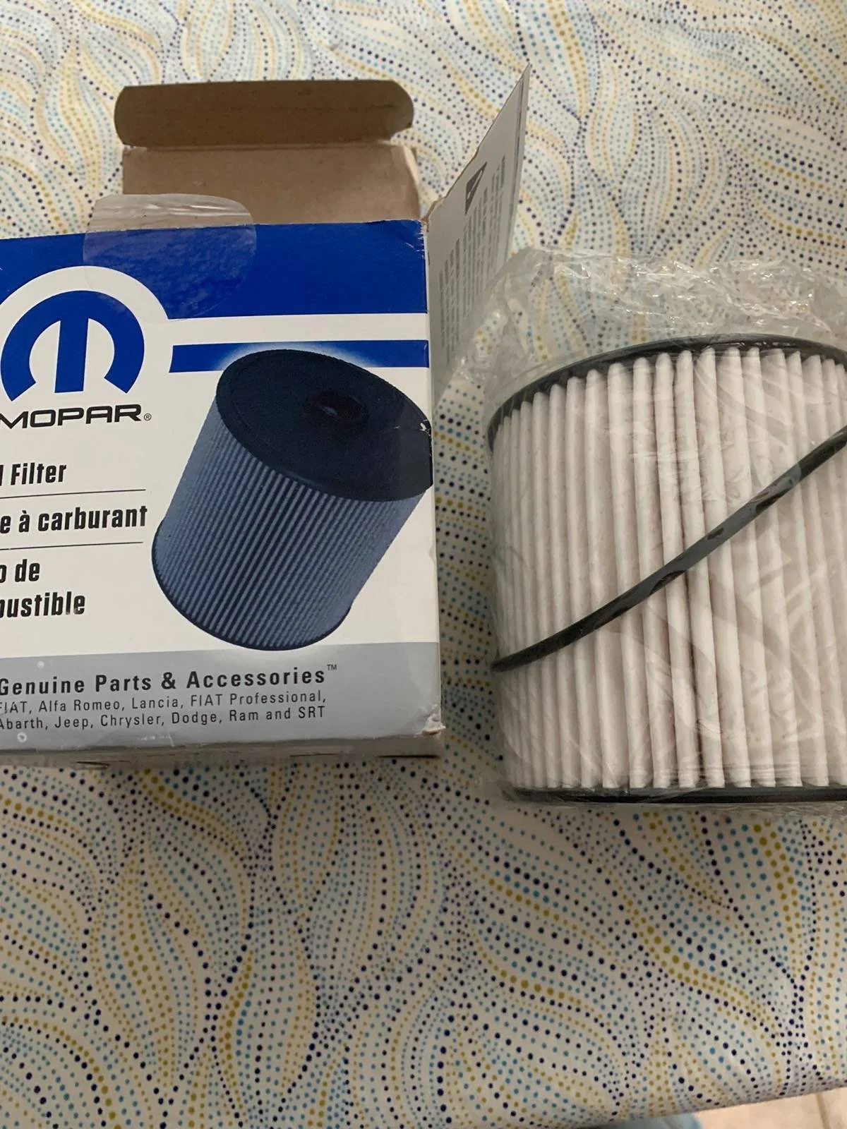

Does anyone know what color the Mopar fuel filter is?
I just replaced my original with an aftermarket one last week, when I took out the original filter it was colored gray, I replaced it with a $15 aftermarket one that was white, I immediately ordered a Mopar one just in case this aftermarket one failed, I just received the Mopar one and the box was opened with a white one, the box even shows a gray one!
Did I get scammed??

What did you pay and who did you order it from?

Amazon, it’s listed as “Genuine Mopar Filter Kit 68436631AA
$62.00
I’m just wondering if it’s the real deal due to the one I replaced was grey in color and the photo on the box is gray.

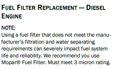

Interesting. It's surprisingly difficult to find the Micron ratings of filters to confirm compliance with the OM spec:
Jeep Wrangler JL Mopar Fuel filter or fake? 1712160614861-k1
From best I can tell, the Wix p/n at RockAuto does, but it means relying on a Q&A on O'reilly's.

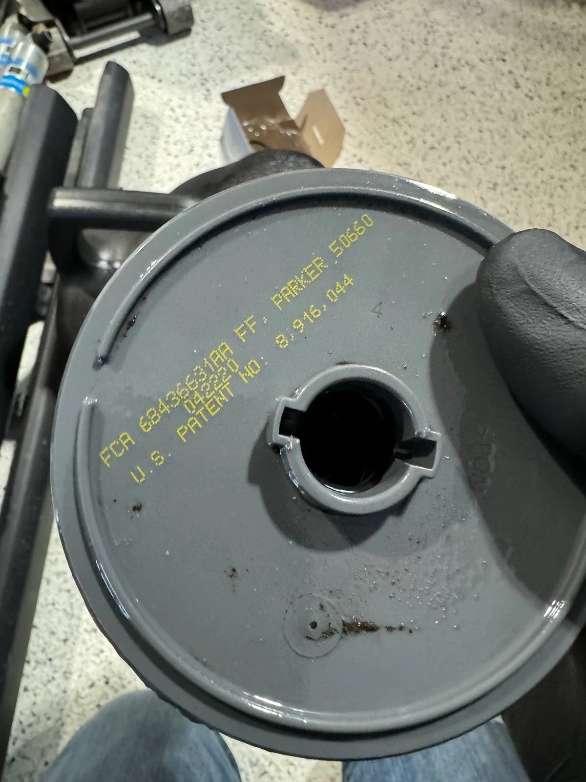

Appears to be genuine. If you reference my post from back in january (here.) the filter I pulled out looked like it had been in there damn near the life of the vehicle up to my point of ownership. Hard to really know for certain, but regardless you can see the stamping on top as well as the plastic color. When I purchased my new filter, I did the same thing, amazon original oem blah blah. It looked virtually identical to what you've got there. I've been running it now for roughly 2500 miles and haven't seen anything alarming or suspicious that would make me second guess it.
Edit: found another photo of the top. It’s not an EXACT match in terms of stamping, but it’s pretty damn close to what you’ve got. I suspect the stamp has changed in the couple of years since whenever the hell this filter was installed.
