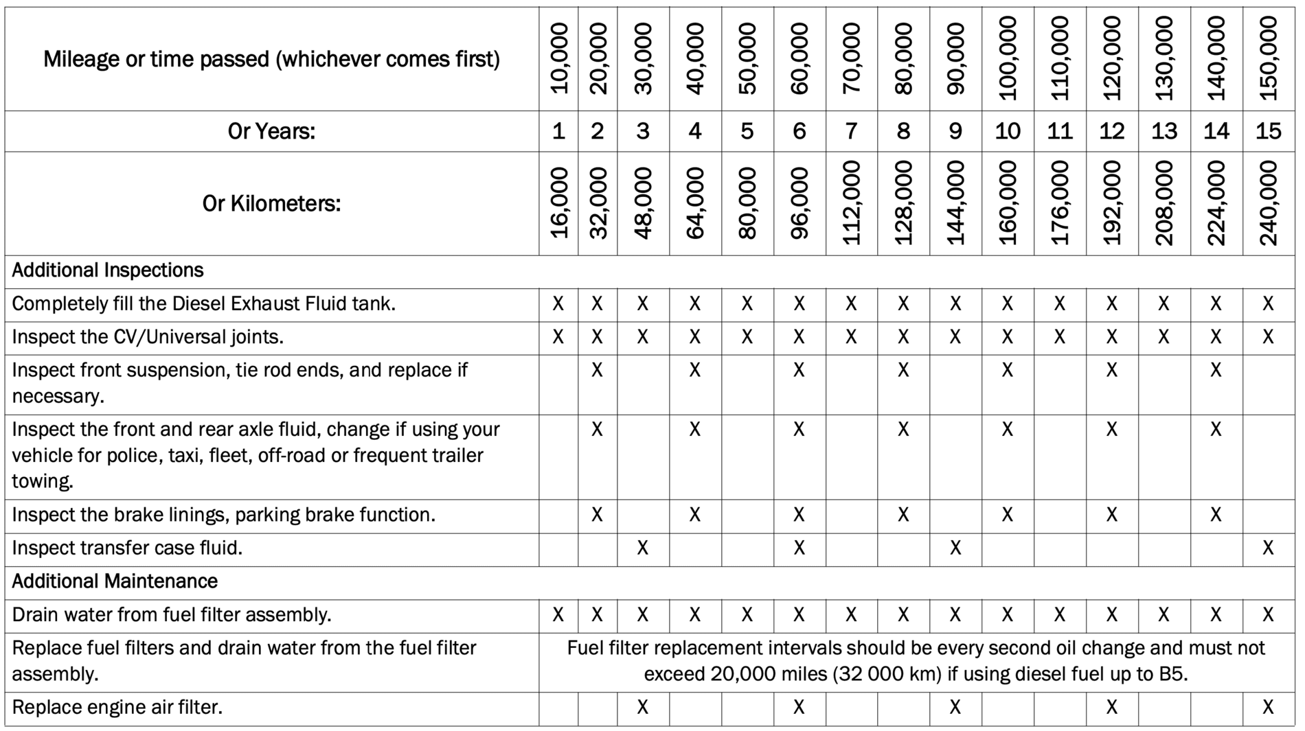

I'm just over 7000 miles on my ecodiesel and service manual says to drain the fuel filter at 10k miles and replace no later then 20k. Has anyone drained the water out of their fuel filter yet? From the looks of it, it doesn't appear to be to complicated but was wondering if anyone has crossed that bridge yet.
