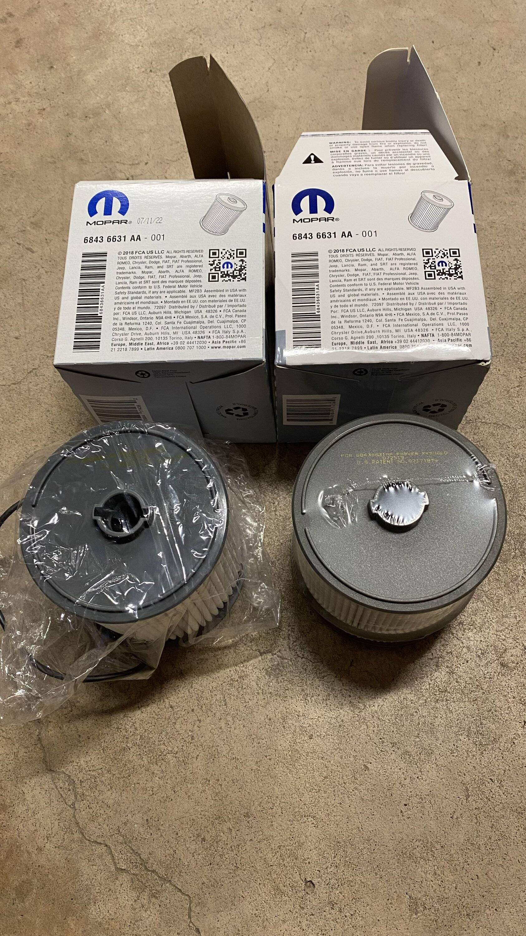

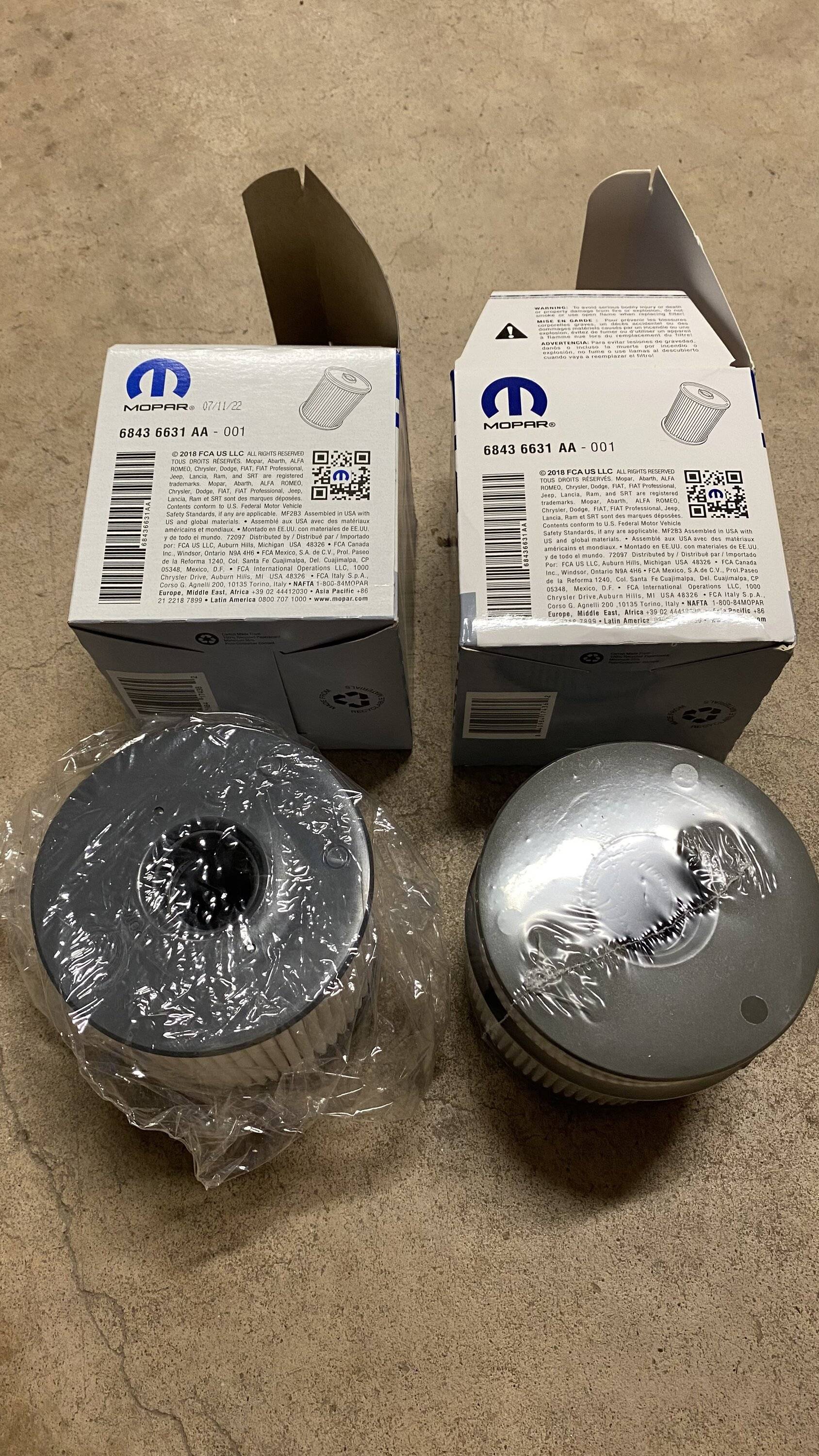

Does anybody here have knowledge of OEM fuel filters for the ecodiesel? Also fits ran diesel models. Filter on the left is from diesel filtersonline.com. Filter on the right is from an eBay merchant from California. They look similar, but have different filter, media and different colored plastic. There is no manufacturing date on the box of the discounted one from California. The discounted filter from the merchant in California was $20 apiece compared to 50 from diesel filtersonline.com.

Does the one on the right also have a manufacture date on it? Left does. Just wondering if they are far enough apart that maybe process could have changed a bit.

Well then I am going to say 072519 is a date code and is over 4 years old, probably why it is 20 bucks.

My point was, rather than try to validate the $20 Ebay filter, I'd assume it is counterfeit and pony up the extra $30. If your fuel pump fails (after the recall fix) the dealer will use the off-brand filter to beat you about the head & shoulders and deny your warranty claim. This falls into the if-it-looks-to-good-to-be true category.

The one on the right is a counterfeit filter. All genuine oil/fuel filters has pkg date on the box and comes in loose plastic bag for the oil and loosely shrinked for the fuel filters.
Also, the genuine filter media has that cotton like texture and the pleats are usually ugly looking too ?
