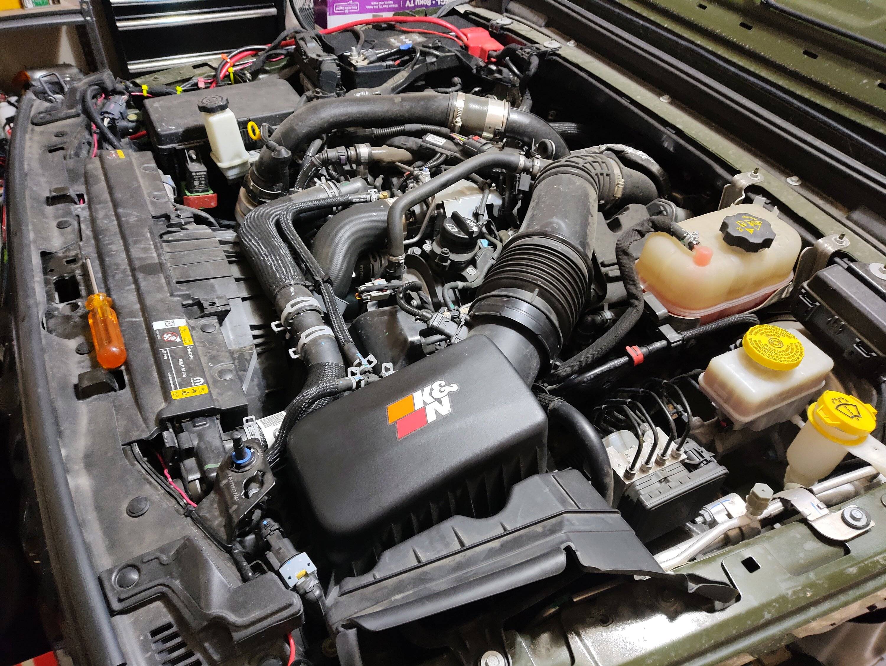

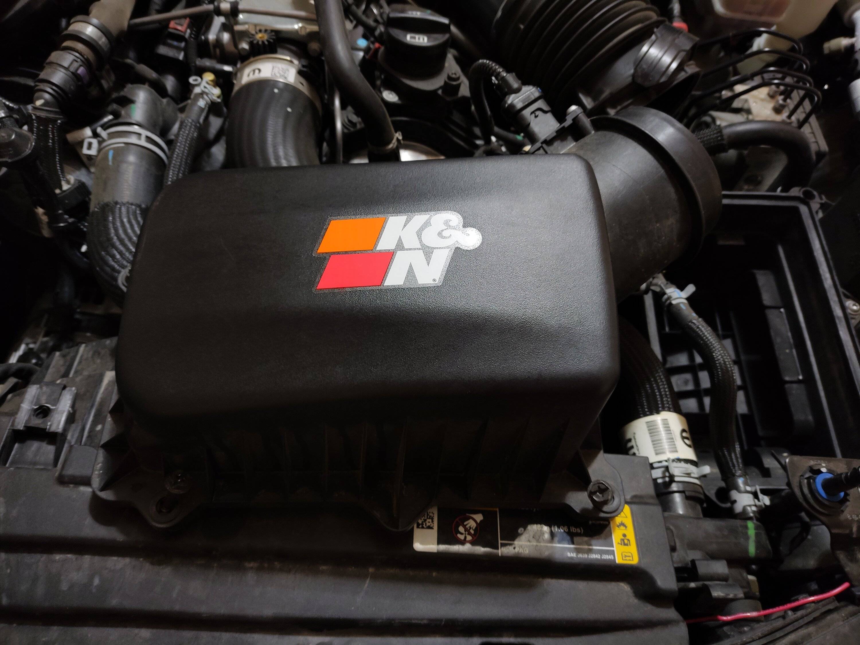

Installed my K&N air filter last night
Jeep Wrangler JL Mopar air filter quality is so bad IMG_20230218_170159786
Jeep Wrangler JL Mopar air filter quality is so bad IMG_20230218_170254762
Jeep Wrangler JL Mopar air filter quality is so bad IMG_20230218_171012584
Zero issues with it so far. If anything I'd honestly say it has improved air flow. I always felt like the OEM air filter and pre-air filter were choking out the engine. Without doing a dyno test before and after, I can't honestly say that it's improved engine efficiency, but when I drove it 10 mi yesterday it felt like it was smoother running and maybe even a little more responsive from the pedal. Could just be my imagination, but I'm really happy I did this so far.
