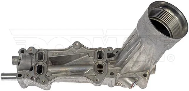

A few pics help, so the seals in question are shown in this pic (an aftermarket aluminum housing, but a copy of the Mopar design):
Jeep Wrangler JL Mods please delete 1726588322936-hu
Those figure 8 seal channels are where seals can blow out and allow coolant and oil to mix. Edit: These have been revised on the current Mopar plastic housing. Anyone with a 3.6 should avoid the aluminum housings IMO.

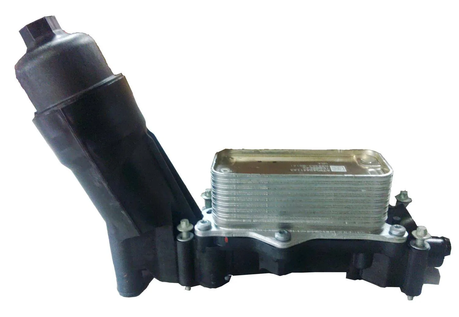

This is what the Mopar unit looks like with the cooler installed
Jeep Wrangler JL Mods please delete 1726588368449-h7
This sits right at the front of the engine in the valley between the heads. When it goes you end up with coolant and/or oil leaking into the engine valley and don't usually catch it until it starts coming out over the back of the engine and down the transmission and all along the underside of the Jeep.

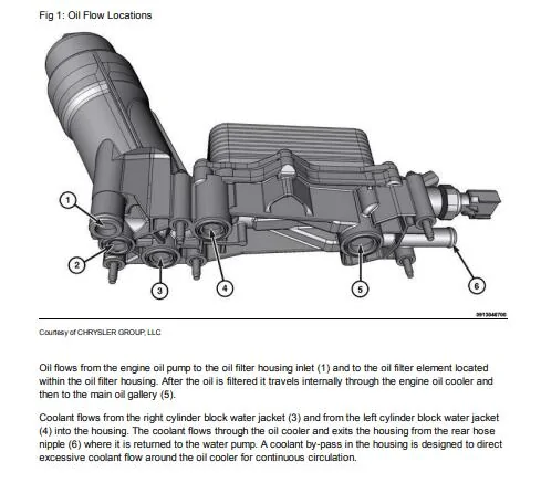

Jeep Wrangler JL Mods please delete 1726588454459-ul
There are other seals along the bottom that tie into the engine oil and coolant galleries that can let go as well
