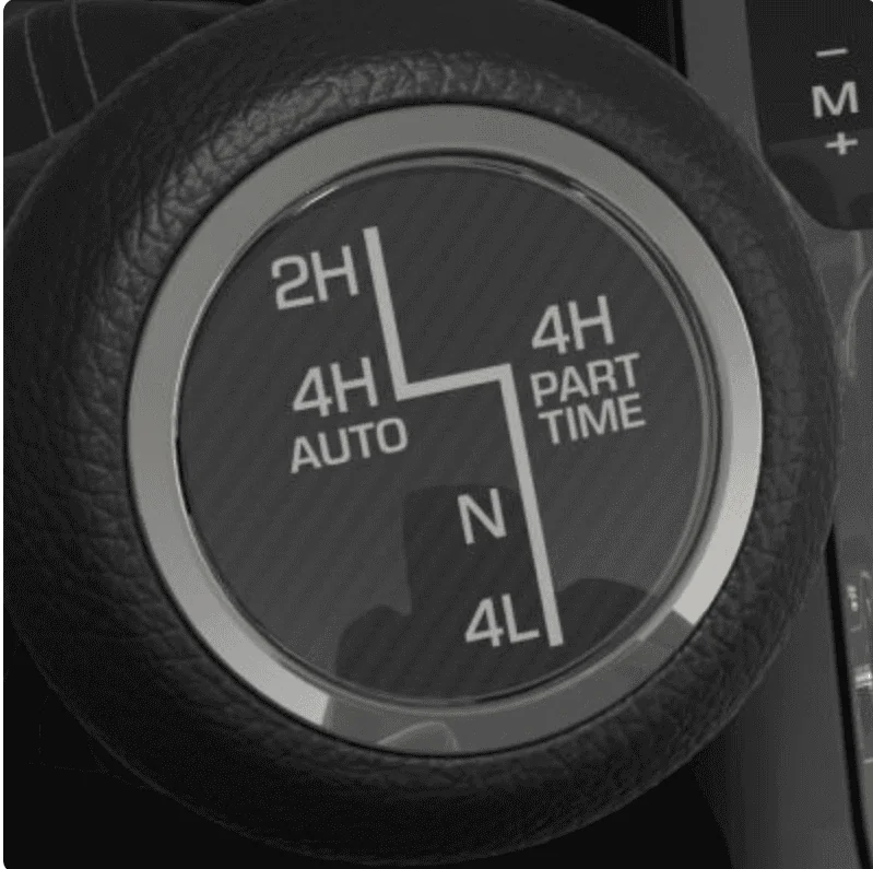

The Selec-Trac shifter has 4A and 4H at the same level; a little nudge to the left engages full-time; a little nudge to the right engages part-time.
Once in awhile the transfer case slips from 4A into 4H. It happens backing up; I can tell something’s off because the steering starts binding. I look at the transfer case display in the IP and it shows no selection. I have to push the shifter into 2WD and then back into 4A.

This is the shift pattern on Selec-Trac

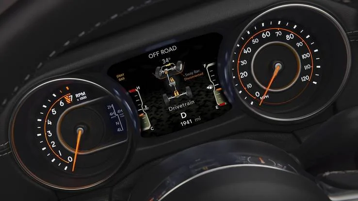

When Selec-Trac is engaged in 4A, the 4H Auto lights up on the dashboard transfer case display. When it slips out of 4A and into 4H, the display shows no selection —like on photo below.
