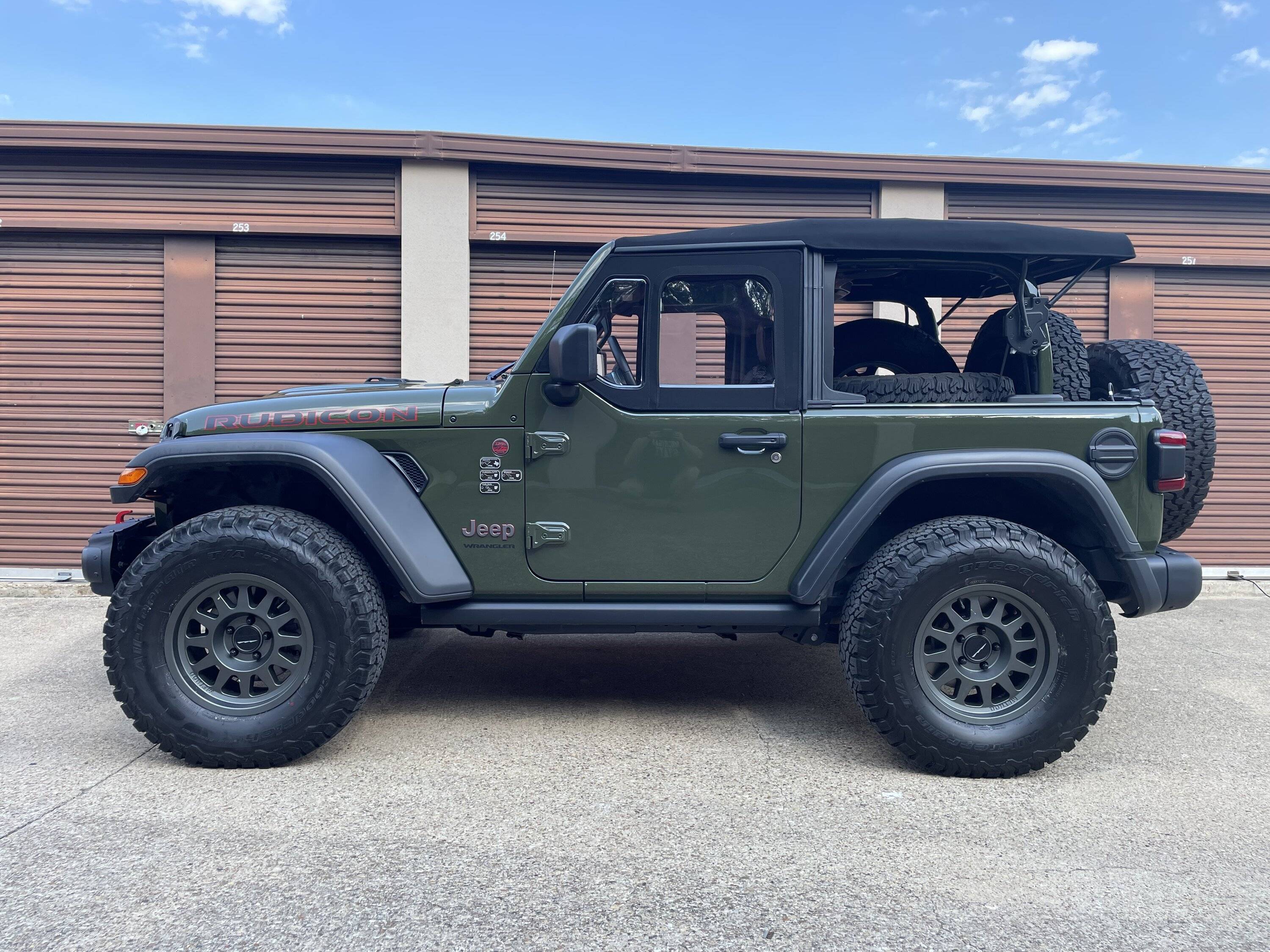

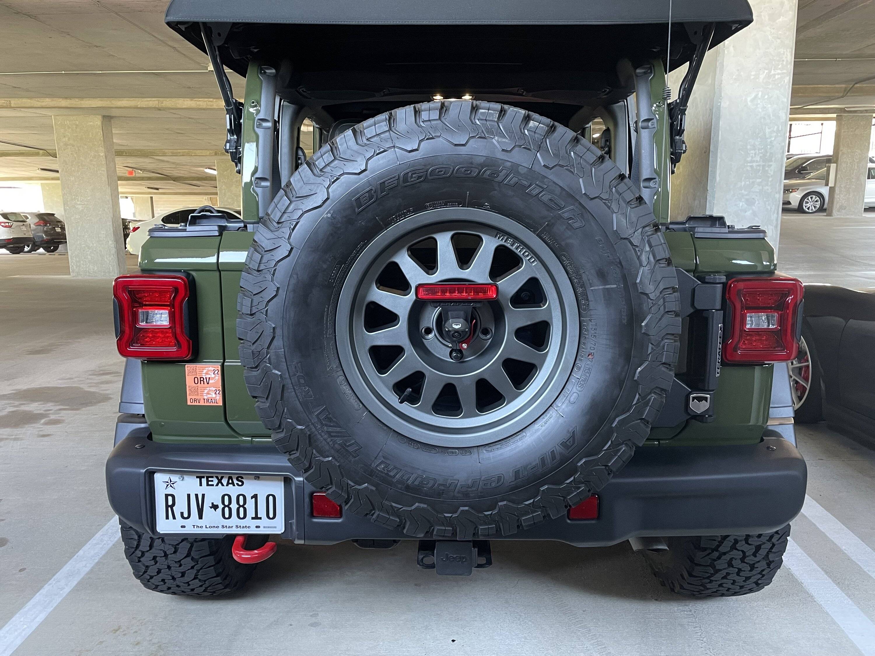

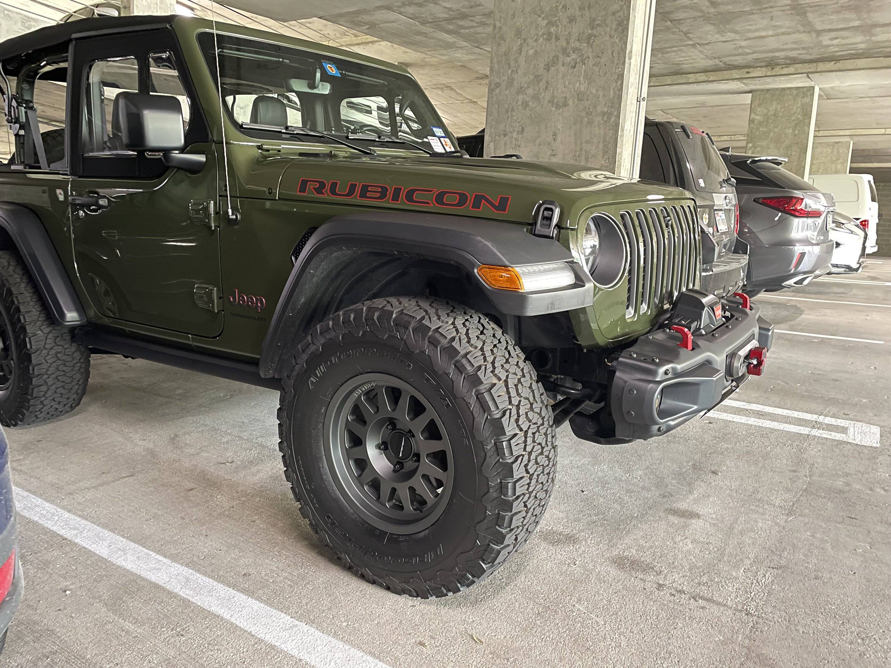

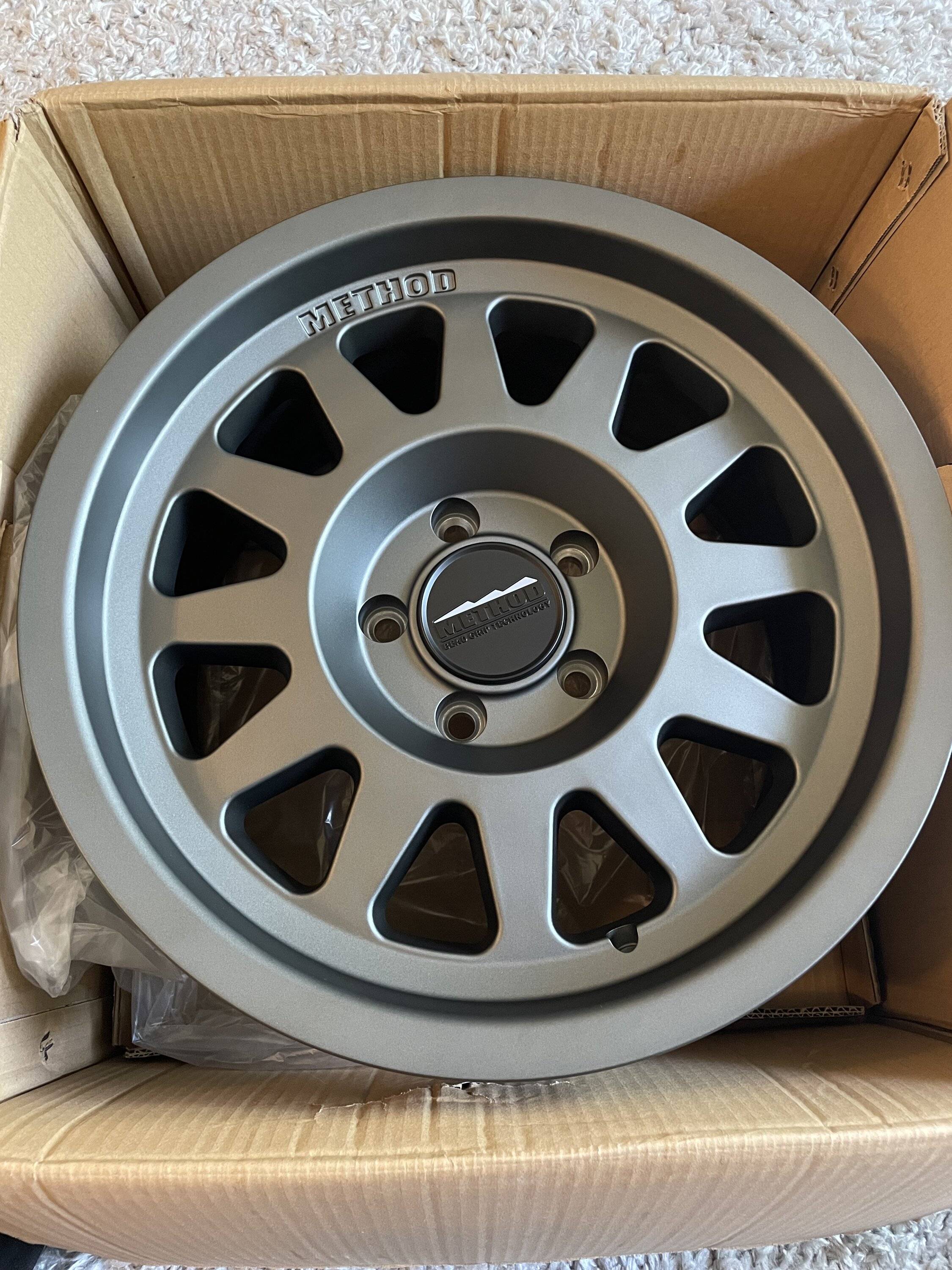

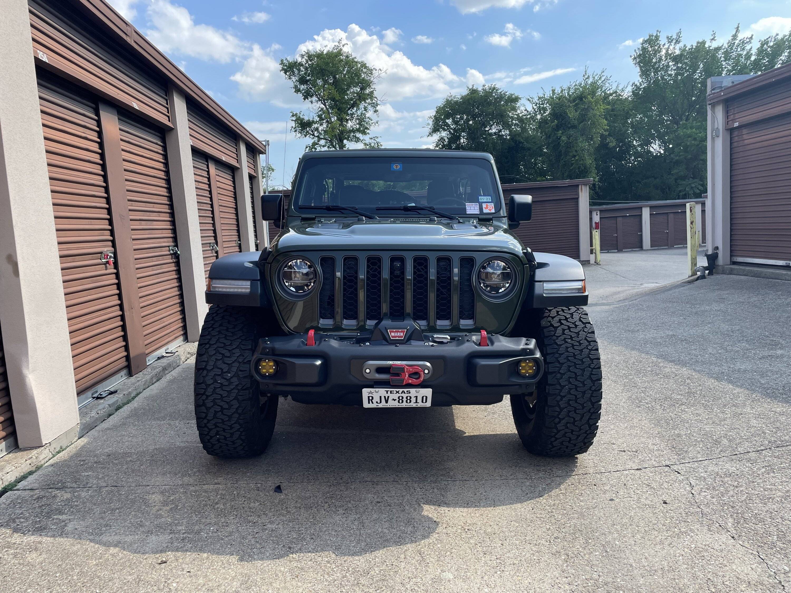

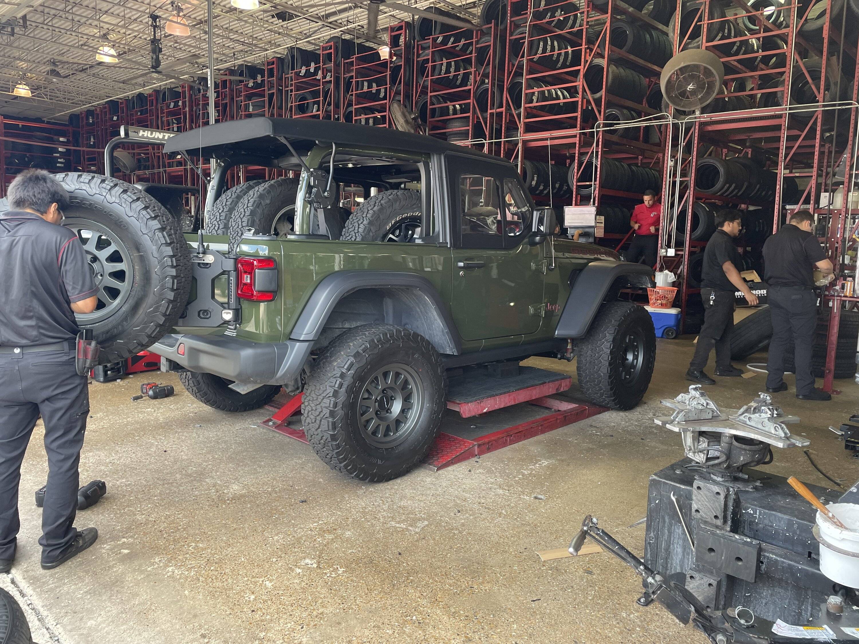

Hey everyone!
There is surprisingly little to go off of when it comes to these wheels so I thought I would make a thread for anyone else looking at Method 704's or any of the other 700 Series (Bead Grip) options.
I purchased 17x8.5 Method 704's in Matte Titanium with 4.75" of backspacing (0 offset). I paired these with a set of XR take-off KO2's (315/70r17) on the stock Rubicon suspension. A 2.5" Metalcloak Gamechanger is planned, but I have yet to find a convenient time for my Jeep to be down for a couple of days.
Wheels weigh ~35 pounds, so not the lightest option, but not quite as heavy as a bead lock. I will update this thread when I get to test the Bead Grip tech, but many others have written about that and had good things to say.
This particular wheel is only available in black or Matte Titanium. I like black for touch ups, but really wanted the matte titanium as it adds a little dimension and almost perfectly matches the gray grille inserts and headlight bezels on Rubicons.
I've attached some initial pics, but will update with more tomorrow! Also, feel free to ask questions or for a specific photo/angle to get a better idea of stance!

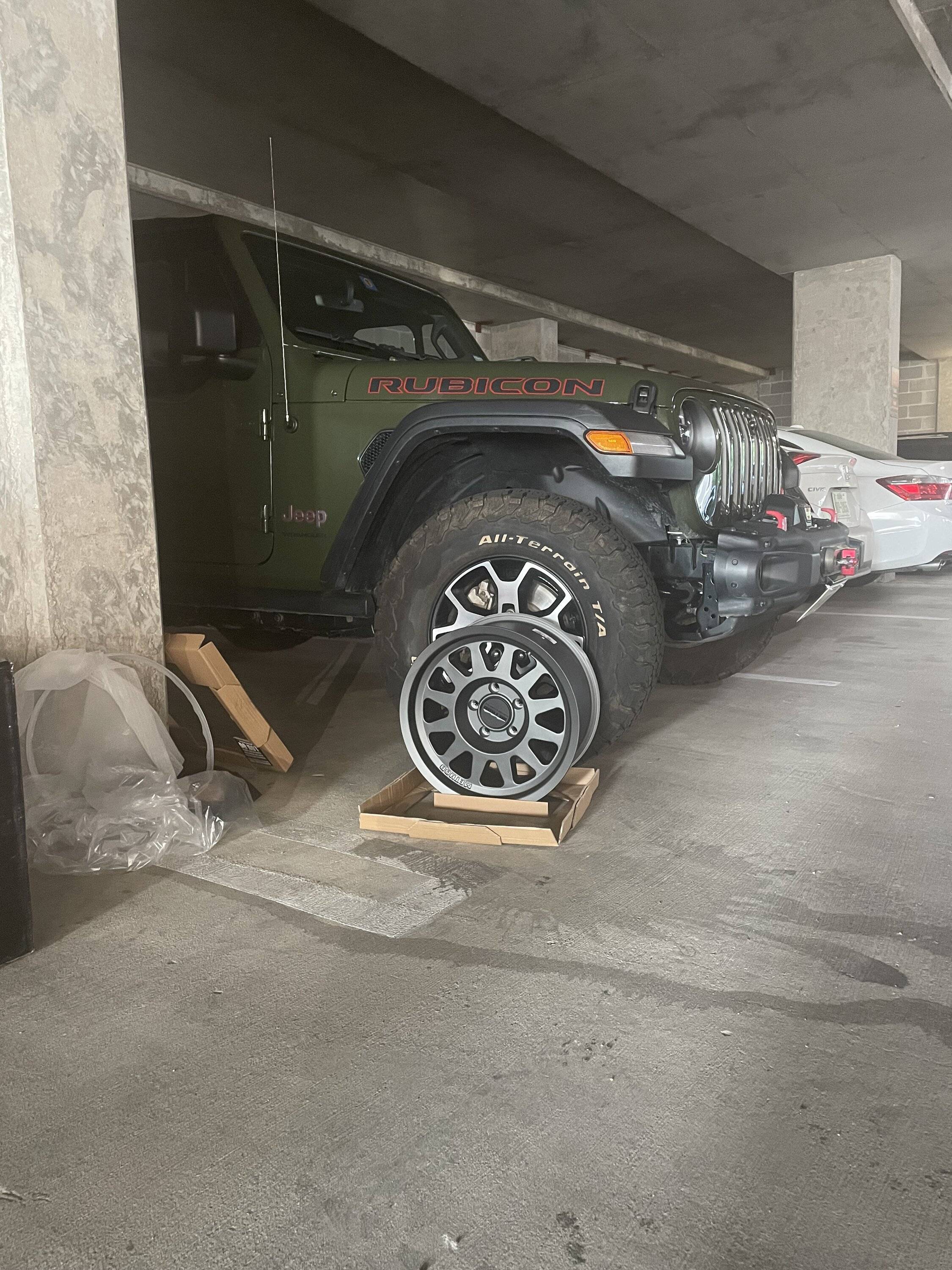

Thanks! And no problem! This is exactly why I created the thread. I have only seen 2 other forum members with these wheels and neither has a build thread or posted more than a random picture or two.
Here’s a pic before I mounted everything where you can see the headlight bezels and wheel. I will try to grab another when the sun comes up now that everything is mounted.
Not exact, but close enough in my opinion.

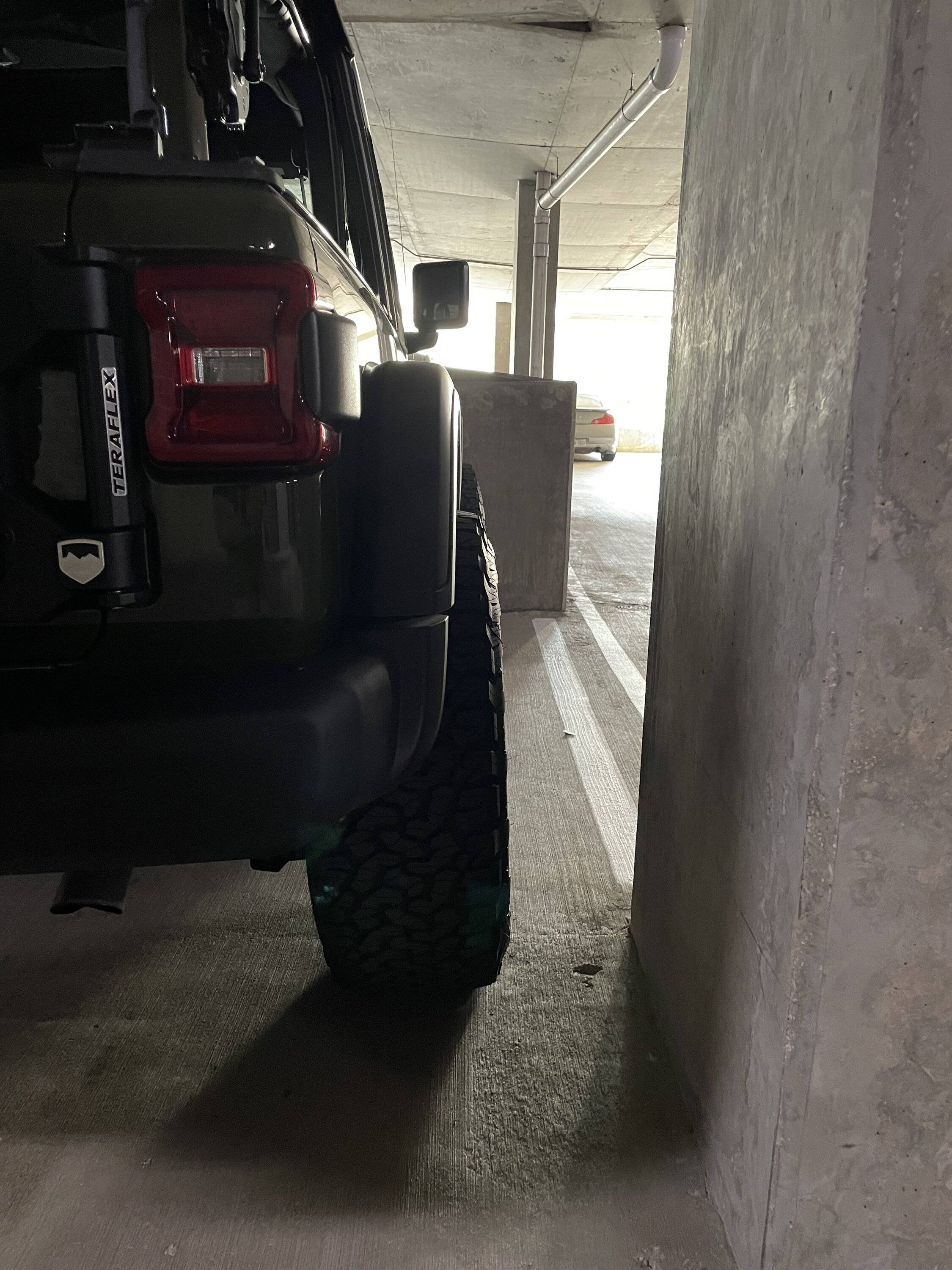

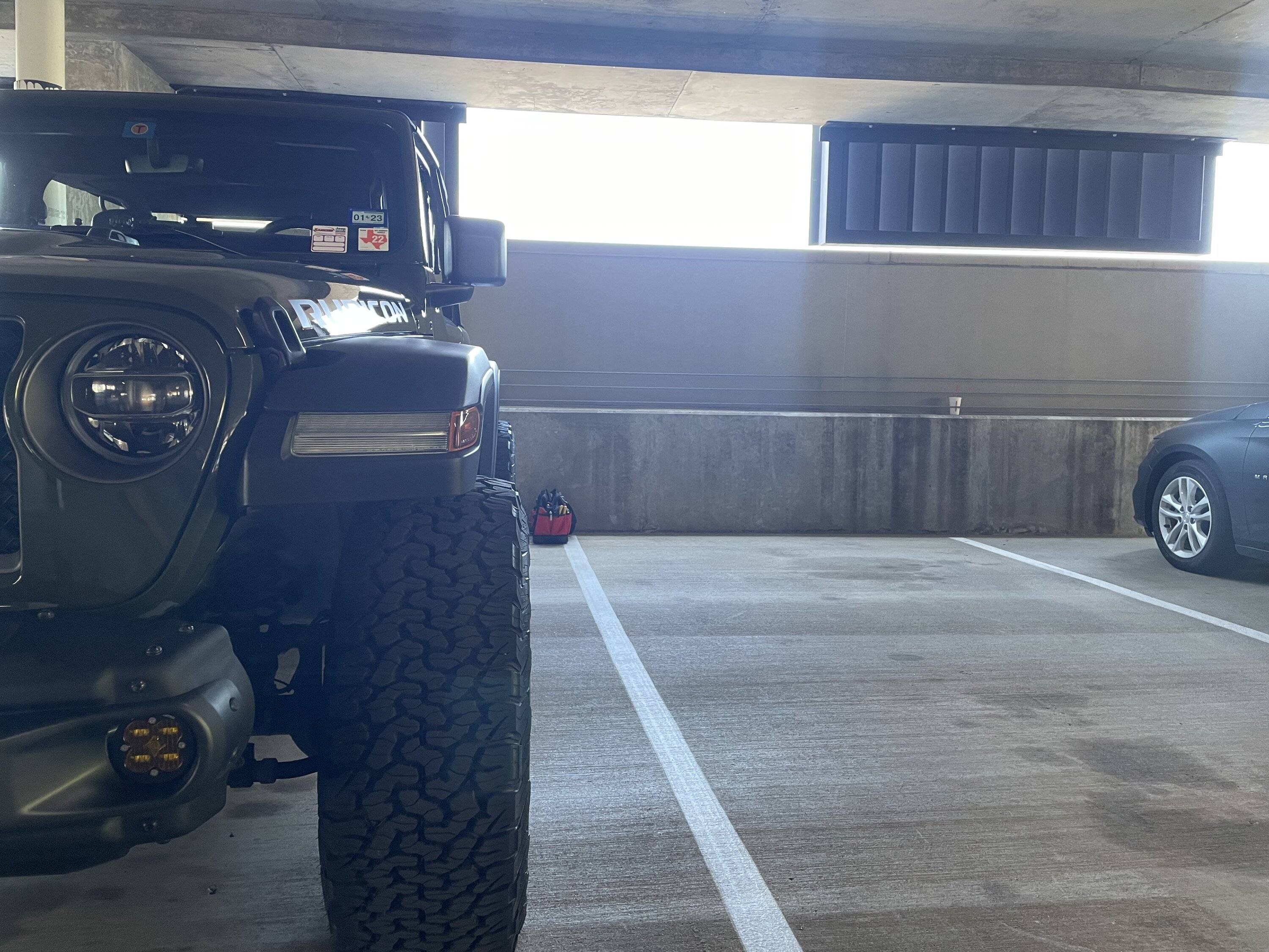

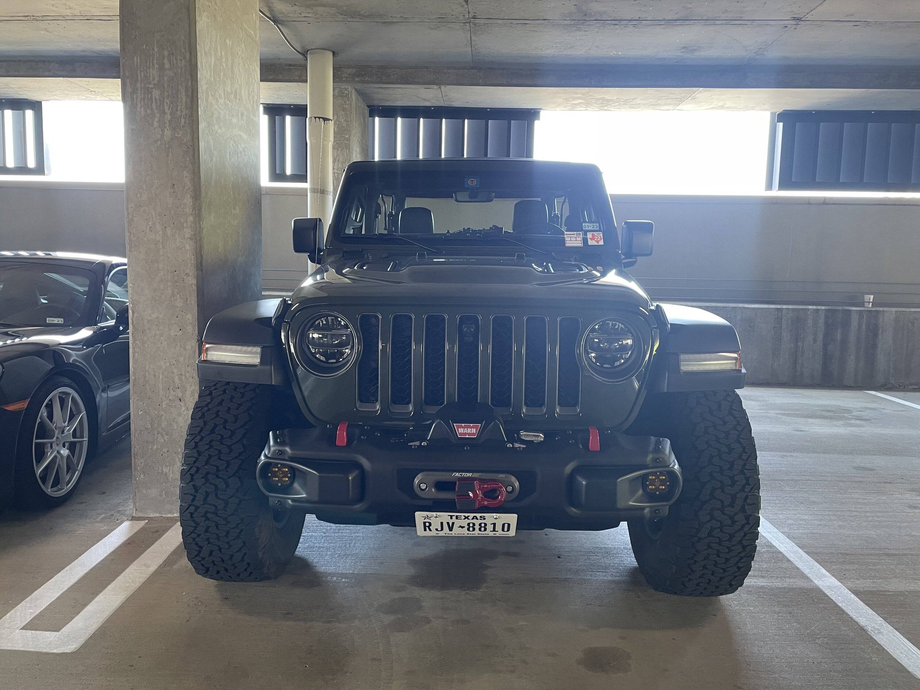

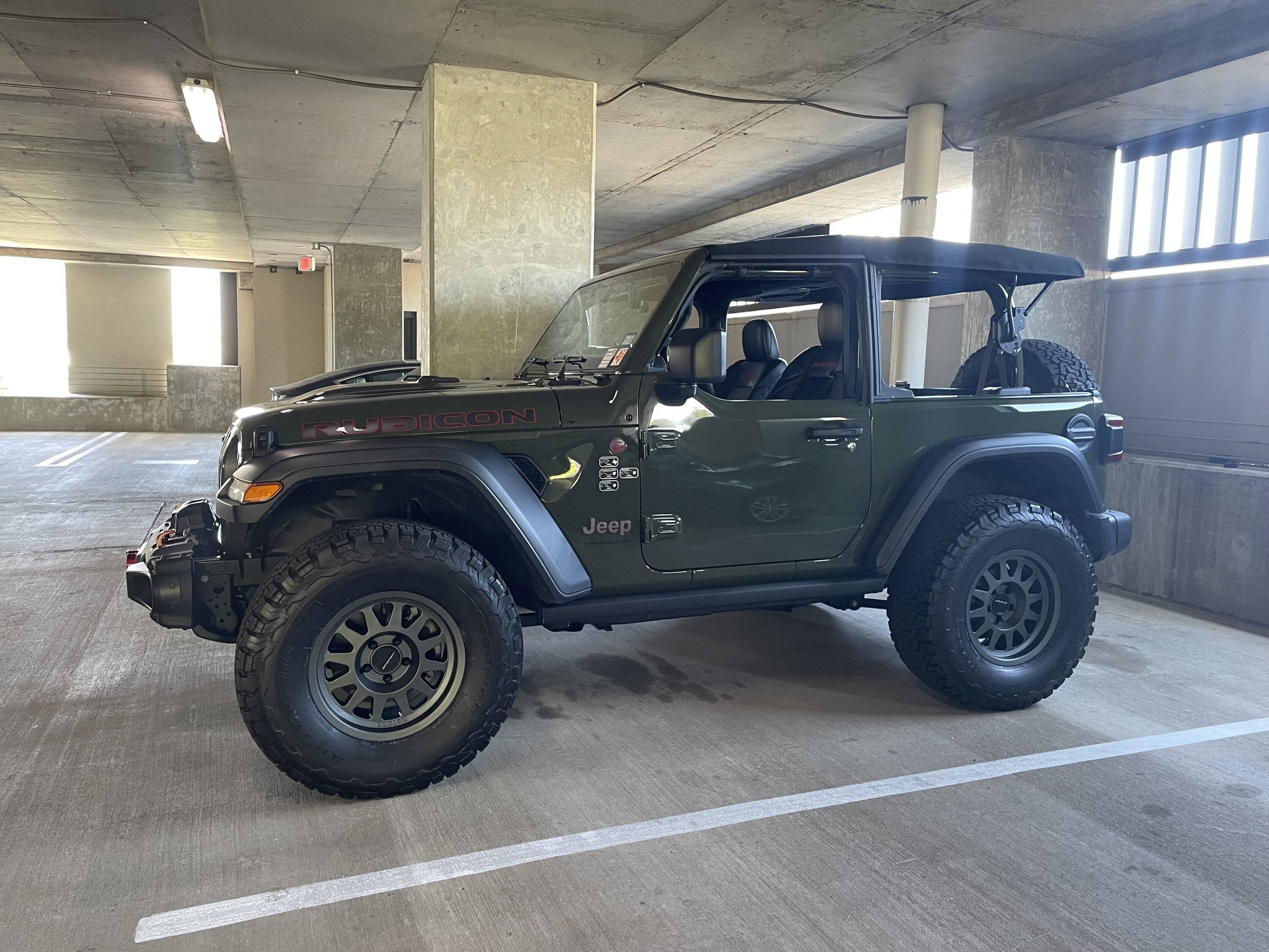

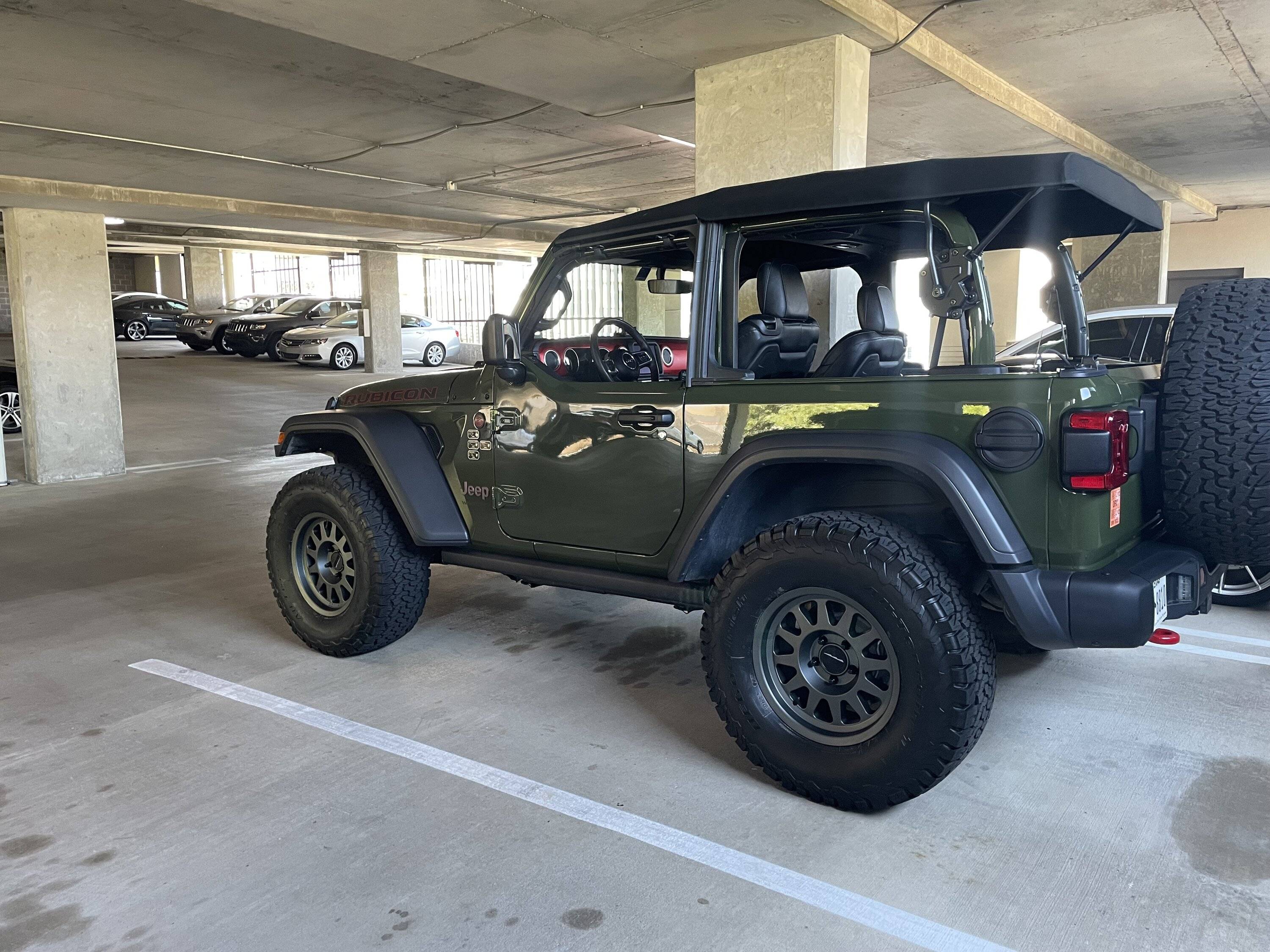

Took some more pics! I need to get out in the sun and off road now!
In these pictures the Jeep is on level ground and the steering wheel is perfectly straight to try and give another look at the stance with 35's and 4.75" backspacing on Rubicon axles.

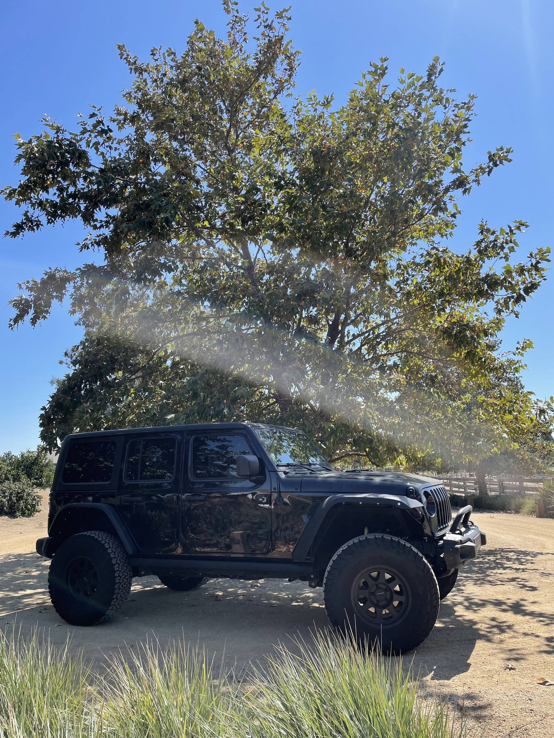

Nice looking Jeep! I love this look with the half doors and safari mode.

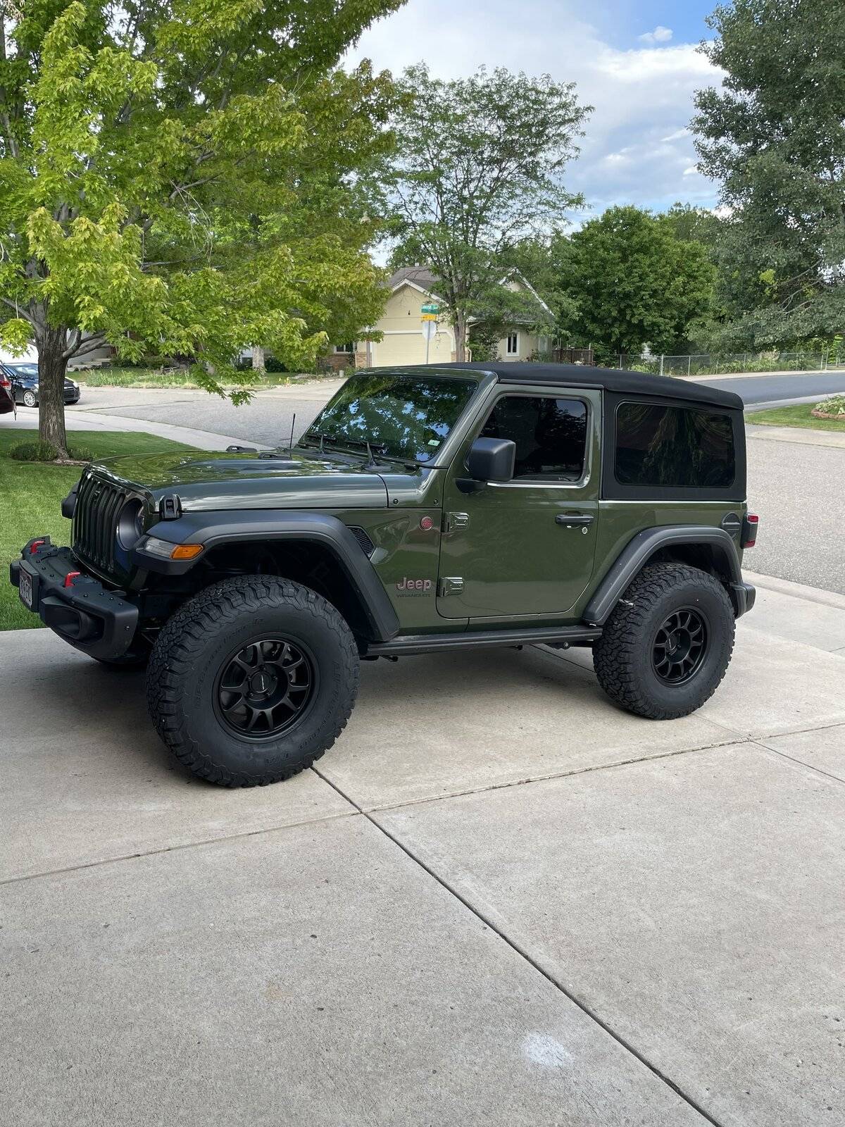

Looking good!
I'll throw in a couple of pics of my 702's just to round out the full picture.
First pic here is on stock suspension, second is with XR springs and shocks. Ended up with just under 2" of lift from the XR bits.
