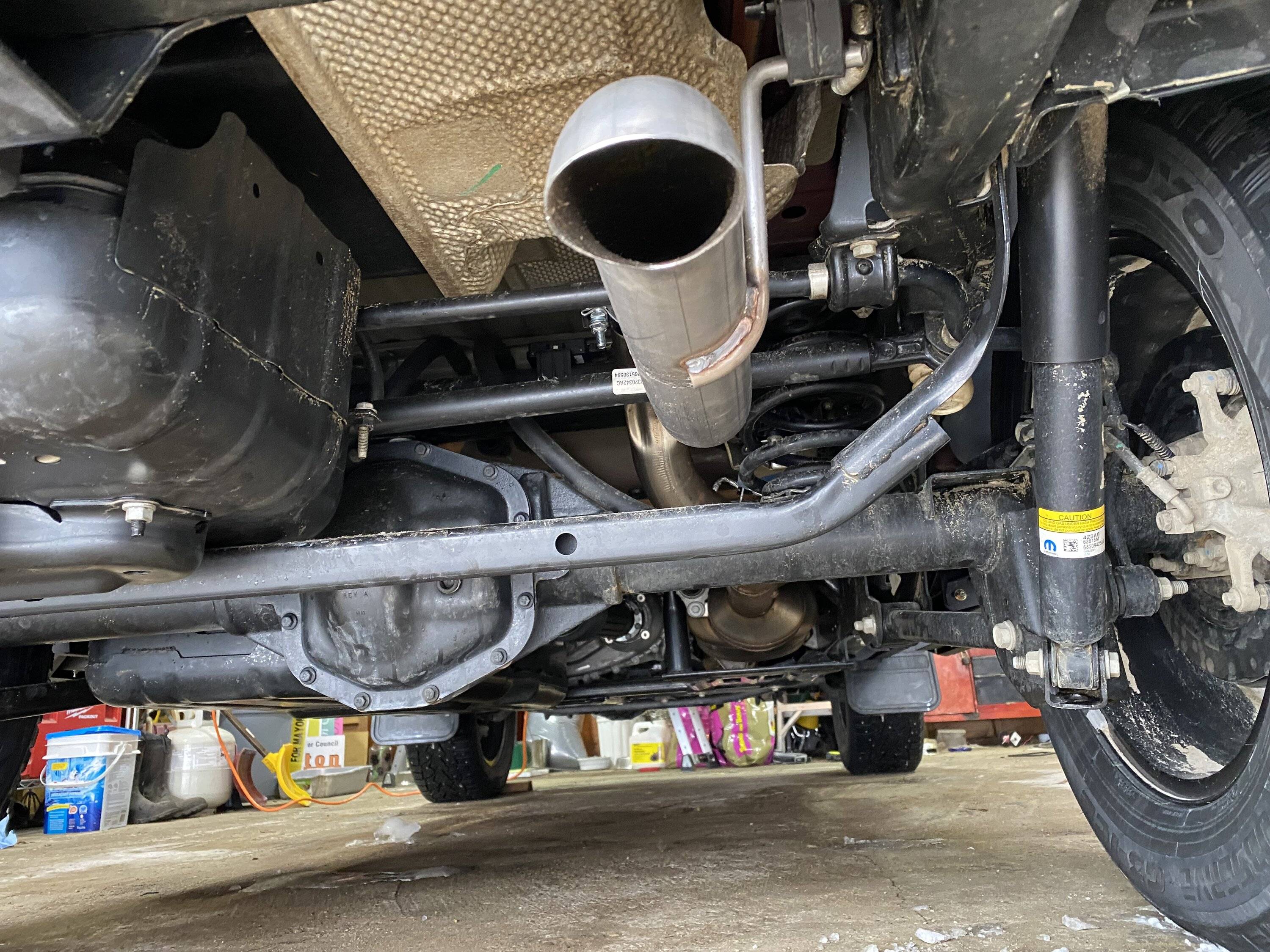

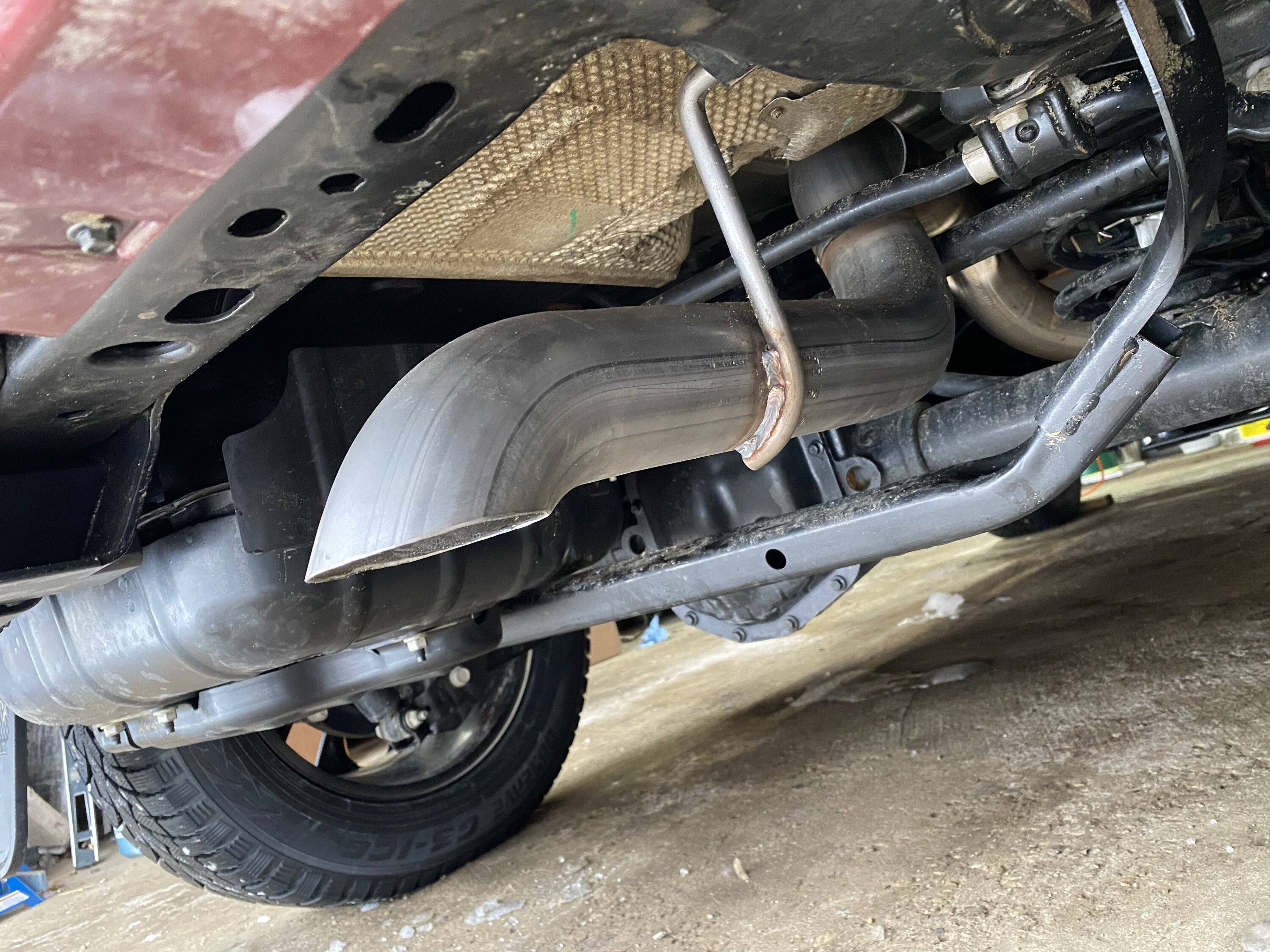

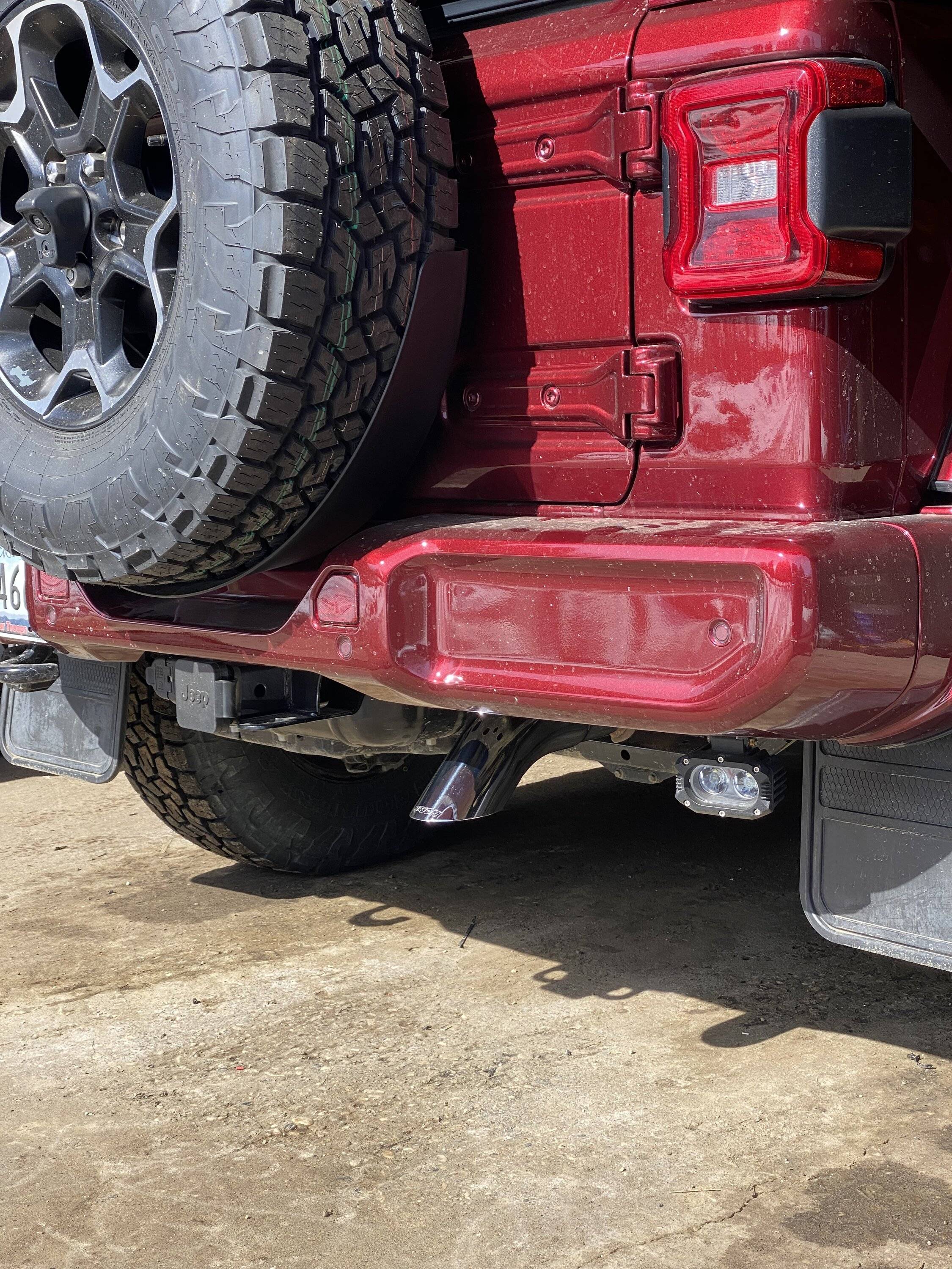

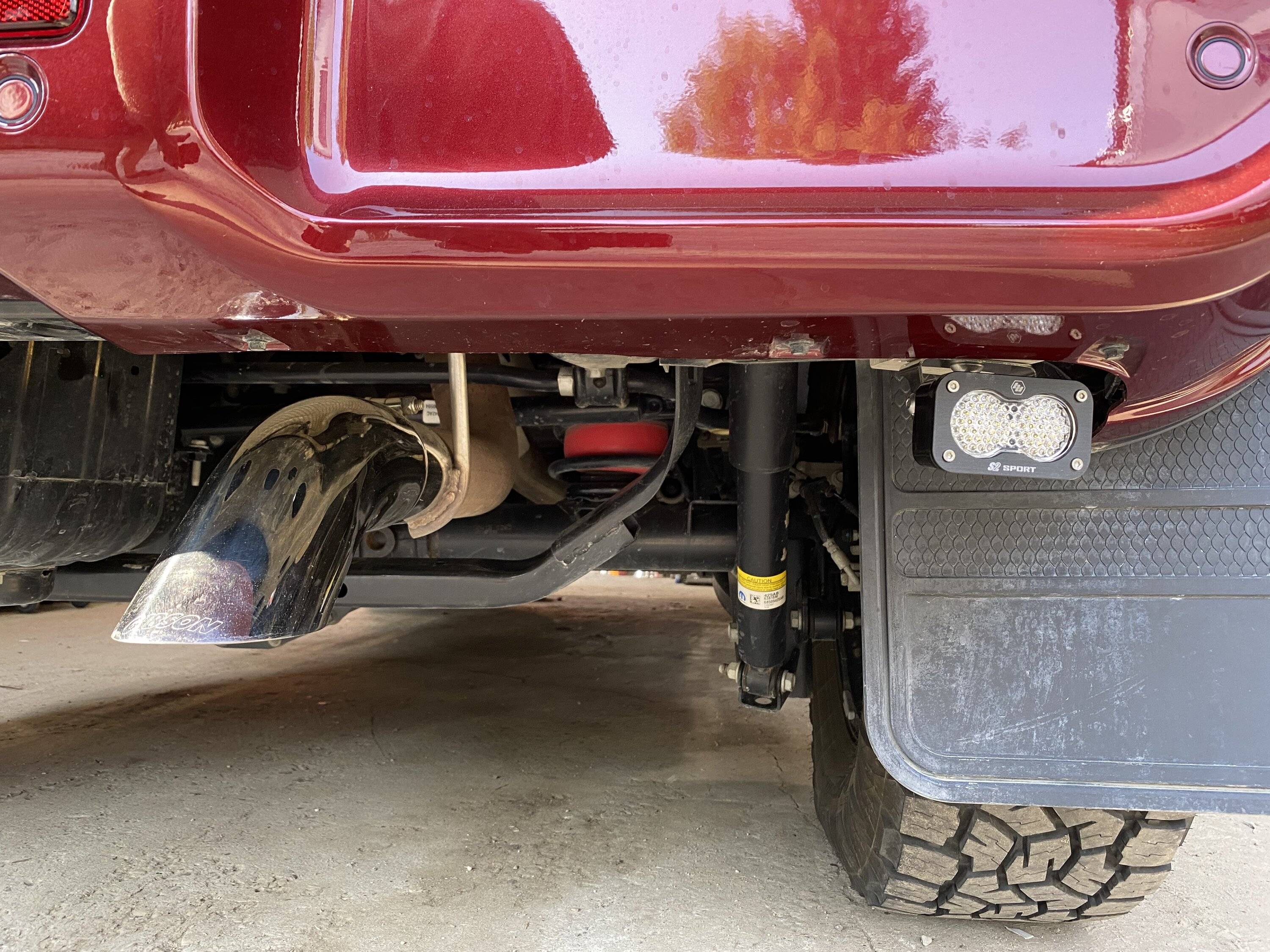

I’ve got one. No sound change at all, no performance change at all. It does create space for an air tank.
My JLU is stock otherwise, no fitment issues. I then added a stainless tip.

Would you be so kind as to measure how much distance there is between the exhaust and your DEF tank? These photos are really helpful, I appreciate it!!
Sure, when I get it back from the dealer. It’s at the body shop for tailgate paint issues?, again. Hinges in fall of 22, now the tailgate itself ?
