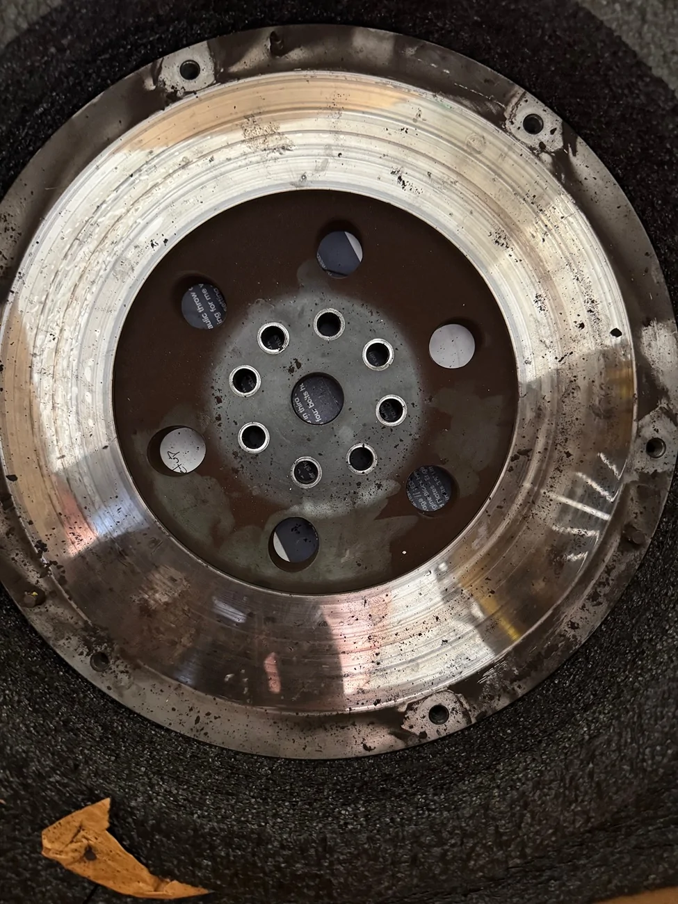

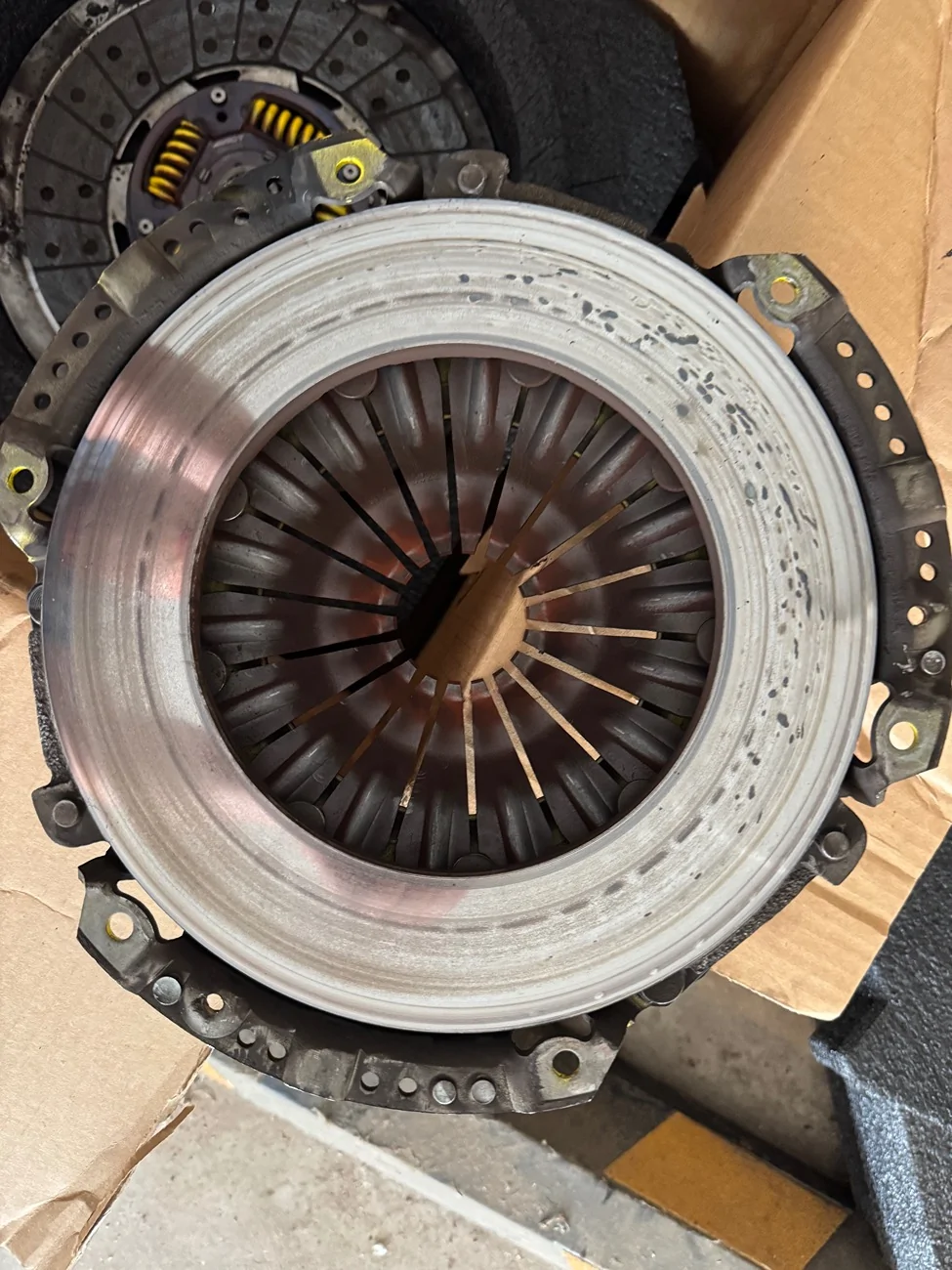

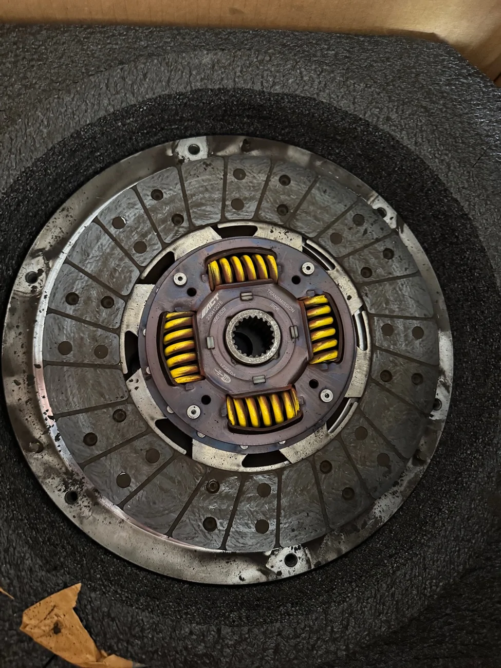

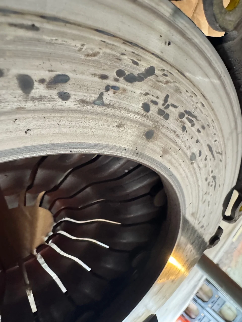

Pictures of my ACT.
Jeep Wrangler JL Manual Transmission - Issues shifting into 1st & Reverse (Compilation thread) IMG_3357
Jeep Wrangler JL Manual Transmission - Issues shifting into 1st & Reverse (Compilation thread) IMG_3356
Jeep Wrangler JL Manual Transmission - Issues shifting into 1st & Reverse (Compilation thread) IMG_3355
Jeep Wrangler JL Manual Transmission - Issues shifting into 1st & Reverse (Compilation thread) IMG_3354
JeepinPete
Pete
Jun 18, 2020
466
628
PA
'19 Mojito JLUR
Mechanical Engineer
In that last picture, the marks between 12 and 3 look like heat marks (assuming that isn't dirt). That would indicate the clutch wasn't releasing evenly and was dragging in that quadrant.
Yup. It was definitely dragging. Toward the end I was frequently getting stuck in reverse, and Jeep would move in first or reverse with pedal to the floor. Overnight vacuum bleed would help for a trip or two, then the symptoms would return.
There was no incorrect grease/lube on input shaft, fork, or bearing. Mechanic took pictures. No friction material dust.
I know ACT vehemently disagrees, but stock hydraulics are not up to the task of moving their heavier components.
