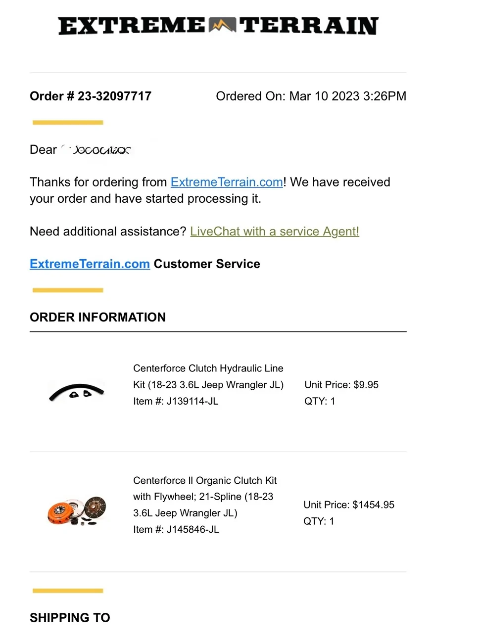

Order Summary:
Item(s) Subtotal:
$1,539.95
Shipping & Tax(If applicable) :
$97.79
Total Charges:
$1,637.74
Pulled the trigger on CFII with hydraulic throw-out. Found a shop owner/tech (one man operation) nearby that does a lot of Centerforce installs. He’s familiar with the JL.
Fingers crossed. I hate banking on a mechanic I’ve never used, but my guy retired. I did meet him in person and had a long conversation. He seems knowledgeable, and his reviews are stellar. He was finishing putting a CF in a Mustang when I arrived. Has one in his personal Challenger. Found him via another popular (big) shop who very honestly said, “Go see Todd down the road. We send him all of our transmission and engine swap work.”
I just can’t see paying to have transmission dropped, input shaft cleaned, maybe replacing plastic throw-out, and then just hoping the ACT would be normal for another two years before doing it all again. Not much more labor cost to put in a better solution.
Breaking point was on Monday. Started Jeep in garage while it was in reverse. I’ve done that every day for 7 years. This time it lurched and started moving with the pedal buried in the floor. Clutch no longer disengaging fully. Did a vacuum bleed and it was better the next day, but I’m over it.
I’ll report back with results in a couple of weeks.

Happy to hear that! This is the kit I ordered:
https://www.centerforce.com/i-30500...ne-fits-jeep-gladiator-and-wrangler-3-6l.html
This kit further utilizes the Centerforce Internal Hydraulic Bearing Upgrade. The factory Jeep hydraulics package has a vague clutch pedal feel that many enthusiasts dislike, where there's not much pedal feedback as the clutch is engaged and disengaged. Our internal Hydraulic Bearing Upgrade simplifies the clutch actuation system by replacing the external slave, clutch fork, pivot ball, throwout bearing, and bearing collar with a simplified hydraulic concentric bearing that acts as the throwout bearing and slave all in one compact package. This kit provides a more traditional pedal feel that Jeep enthusiasts are accustomed to along with eliminating potential sources of rattles, especially as the vehicle ages.
