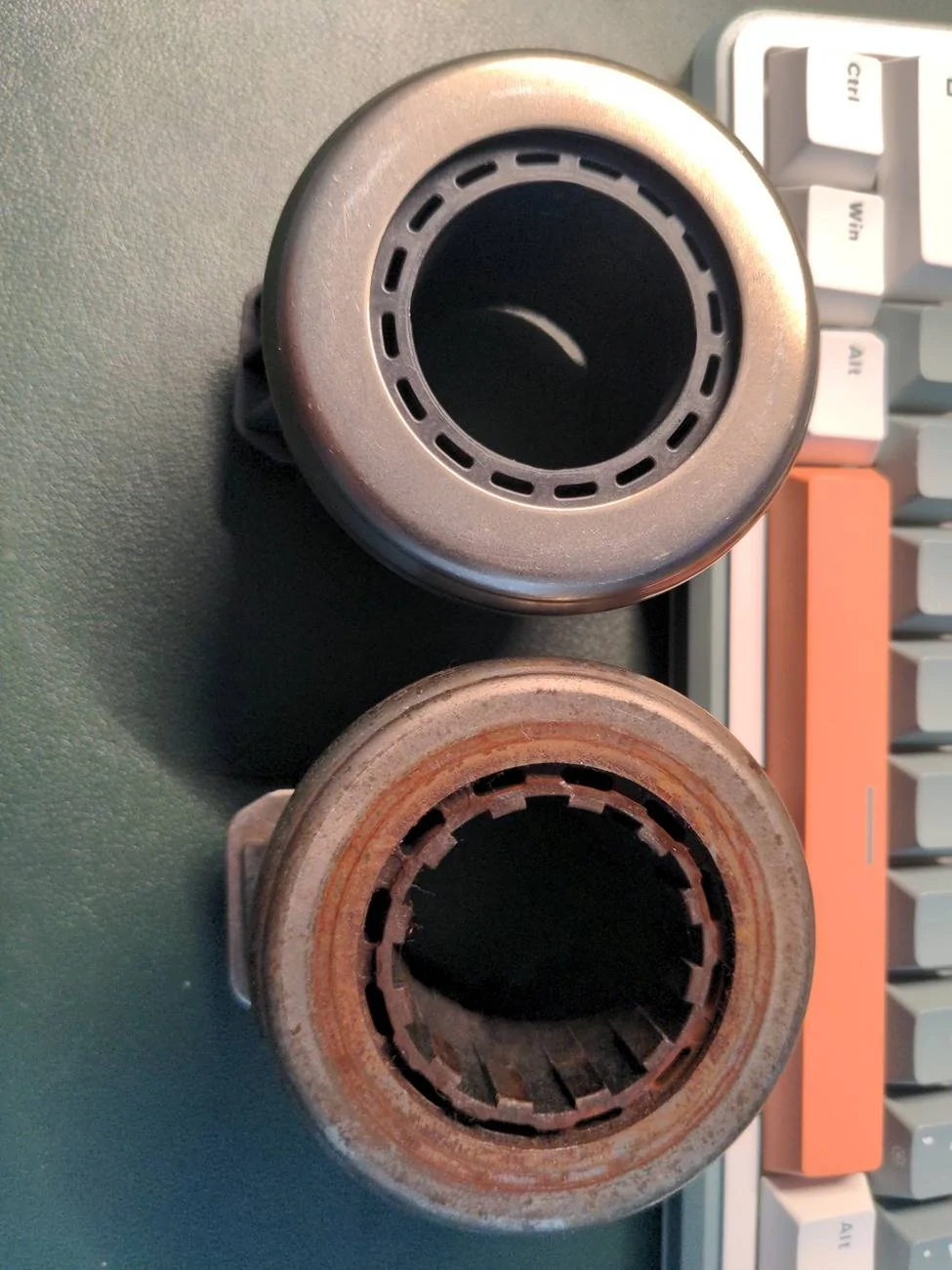

My personal opinion is that the ACT clutch is no different than many other designs. Nothing really strange or new about the basic design. I think the extra force required to actuate the clutch is revealing weaknesses of OEM actuation system.
I 100% agree with everything you said and share the same opinion on this situation. Due to the complexity of the issue where more than one factor is likely at play, resolving it properly would require a test rig and active effort to identify root causes. ACT seems like doing fuckall about this, and their customers are clearly being used as the test rig. Reading all this “ACT magic grease” nonsense makes me think ACT is paying people to derail the thread until the problem either resolves itself or quietly disappears.
FYI, the pushrod on the Centerforce slave is metal, and there’s a report of the slave body breaking where the pushrod exits. That could suggest the combination of added resistance from the pressure plate + contaminated grease + heat expanding metal and plastic creates the perfect failure package.
I did asked ACT directly whether there a chance their pressure plate is too much force for stock slave, and if not the main issue, then at least a significant contributing factor to shifting issues. Their answer was "no". Additionally, hopefully i am not imagining this, either ACT or someone else said that amount of force directed at the center of pressure plate to release is not much.
There is also a good chance ACT pressure plates are inconsistent from one unit to another. I recently test drove another Jeep with an ACT kit installed, and the clutch feel was night and day compared to mine. It was slightly heavier than OEM, but very tactile and effortless. Mine, on the other hand, has always felt heavy and required extra muscle on the pedal.
Difference in TOB designs had be thinking if smooth surface of ACT design could be creating a "vacuum" like effect when it is packed with grease and slides on the guide. On other hand, i don't think the tolerances are that tight there to cause it.
