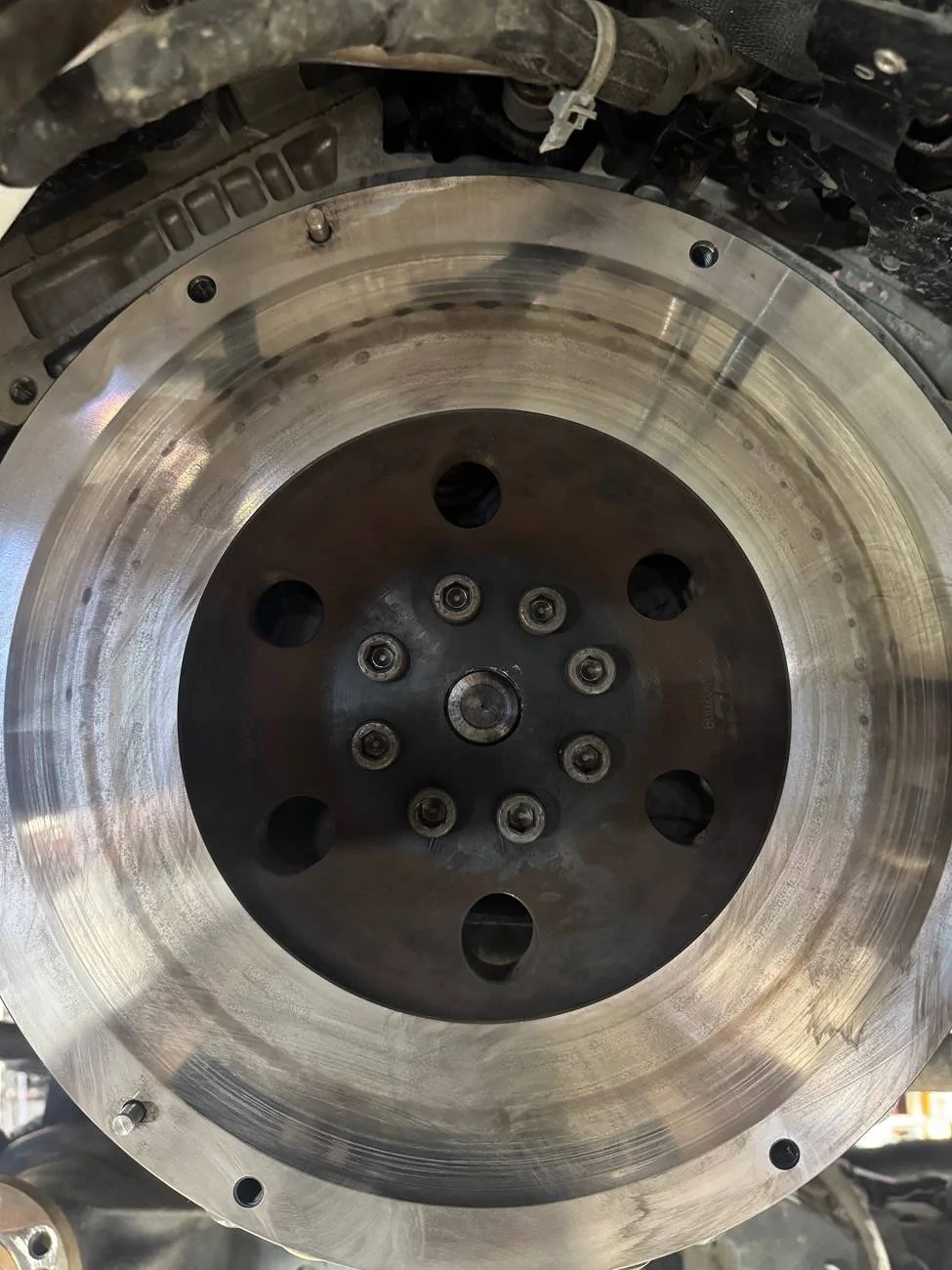

Alright, the shop has the clutch out and they confirmed the incorrect grease was definitely causing the shifting issues. The clutch dust bound up with it and made it very gritty.
The shop also sent over photos of the flywheel with this odd heat scorching pattern on it. I have an email into ACT but am assuming I'll need a new flywheel overnighted to Boise. The clutch never felt like it was slipping or overheating, so I was very surprised to see this. I know I'm a decent manual driver too as I've never burned a clutch before. Thoughts?
Jeremy,
Unless there's a big step in the flywheel, I don't see anything to worry about. That's a pretty common thing to see.
The fact that it's primarily on one side makes me think the pressure plate has some bias contact/pressure on that side. But again, nothing really terrible. The wear is also toward the outsid and not much inboard. That could be a flatness issue, if this flywheel had been resurfaced incorrectly. But if this is a low mile clutch/flywheel, it takes some time to wear in all the components. Frankly, I'd put it back together unless it was vibrating/chattering upon normal engagement from taking off.

I just spoke with Dirk at ACT and he confirmed that it would be okay to reinstall as-is. He wasn't concerned about the heat marks and said that it appeared to be pretty normal. So hopefully I'll have the car back by the end of today.

Just got the Jeep back from the shop and it is a night and day difference. Shifting is much smoother, the clutch does not creak or have any more weird sounds, and the pedal pressure required to engage and disengage it is much, much lighter than before. I'm very happy with how things feel and will certainly report back if anything changes. I can't thank the people at Boise 4x4 enough for getting me in and sorting out everything on such short notice. Dirk at ACT was also a big help and very happy to chat through everything with me.

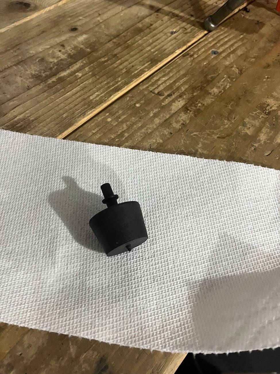

I ended up here a few days ago after experiencing same as everyone else here seems to be - low pedal engagement and increasingly hard to get in gear. I've also got a third, seemingly unrelated issue, where the Jeep won't start unless clutch is pressed insanely HARD to the floor (and a P083F code) which I'm looking at resolving separately with one of two switches in the mix there (pedal sensor and interlock). Anyhow, all of this comes at 78k miles and 1 year/18k miles on the ACT clutch. I believe the hard shifting began roughly 5-8k-ish ago. It has has progressively gotten worse. Not sure about timing of the the extremely low pedal engagement, but somewhere along the way.
On the two primary issues of clutch engagement and shifting, I found this thread and have been reading up here the last few days. Decided to try the dry bleed procedure discussed around the 50-51 page. Did it last night, overnight roughly 8 hours it sat. It lost 2lb of the 15lb of vacuum. Promising. Test driving this morning the engagement point moved from where it was (nearly immediately off the floor) back up to close to middle. A very noticeable change. The shifting was much smoother as well and not getting blocked going into gear. I'm guarded on this though because I only drove for about 30 minutes so not exactly under the typical heated temps where that issue seems to really present. I'll know more on that over the next day or two after I get some time on it. Whatever the case, that dry bleed process requires minimal effort, is clean and simple. Definitely worth a shot IMO. I used the Mightyvac and a homemade stopper for the reservoir. Got the stopper at HD, drilled small hole and inserted one of the Mightyvac hose adapters.
