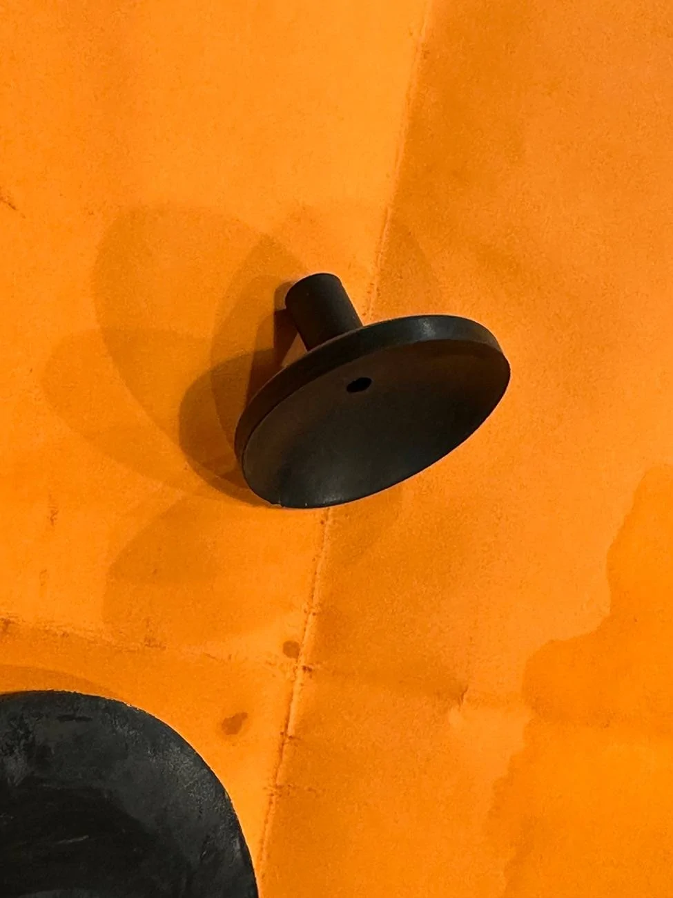

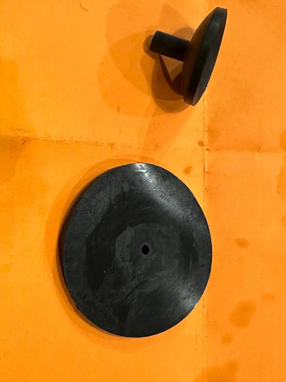

Any source for the rubber plug that’s required to do this? I have Harbor Freight down the road where I can grab a vac, but don’t know where to get something to use as a plug. Leaving for a long road trip on Monday and would love to bleed overnight before I go.
The first shop who did the initial install of the CF threw it away. When the new shop was doing the hydraulic throw out I specifically asked them to keep it for me. Here are some images of the old shift fork and OEM throw out bearing all gunked up with red n' tacky, the bleeding instructions from CF, and the two rubber bleeding devices. One is a flat piece of rubber (1.875" dia x .125" thick) with a small hole in it and the other is a conical device (1.125" dia) to hook onto a vacuum pump.
