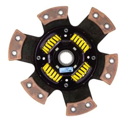

Since i have to pull transmission out again, and the idea of going back to clunky and jerky OEM clutch makes me cringe, i reached out to ACT about their funky looking street racing 6 spoke ceramic clutch disk.
Jeep Wrangler JL Manual Transmission - Issues shifting into 1st & Reverse (Compilation thread) 1751673893507-90
My thinking is based on previous experience with ceramic brake pads - they last longer and significantly less dusty. However, i don't know how das wunder rennen thingy would perform in Jeeping applications. Will see what ACT has to say.
So, if i do end up being a test dummy for this approach, and you can wait another year and half (that is about 7500 miles for me), i will report back and might save you from $3000 of additional pain the ass.
