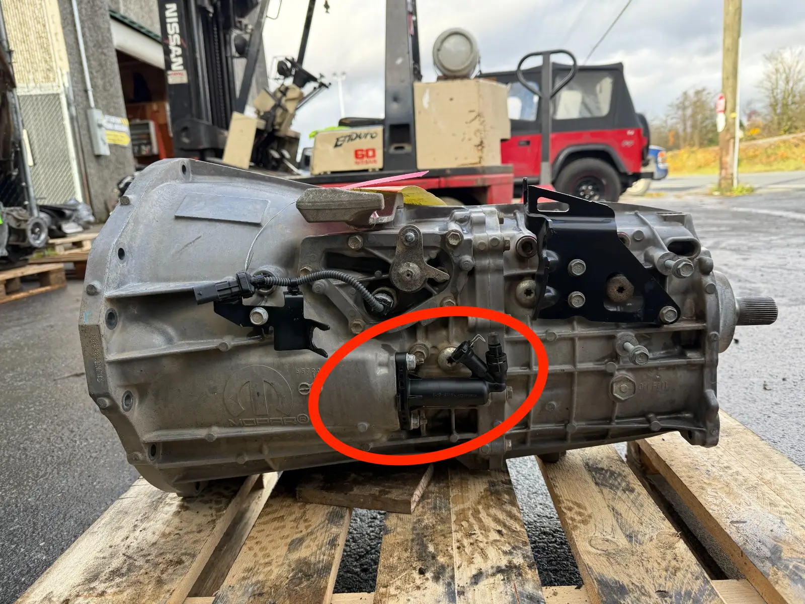

I've been doing visual comparisons while on lunch at work. I found this is picture on ebay. Circled below is the slave cylinder:
Jeep Wrangler JL Manual Transmission - Issues shifting into 1st & Reverse (Compilation thread) 1758131583358-vn
Looking at the way it mounts, I googled. "External hydraulic slave cylinder 44lb" and got a bunch of results from all the auto parts stores but also places like Jegs, Modern Driveline, etc. Doing a visual comparison, a few of them look like they MIGHT work, just based on shape and how they attach, or could be modified. Next question is will the internals work? Because each one has a kit with a hydraulic line and some have a master cylinder.
This is what I'm thinking may be the way to work. It will require more research and an experienced shop willing to work with you, but there HAS to be something out there; In drag racing alone, people do all sorts of crazy driveline stuff (including big forced induction V8 swaps with stick shifts) in all sorts of platforms: There has to be something aftermarket that works. Hell, a new clutch kit is like $2-3k installed, that's a big range to play with if you can find a heavy duty slave/master cylinder and hydraulic line kit for $300 on Jegs/ Summit/ or something.
If I'm off base with this thinking, someone please @ me and tell me why before I go down another rabbit hole. I realize doing it over, I should probably just go with CFII with the Hydraulics, but if I can find a good solution for less than the cost of a do-over replacement clutch kit, that would save money and down time for me and others.
That’s all above my pay grade , I can unbolt and bolt stuff on that’s about it lol. I’m on the fence with ordering the CF internal slave / hydro kit only and installing that with my current ACT. No matter what I don’t see a solution that doesn’t involve dropping the transmission. The sound mine makes after it warms up is coming from inside the bellhousing for sure. I suspect the plastic throwout getting warmed up and the extra pressure on it from the stronger springs in the ACT setup, but who knows. Then even if that was the noise issue no one makes a non plastic version of it I do not believe, and even if they did I’m still stuck with a hydro system that’s letting air in. So the CF internal slave setup would get rid of all those potential issues. However, is it worth all that work to find out it is somehow in fact the act clutch components themselves creating issues?
