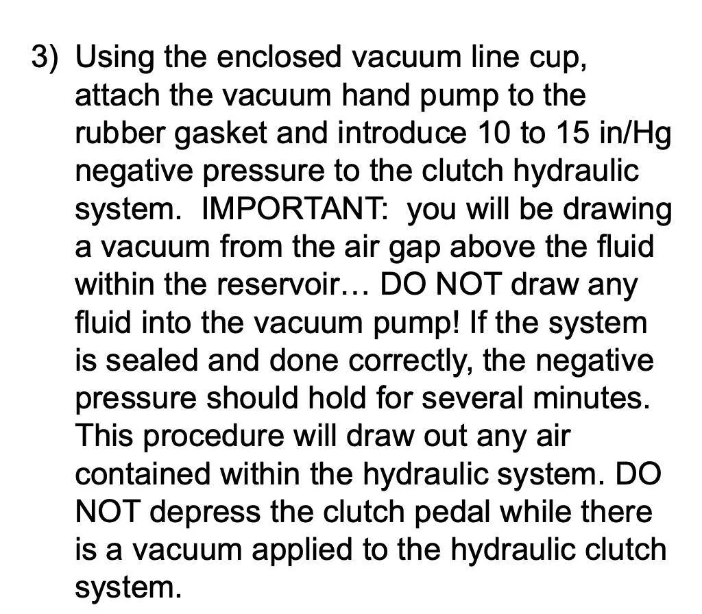

maybe put the system under vacuum and slowly push the clutch - I don't know if you could damage anything by pushing the clutch under vacuum, but that would identify if the act of pushing the clutch is the source of the leak.
SadRobot
Aug 31, 2019
144
7,494
20,077
Los Angeles
2025 Prius LE
From what I read you are not supposed to push the pedal when under vacuum. This is from the CFII bleed install instructions:
