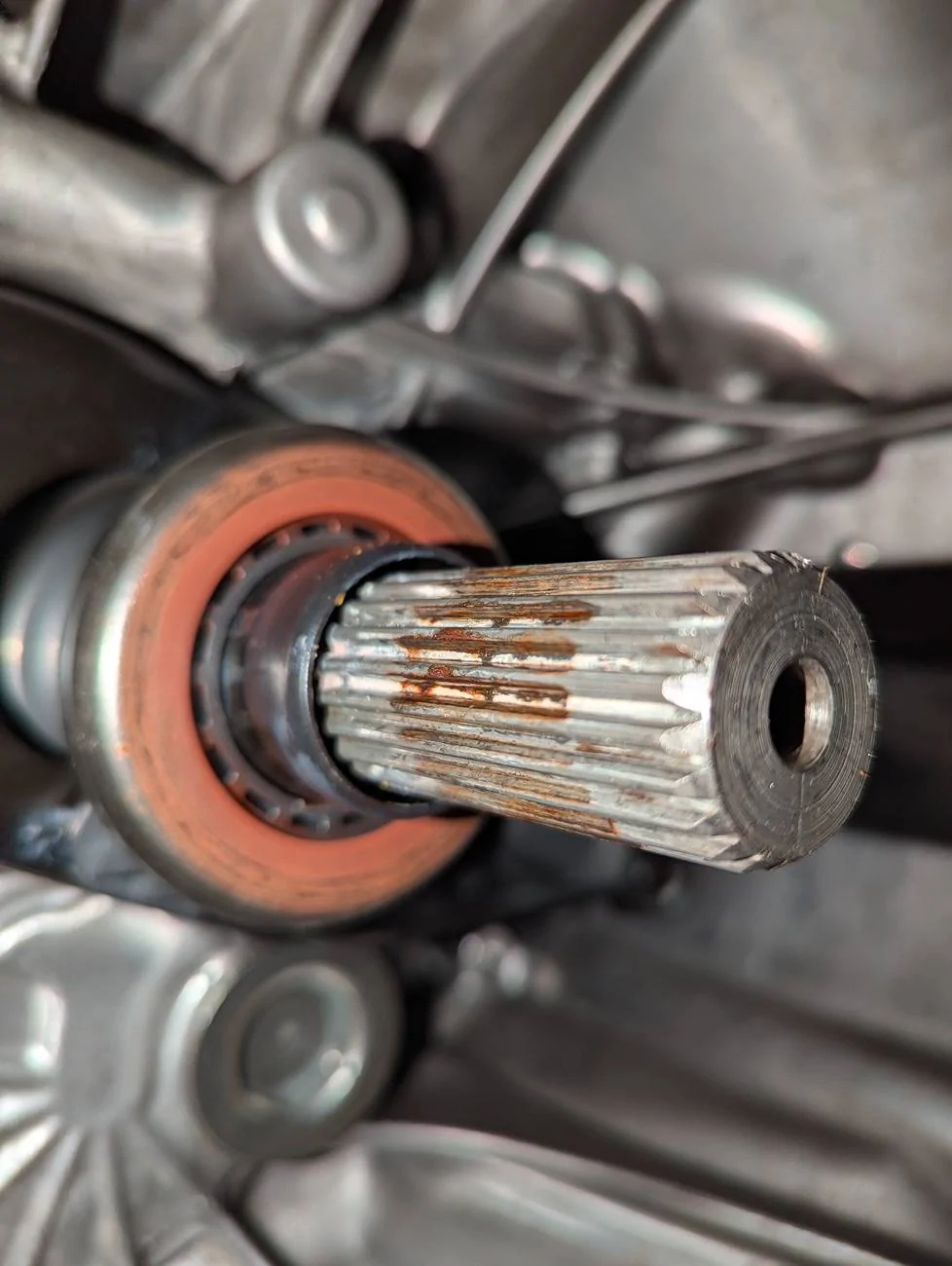

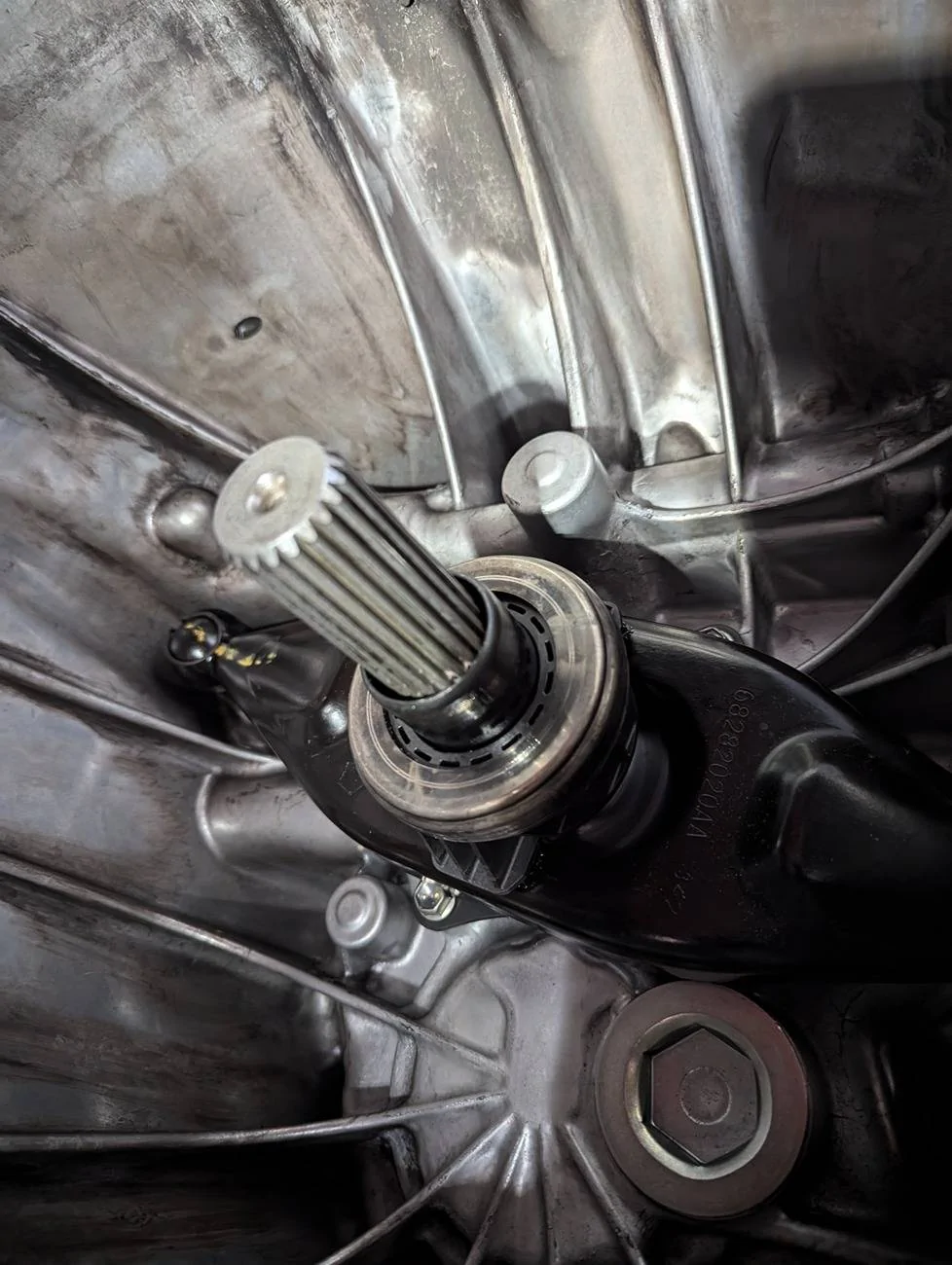

did you get to borescope yours?
I'm looking at buying at borescope to see if there is contamination anywhere (specially on the grease on the in splines)

Yeah, I got all up in there. Release bearing gets in the way of seeing that side of the PP though. I snuck through the bell, then through a hole in the flywheel and was able to see the input shaft snout.
I have a bunch of pics I have yet to pull off my borescope.
