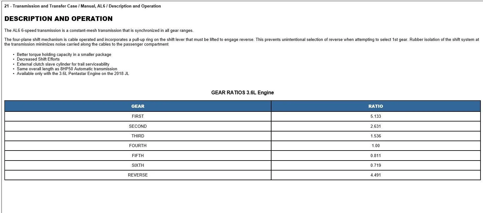

Although the manual states that it's "synchronized in all gear ranges", I had not seen transmissions with a reverse synchronized in the past. But, it's been a long time since I dug into a manual transmission. So, there's that.
where did you find this? ive been searching for the AL6 or D478 transmission booklet with zero luck

From the factory service manual:
  • 1st gear is syncronized.
  • Reverse is not syncronized.
  • I don't see anything electronic as to a first gear lockout. Bad batteries are not causing shifting issues.
  • There are a couple parts shown which I don't know what they do. They could be mechanical 1st gear lockouts, don't know. Syncros can prevent downshifting to a lower at too high a speed though.
If you can't shift into 1st with minimal effort when stopped, probably a dragging clutch. This can be tested by raising rear wheels, transfer case in 2WD, put tranny in 1st or reverse with clutch disengaged (pedal to the floor); and see if there is any rear driveshaft movement at all. If driveshaft turns, clutch is dragging.
Could be the stock hydraulics are just not sufficient to fully disengage these aftermarket clutches (could be the case with OEM as well, which could have caused the issues to begin with). A lot of folks are saying it shifts OK when cold, but fails when warm. Syncros are nothing but wet clutches and work better when tranny fluid is cold, thick, and sticky; and loose ability to work as well when tranny fluid is warm, thin, and slippery. Could be the syncros can slow the main shaft when cold, but cannot put sufficient pressure on the main shaft when warm.
A slave cylinder can fail internally, fluid leaks past the piston inside; no external leaks; it just won't disengage the clutch.
Thats out of my Tech Authority service manual.
I trust that more than what Jeep says. They dont have a clue what the inside of their 3rd party transmission is like.

The documentation I've read on the trans has synchronised R and every gear. I was hunting it down just to see exploded diagrams of the stacks.
