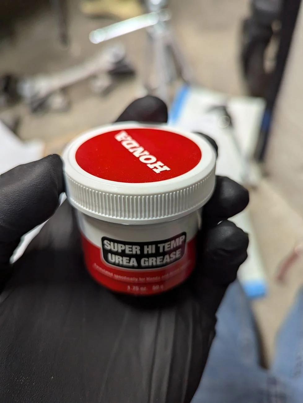

Odds are, that its just a gummed up input shaft causing the friction disc not to fully release. Its the most likely culprit, also a PITA to fix. Im still dancing around dropping my trans again. Trying to exhaust every other avenue first, lol
I'm planning on dropping mine this summer or maybe spring to check this but would like to have a permanent solution before I do that, if this is the issue, not liking the idea of making this a "maintenance" item to drop the trans every year to clean the shaft SMH
Well, maybe ditch the grease and run a dry lube, or no lube.
