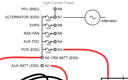

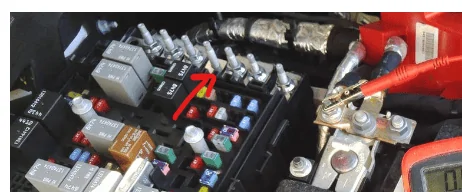

My main fuse block does not seam to be connected correctly. From the some of the forum pictures it shows nothing connected to post 4.
Then these show AUX PDC connected to pin 4.
I had fuse 5 and fuse 6 blown. A dealer worked on an electric issue early on where the grounding strap was melting. Then 58k miles the engine was replaced.
So I am wondering where the wires should go.
N7 is the alternator.
N6 Main Battery ?? I think this is incorrect,
N5 ??
N4 ??
N3 ??
N2 ??
N1 Aux battery ??
