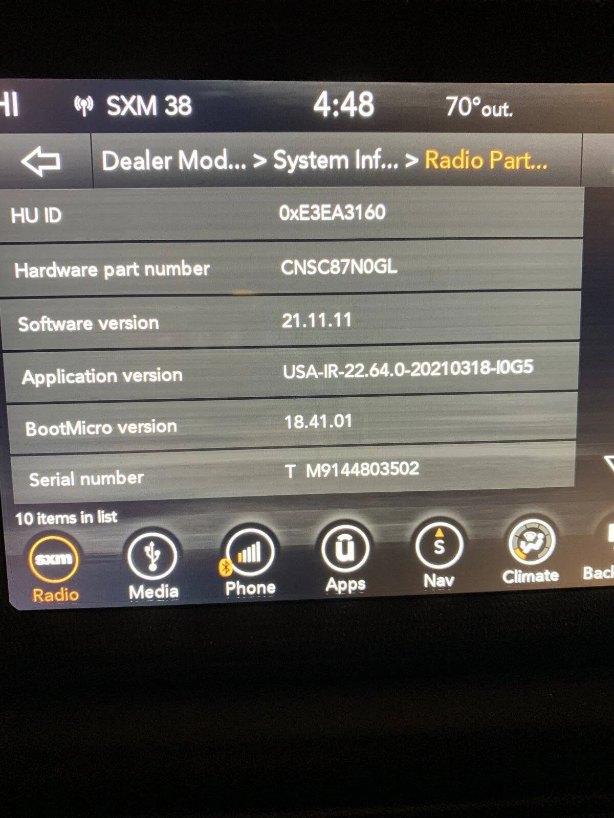

Hi Tim, thanks for posting, mine said software updated but is version 20, how can I get yours version 21? Uconnect assist? Or any number need call? Thanks again.
My advise is contact @JeepCares on this forum and ASK for the update. Send them your issue, your vin, and pic of your JL Uconnect software version. ASK for the over the air update. I was working with Courtney.
She was able to get the latest version sent to my Jeep.
Hope this helps.... Tim

Yesterday while gassing up, got a on screen alert doing a update for 30 plus minutes. Not sure what it was, I looked it up and read this post and checked out backup camera lines etc. So I drove doing around while errands and all done.
All is well and the same version 21.11.11 plus all the same numbers except serial number.

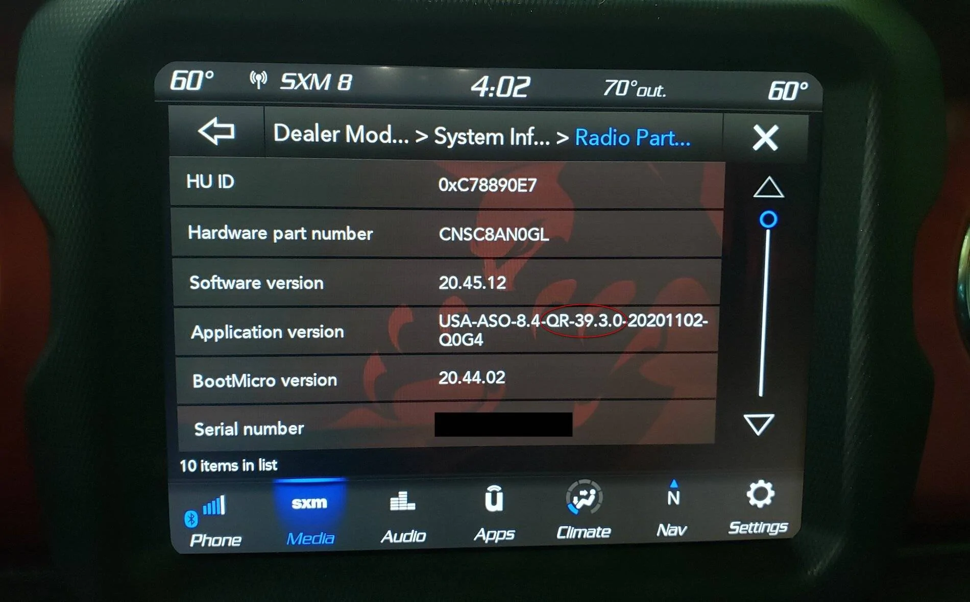

I contacted UConnect support today and they walked me through how to find my software version. Apparently everyone's latest version of software could be different based on what they're driving. So the 21.11.11 version posted earlier for the 2018 is not the latest for my 2021. In order to find my software version I had to hold in the driver side temperature up button, temperature down button, and front defrost all at the same time. That brings up the Dealer Mode options where I selected System Information->Radio Parts List (I think it was). I attached a picture. My current version is circled in red (that's what the rep told me anyway).
He put me on hold for a few minutes and came back and said that there's definitely a software upgrade being done to address the disappearing lines and that a case manager will call me within a few days to help me get the update. So it seems that the OTA updates don't get pushed automatically, you need to call and it's done on a case-by-case basis. Once they get me the latest version I'll post an update on whether it worked or not.

I contacted UConnect support today and they walked me through how to find my software version. Apparently everyone's latest version of software could be different based on what they're driving. So the 21.11.11 version posted earlier for the 2018 is not the latest for my 2021. In order to find my software version I had to hold in the driver side temperature up button, temperature down button, and rear defrost all at the same time. That brings up the Dealer Mode options where I selected System Information->Radio Parts List (I think it was). I attached a picture. My current software version is circled in red.
