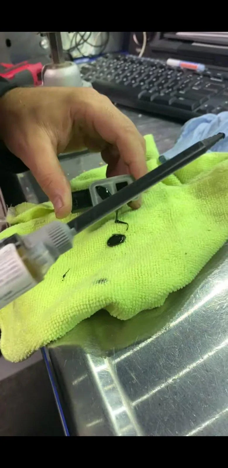

Does the potting compound syringe come with the applicator tip? It doesn't show on the website.

For me yes (received in the box)
