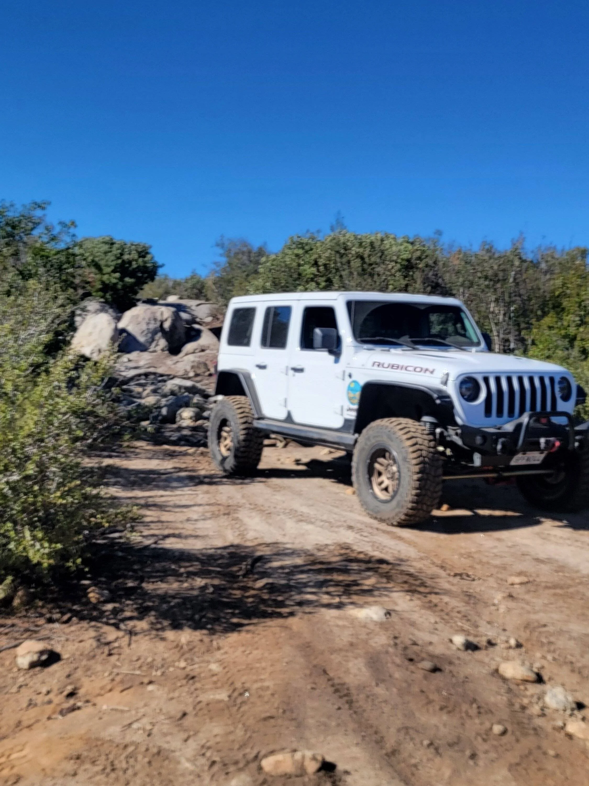

I am currently running the MC GC 3.5 with 3.5 rear springs and 4.5 RK front springs. Even though the GC 3.5 are rated for the diesel, after I got the MC steel front bumper and the Evo 12s winch, there was about an inch droop. As soon as the 35 (actually 34.4 inch tire) wear out I am going to 37 inch Cooper MT's. Anyway, I think the jeep looks good and works great on the trails.

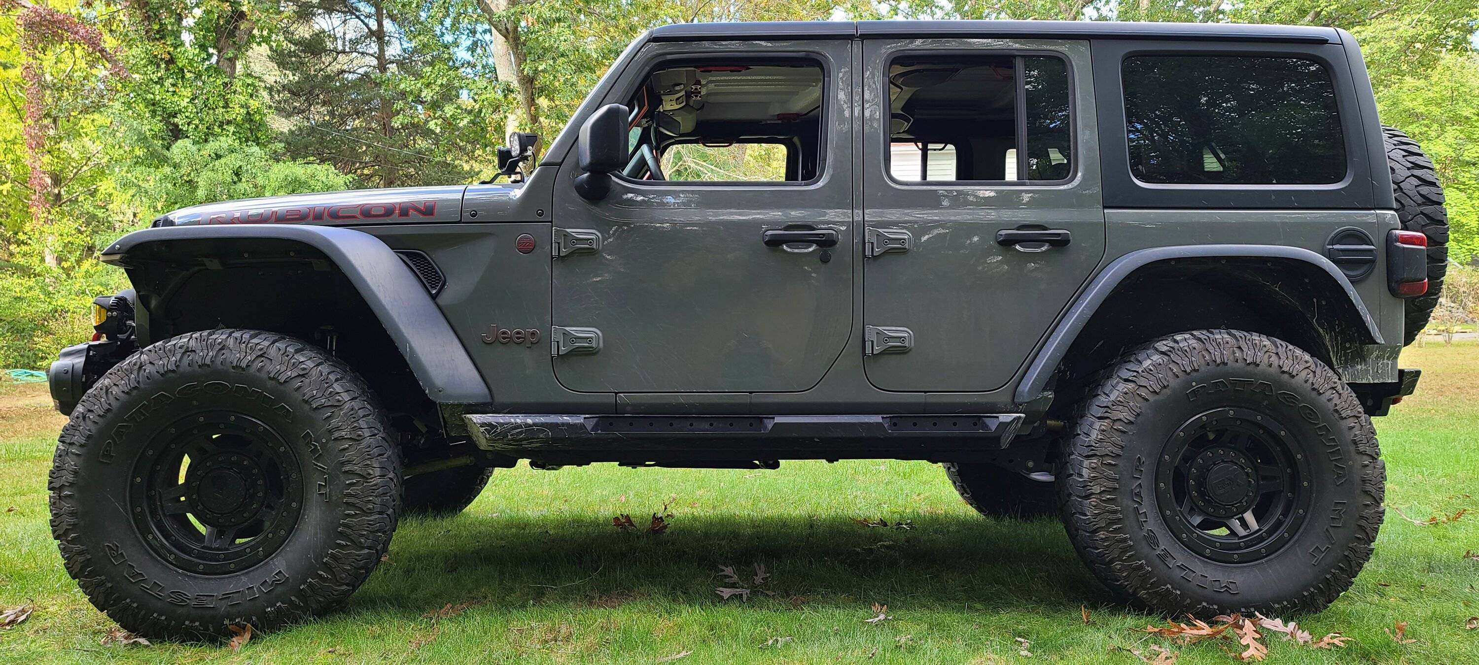

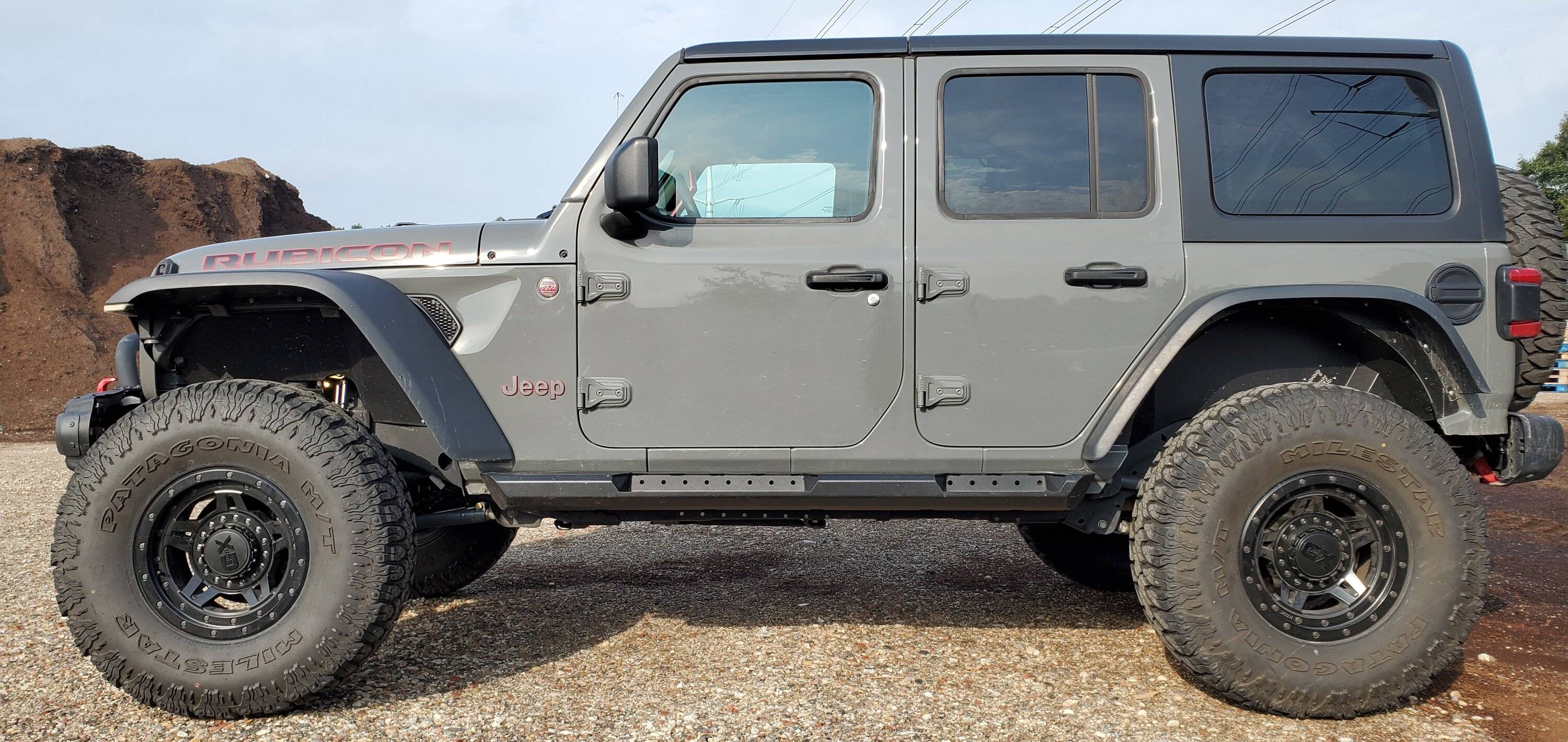

Can you post a pic?
The 1st pic is the earliest one I have, after swapping to the 3.5" Gamechanger. Only extra weight at that point was the rock sliders. 2nd pic is after adding the winch, stronger steel rear bumper, hinged tailgate reinforcement, onboard air, etc. The added weight barely dropped it a 1/2".
Jeep Wrangler JL Lift Kit Help 20200813_083329
Jeep Wrangler JL Lift Kit Help 20211013_132632
