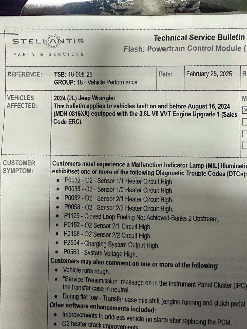

well, here’s an update today marks the 22nd of 30 days that my jeep has been in the shop there’s still chasing the check engine light.
Now they’re telling me that they have to take the taser mini off and reset everything back to factory in order to find what’s causing the check engine light
I’m not sure I believe that simply because I only had the taser on to the air pressure warning in the tires . Nothing more.
So the issue boils down to they can’t figure out the check engine light but the code that it throws is P058A which is something downstream of the motor? They think it’s a battery monitoring module.
