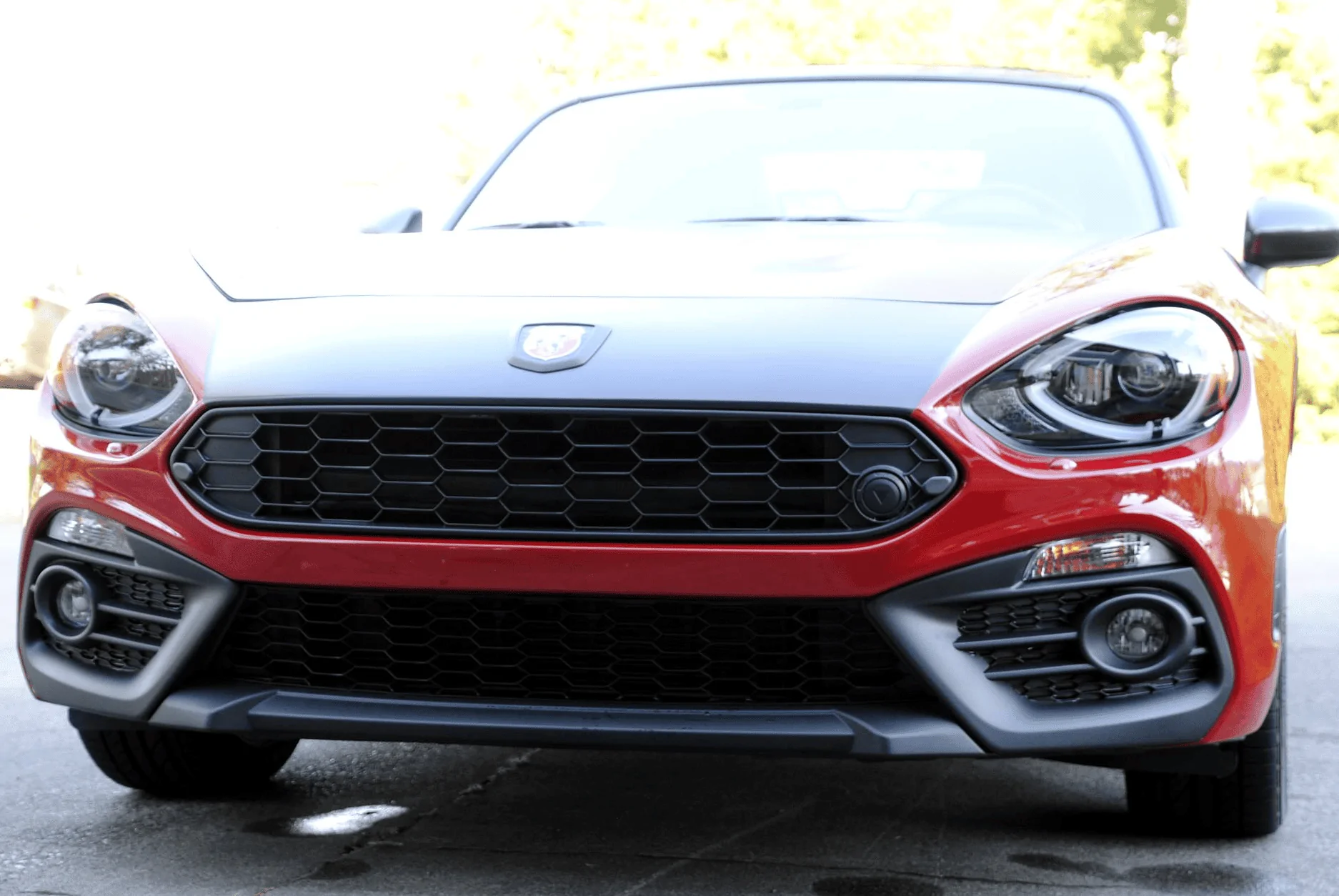

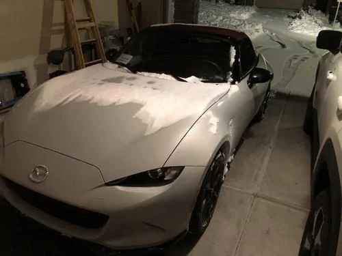

Fees like we need to reiterate this every time this is discussed. The icing over prevalent on JL's is not an issue of LED vs halogen. Halogens also don't get hot enough to melt ice. Want proof? Drive around in a vehicle with halogens for 3 hours, they'll be slightly warm but still cool enough for you to touch.
The JL's issue is that the headlights are inset. This creates a small air pocket where snow and ice can build up. Contrast this with most modern vehicles, where the headlights are part of the exterior styling, so snow/ice just blow off from air friction as the vehicle drives.
