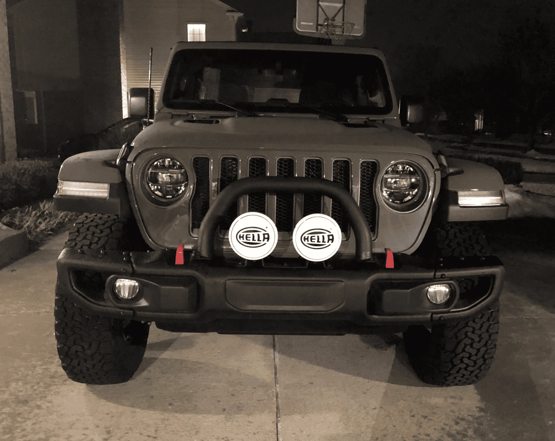

So the DP6 put off a lot of heat even though they are LED? I am going to add lights to my bumper bar . I actually have a set of PIAA someone gave me, but they are LED and I wanted halogen for heat, as a backup to my LED headlights.

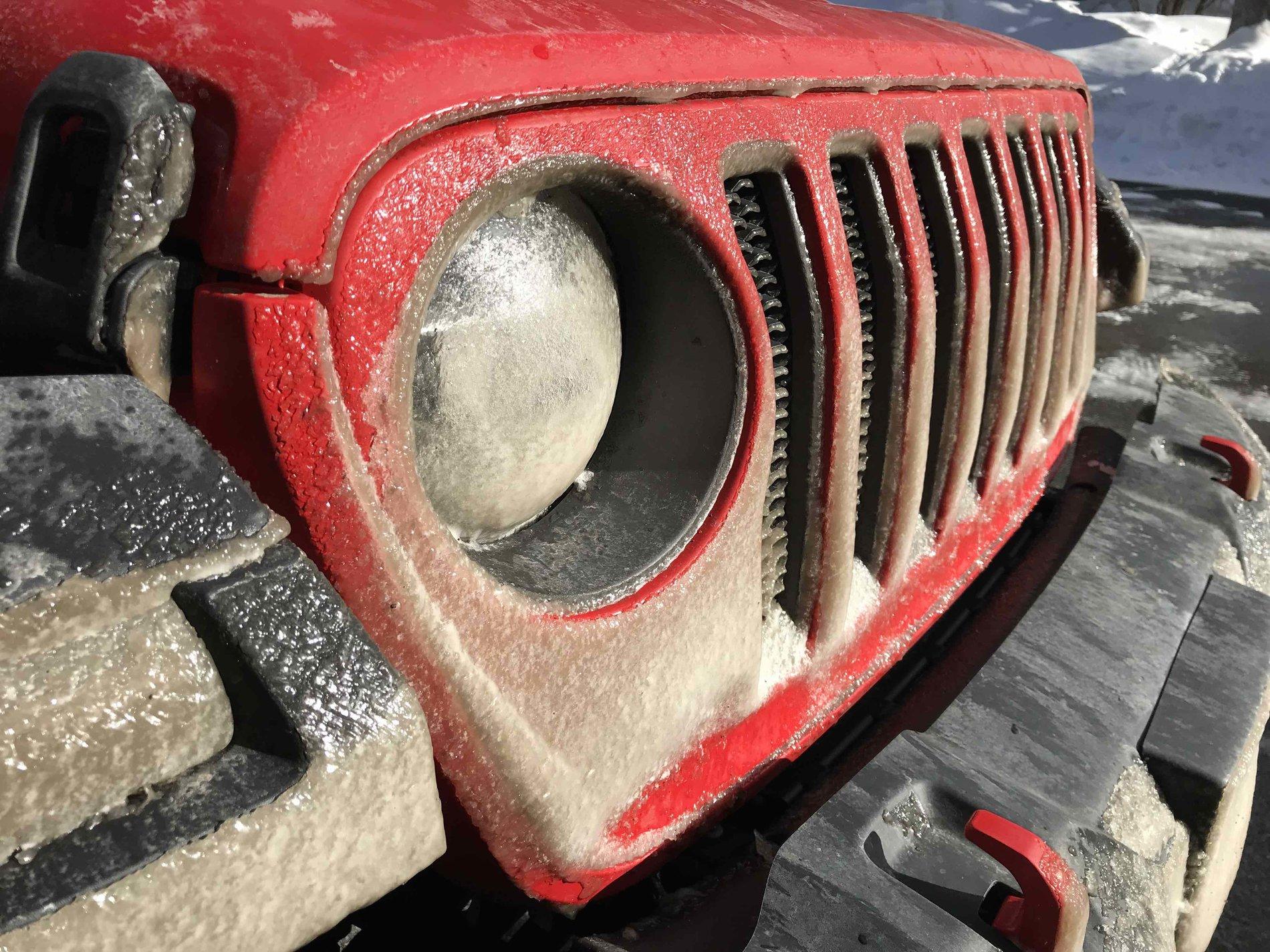

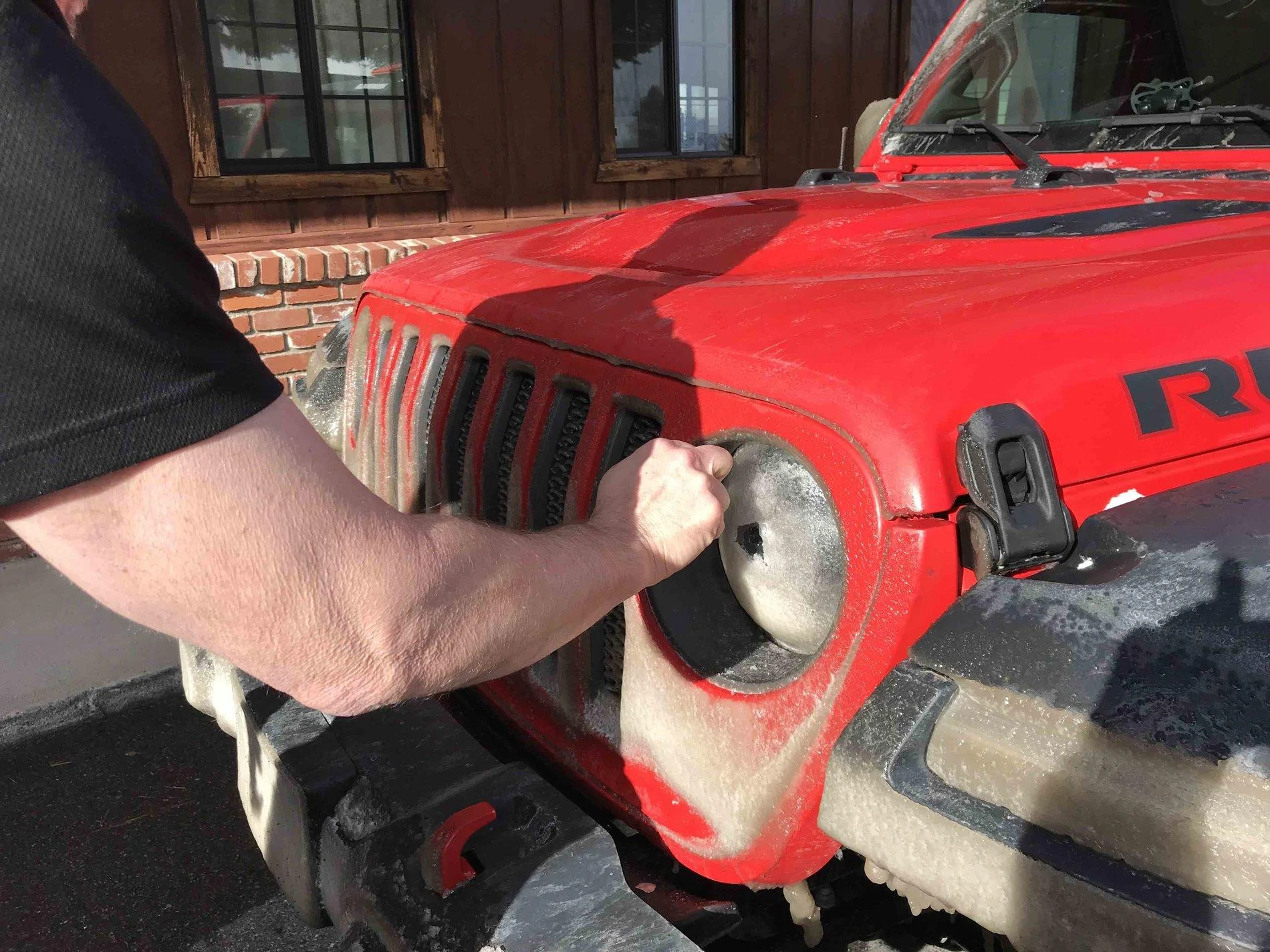

Ok let’s put this to bed once and for all. No headlight, halogen, LED, xenon, etc, produces enough heat to actually melt snow and ice in winter conditions. Want proof? Drove around with halogen headlights on for a few hours and then touch them. Barely warm.
I was curious whether this was true and I can confirm I drove my wife's CRV with halogen headlights for 30 minutes last night, put my hand on the lens and it was just as cold as any other part of the car.

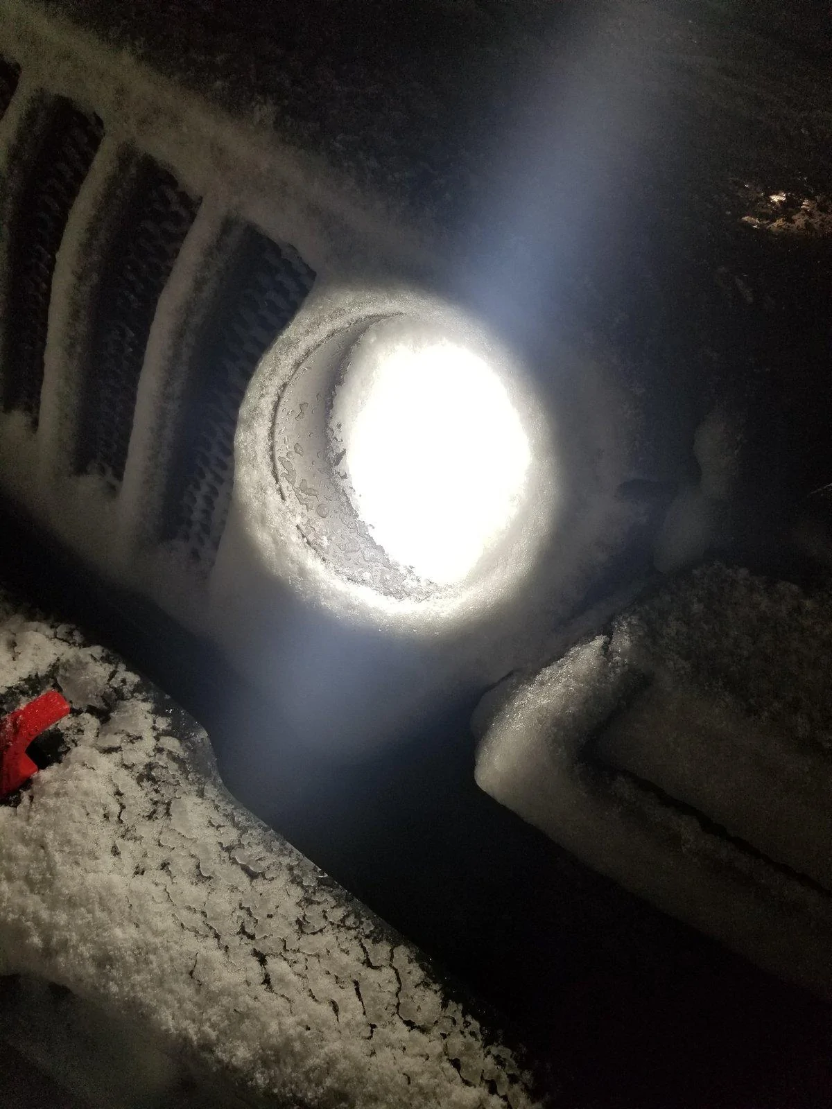

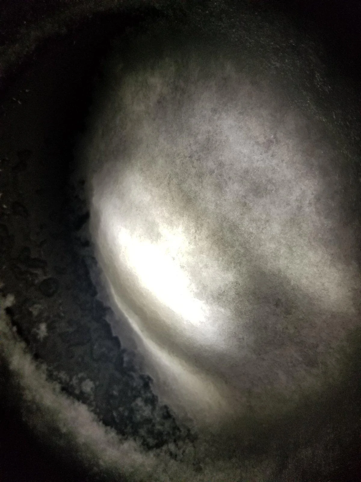

Do the LED headlights get covered in ice and snow in the winter? Or do they somehow melt the ice and snow in the extreme cold?
LED headlights don't produce enough heat. I've had numerous problems with mine icing over in the winter.
I've posted this, probably in this thread, but the halogens on the two late model vehicles I've tested do not produce heat either. It's the concave shape.
