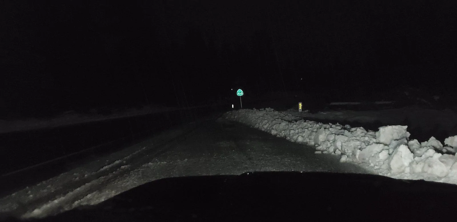

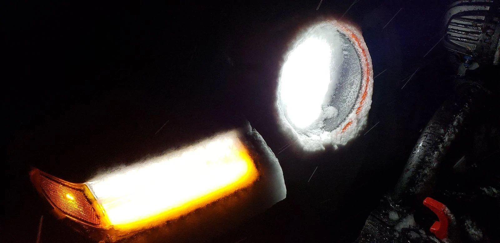

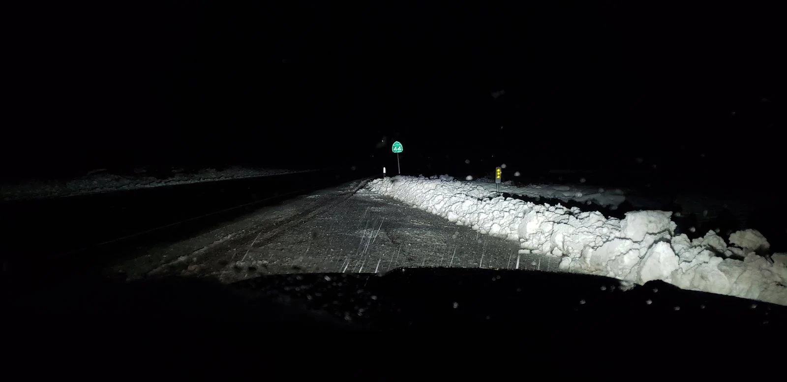

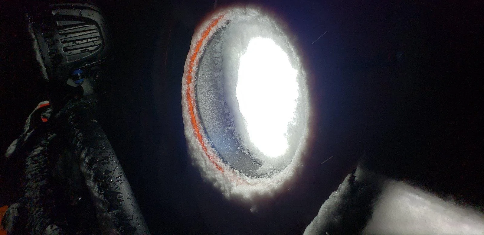

I'm bringing this thread back from the dead because my factory LED lights are definitely not heated nor do they generate enough heat to keep the snow from collecting... This was through Lassen during a snow storm last night and I had to stop like every 5 minutes to clear the lights because I couldn't see jack squat due to the collecting snow.
Snow collecting on the lights:
After scraping the snow out:
Before and after, the pictures make it seem a lot more lit than it was. When I was moving, it was impossible to see more than maybe 6 feet in front of me. I also took these after making it past all of the snow and some of the collected snow had thinned out since it raining at this point, so it's much much more clear than what it was through the worst parts.

Why would anyone report this to Jeep Cares? Everyone knows LED lights don't generate enough heat to melt snow. Some high end LED lights have an option to get heating elements built into the glass/plastic. European light standards are more rigid. I know HID headlights on German cars had to have a wiper or washer nozzle to keep them clean.

Yep you're right. Didn't do my research. I guess some after market LED's I had before were heated so I assumed Jeep would have done the same with their OEM. And especially when I've read in this thread that people claimed the lights were heated.

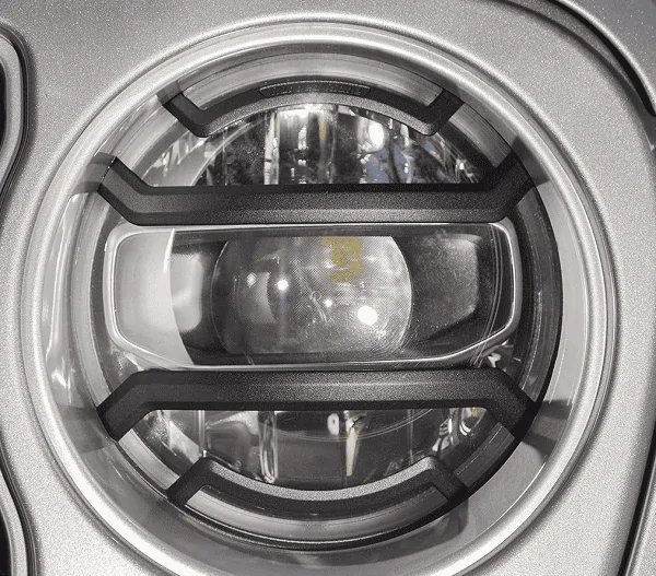

Definitely looks like it is a safety issue if caught in a snow storm and not aware that the snow will not melt. I can see some sort of aftermarket opportunity here that might be able to solve this. If it's causing that much of an issue I am sure someone will be able to profit off of such a product.
I seen the aftermarket lights and they have what looked like a defroster type of element. Something like that with a clear lens that just goes over the stock light might do the job. Need to wire it in though and wouldn't want it on in the summer.
Maybe something like the RR headlight guards but a heated version.
I wonder how warm they would need to get for the worst of storms and would that heat mess up the outer lens.
