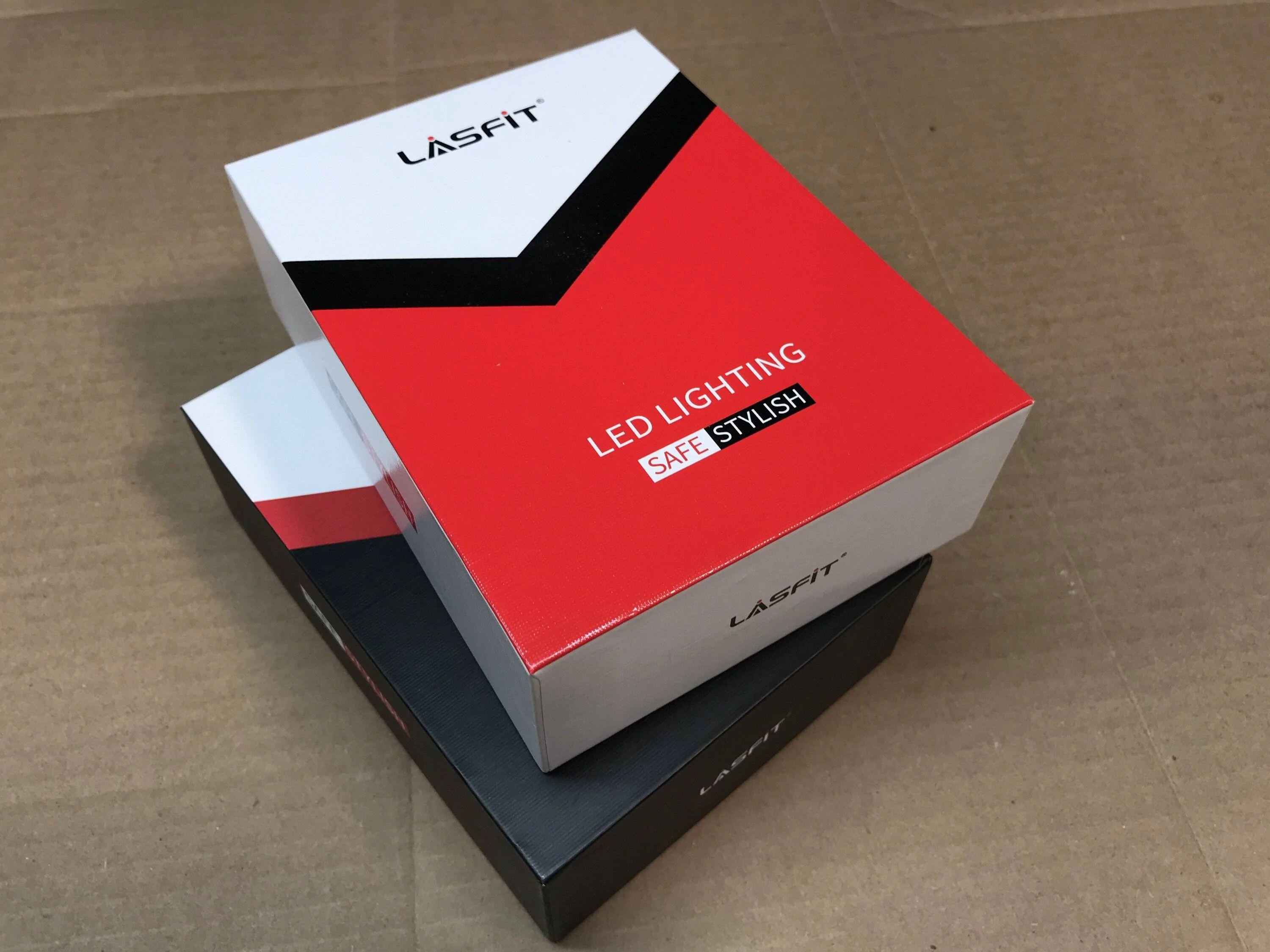

Nothing better than Lasfit. They are amazing. Great light. Keeps the visual line perfectly. No flashing from oncoming drivers. Major upgrade from stock halogens.
Opt for the yellow/white switchable fog light too.
https://www.amazon.com/dp/B0874RH2F...=1&sp_csd=d2lkZ2V0TmFtZT1zcF9waG9uZV9kZXRhaWw
same here, picked them up during Black Friday. Sent back the Amazon BeamTech's because they wouldn't seat properly in my '22 halogen housings. (loose fitting)
I need a break in the weather to get these installed
