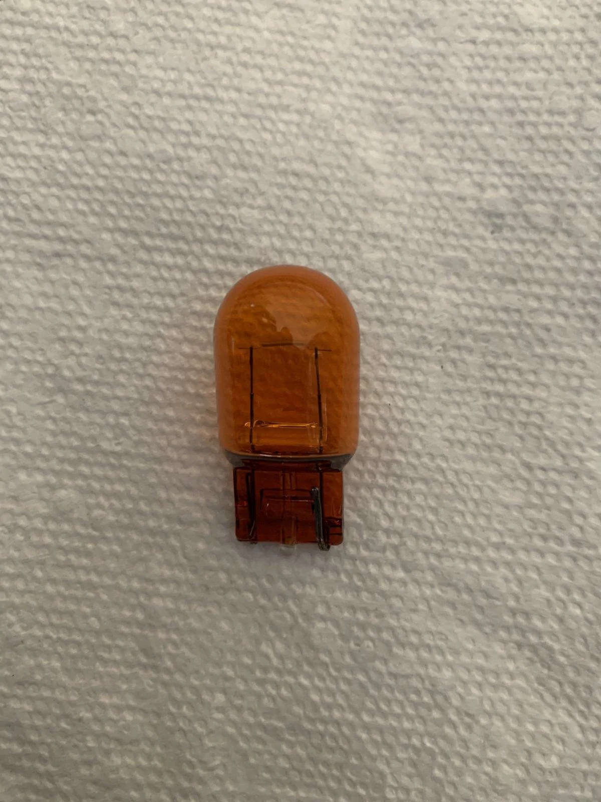

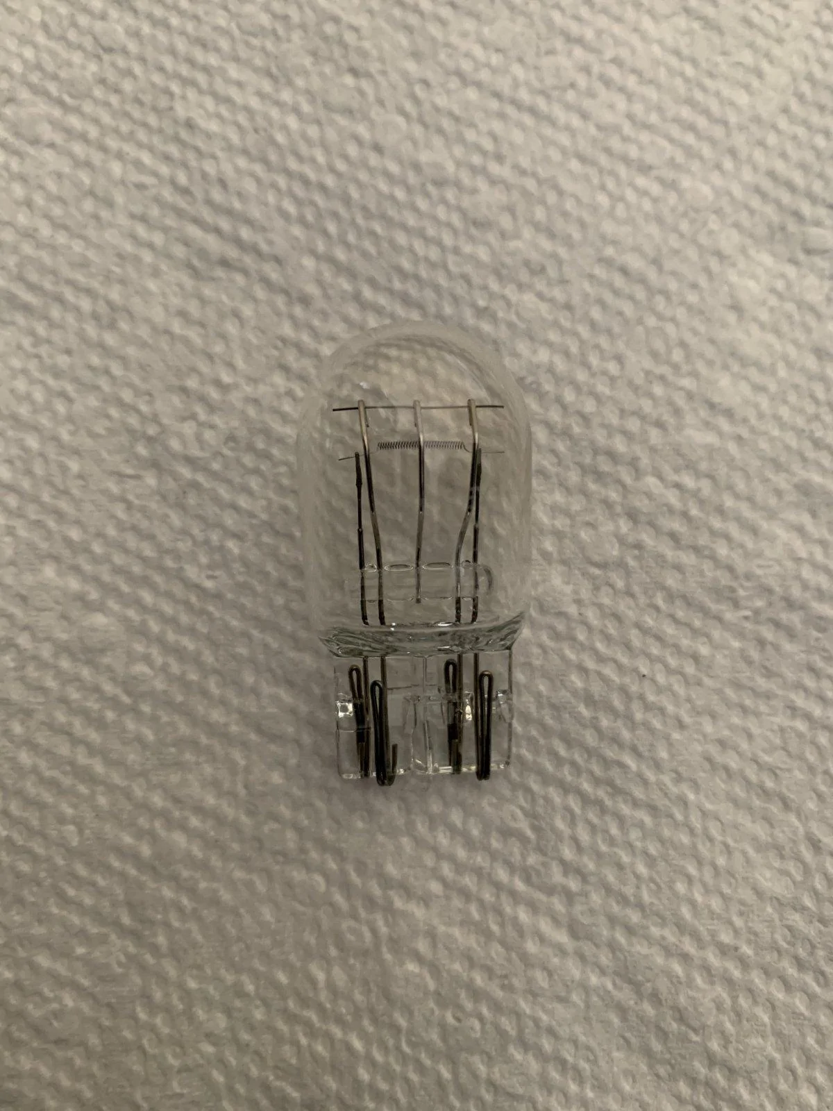

I had the original halogen bulbs, a clear DRL and an amber turn signal bulb.

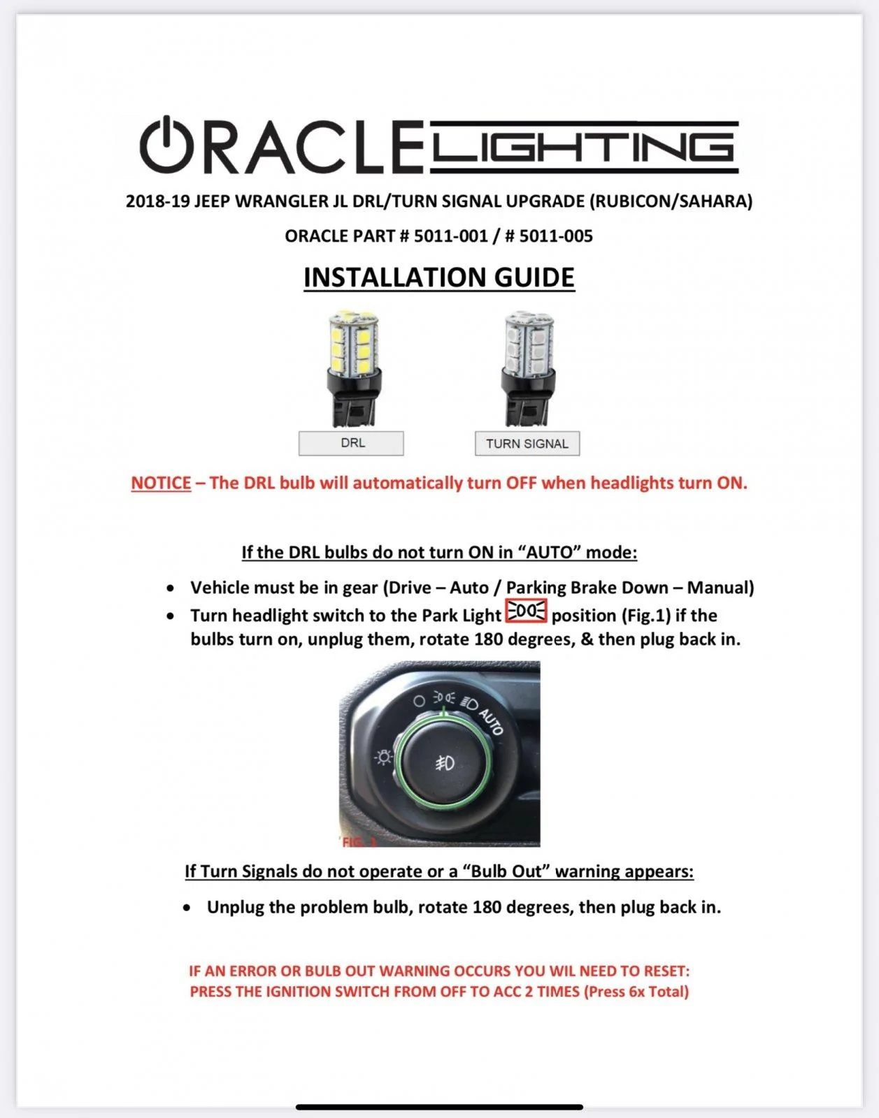

I have a 2018 Sahara that does not have the LED package so I assume these DRL bulbs will work ? Also how is the polarity determined ?
If you have the clear DRL and amber turn signal I would say you are good to go. Oracle addresses the polarity in this attachment. Hope this helps.
