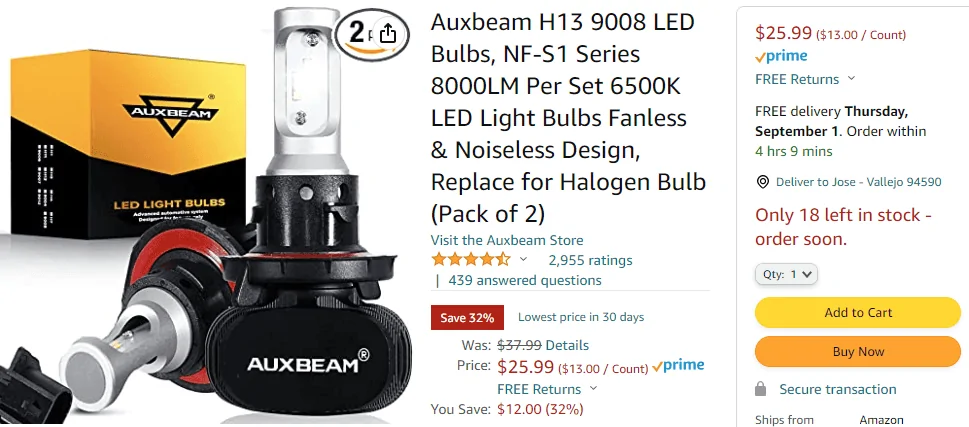

Some people are ok with “good enough”.
I think some people are ok with good enough + cheap enough .. LOL..
I use these cheap Auxbeam LED bulbs.. I like them because they do not have a cooling fan that can fail ... but rather solid heat dissipation fins.. I drive my jeep with the headlights on all the time... 3 years with the same bulbs, no issues so far, and no people flashing me
To Jaymz's point, a LED bulb replacement won't work as well as a purposely designed LED housing... in my case in particular the Low beam is pretty good.. but High beam projects a blurry beam... not really that usable ...
Jeep Wrangler JL LED Bulbs vs New headlight casing? 1661914673848
