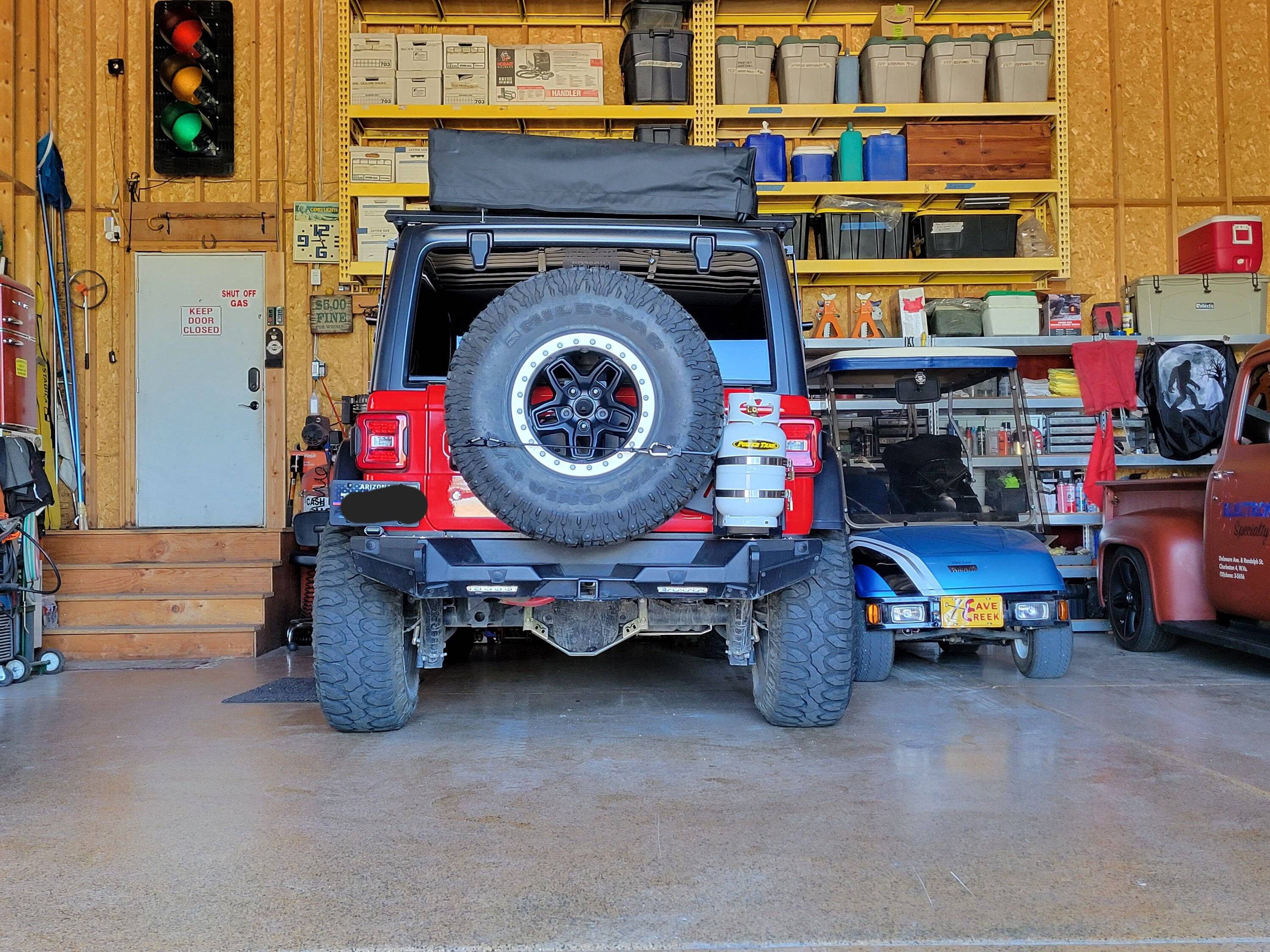

When I measured mine, gas tank was near empty both times, sitting in exactly the same spot on level concrete and passenger side is lower in the front by almost 3/4 inch and near 1/2 inch in rear...pretty sure it due to the RK perches (same part for L & R) but will know for sure when I install the Mopar perches. (L & R are mirror image)Gas tank. Empty gas tank, my JL on a 2.5 inch icon stage 8 is level, add a full tank of gas and it's a little lower on the passenger rear.
