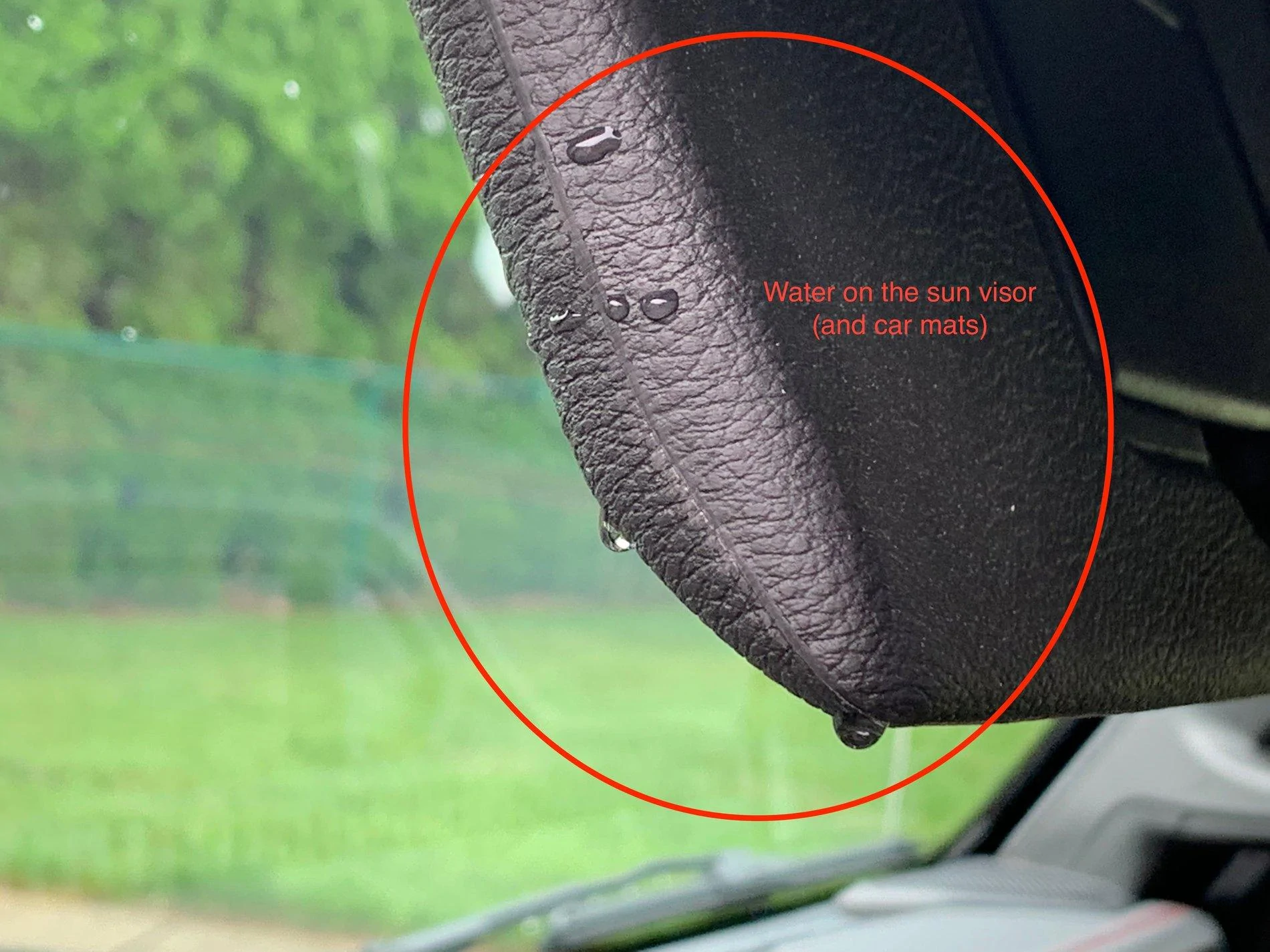

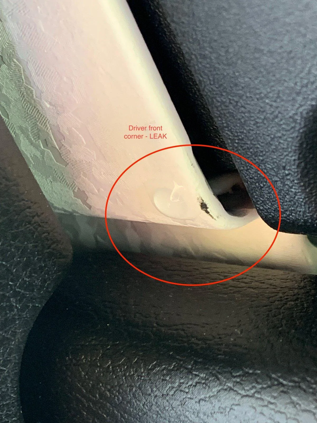

OK ... Driver front corner developed a slow leak today after a downpour. 2 corner seals have now failed - driver rear and driver front. My JLUR is going to the dealer tomorrow morning :-(

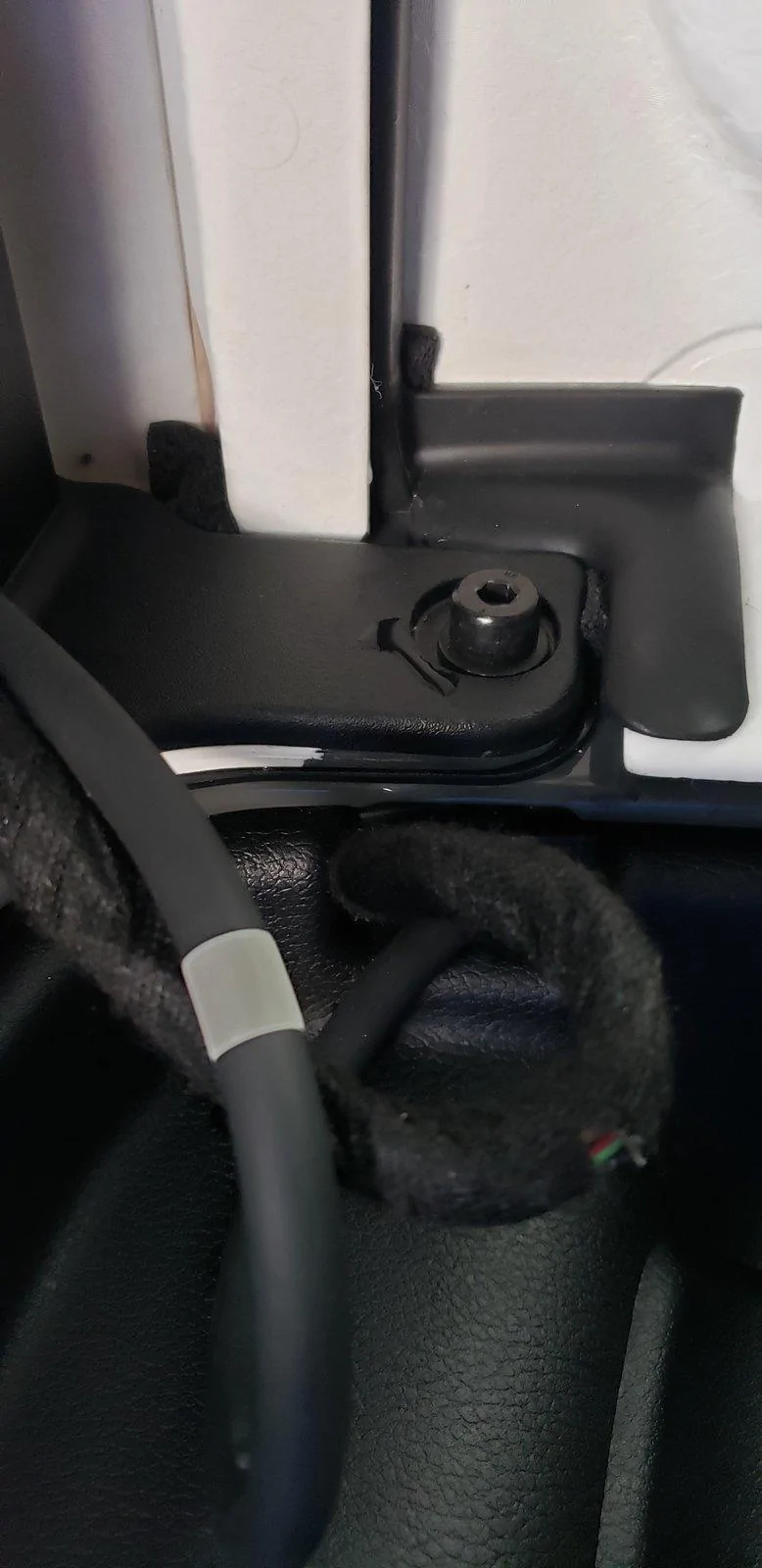

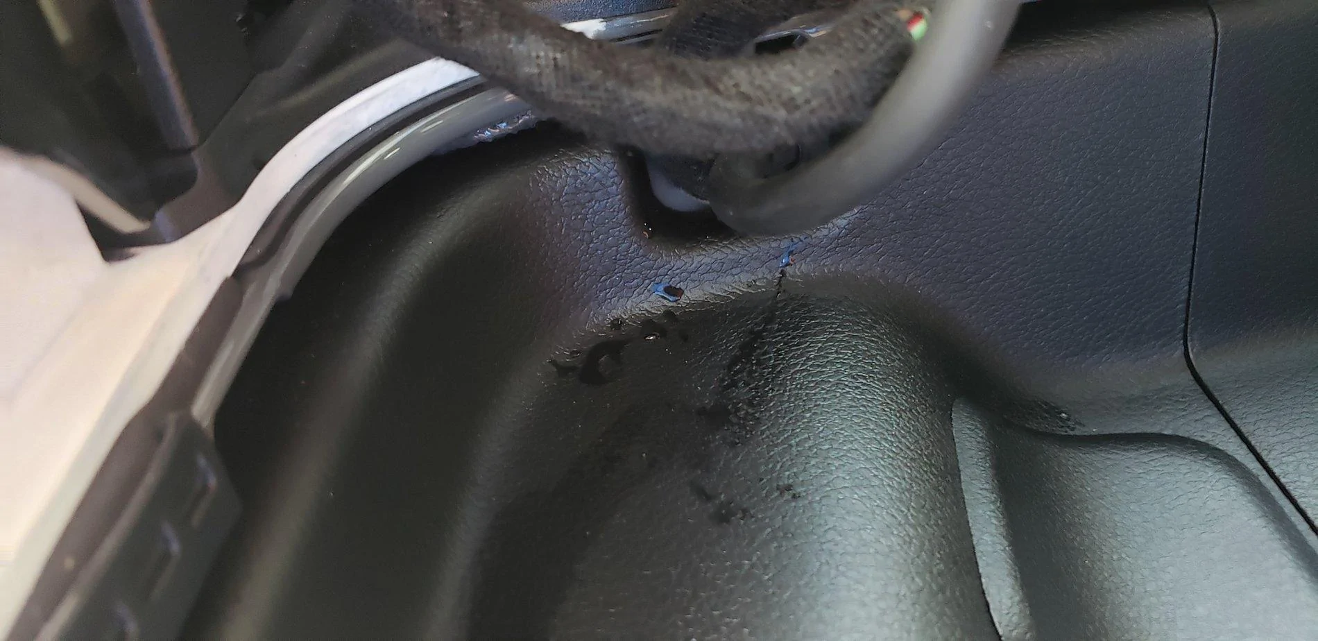

Yes another update. Picked up the vehicle today they replaced multiple seals and both rails. Ran a water test yesterday let it sit overnight. Then ran another water test today then drove it. They said no leaks. Brought it home parked it in the driveway then the rain came. Figured we would find out soon if its fix. Well, it's not. Still leaking left rear same spot as before. Going back in to service tomorrow. Any suggestions what my next step should be? [GALLERY=][/GALLERY]
