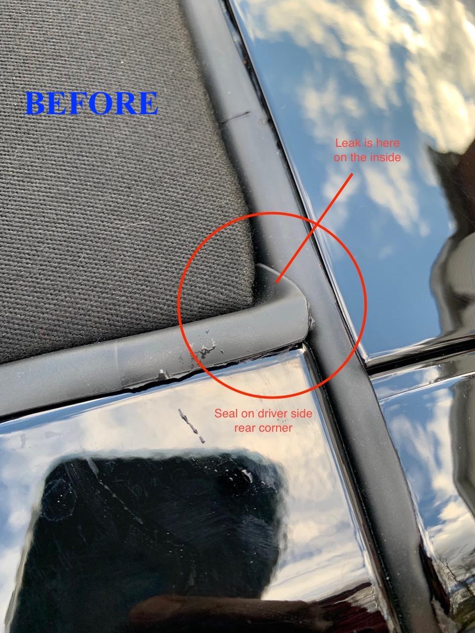

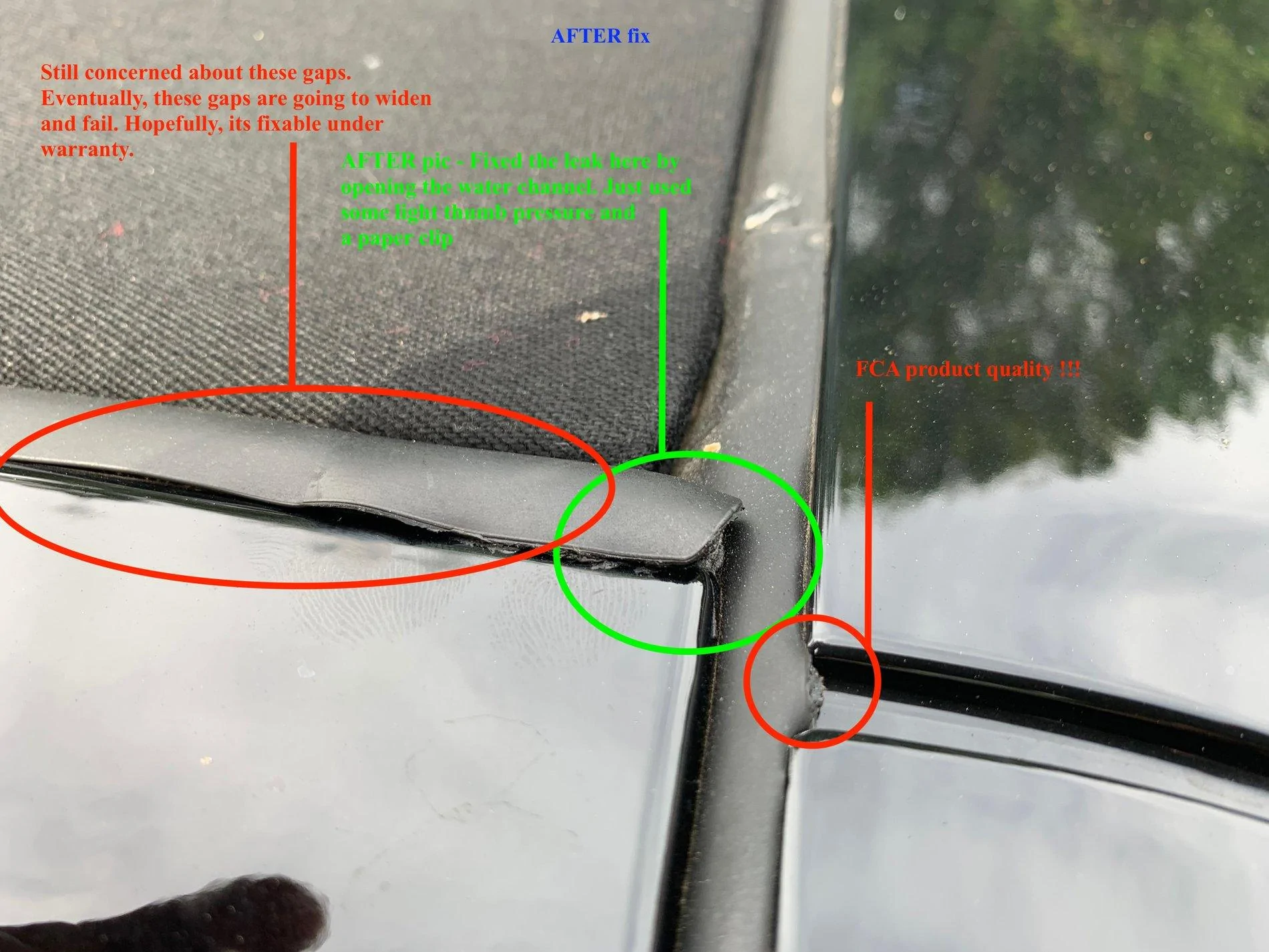

Here's the before and after pics. The only real solution here would be to ask FCA to reseal the entire Sky One Touch power top.

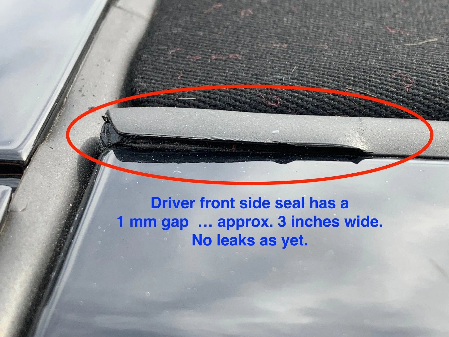

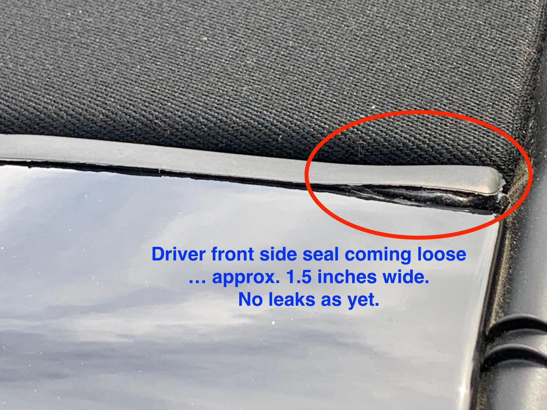

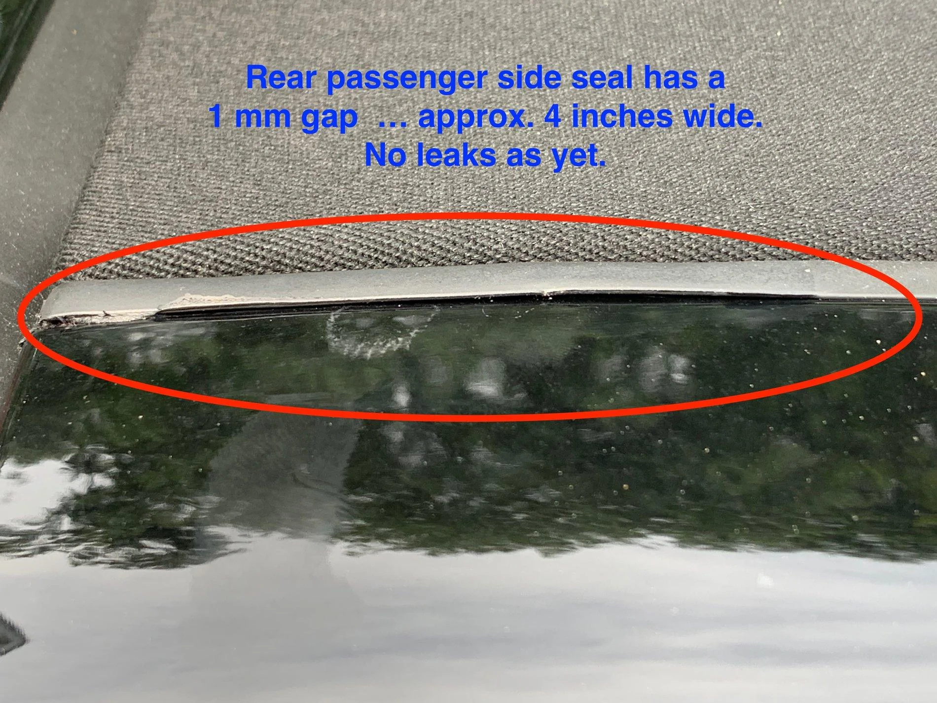

The rubber seals are has widening gaps at all four corners - see attached pics. Fortunately no additional leaks yet.
Anybody here approached the dealer to get the seals fixed under warranty? Wondering how the dealership responded.
