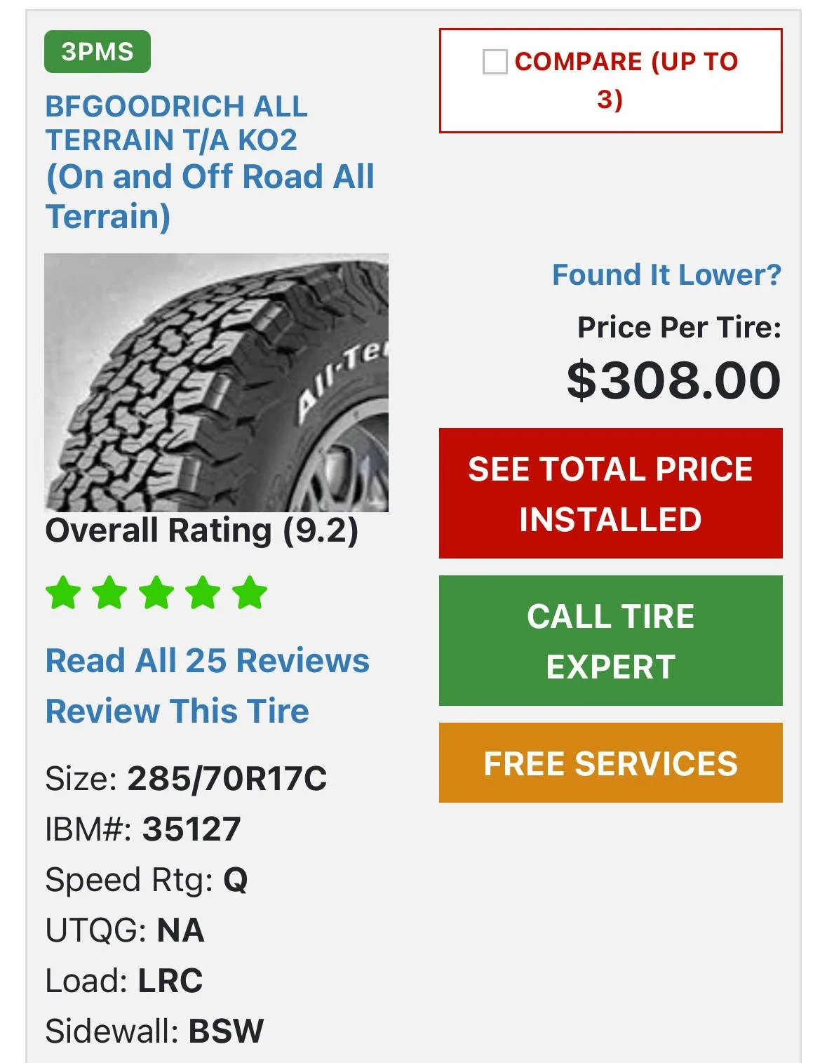

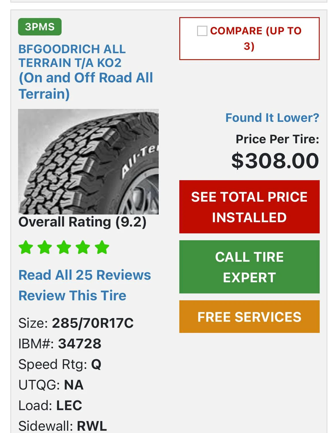

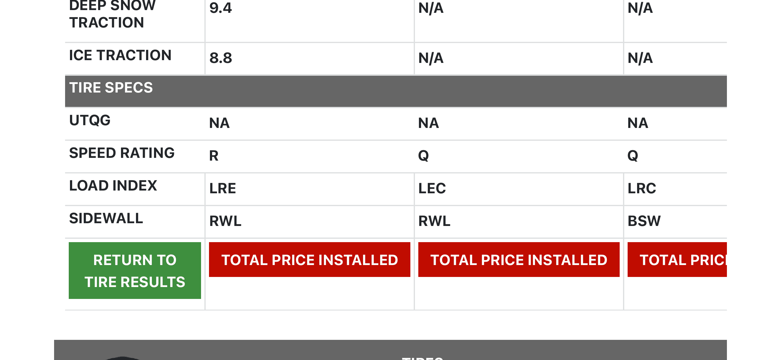

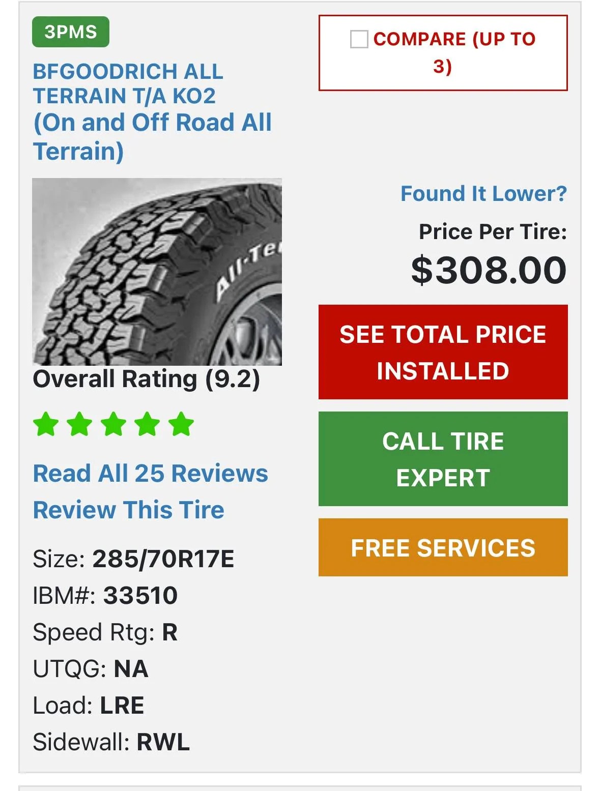

Which 33” KO2 is everyone picking?

That's entirely a personal preference.
Load Range E is going to be much stiffer on road, Load Range C is going to be much more comfortable on road.
Off road C will give more sidewall flex vs the E rated tires.
R vs Q speed rating is only like 7mph difference, so it doesn't really matter.
Honestly I'd just stick with the Load Range C's regardless. As far as if you'd like the white lettering that's all on you.

Thanks! I’ll take your advice and go with C. I am getting the white lettering. I wish that had been an option in 2018.
